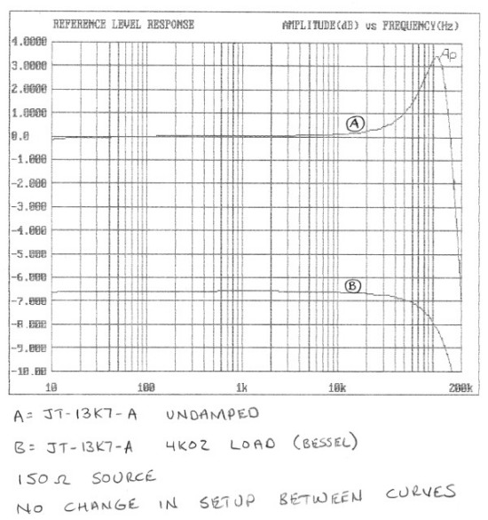

Well, they're a transient so they do have high frequency components just as any transient. But the risetime is finite. For example, the charge coming off your finger during an ESD event is going through roughly the equivalent of 100pF in series with 1.5k ohms. So while there will be high frequency content simply due to its transient nature (even a single cycle of a sinewave has frequency content above the period of the sine) but the bulk of the energy isn't going to be up in the RF range. Though I suppose if you electrostatically charge an isolated metallic object and discharge it you could really yank up the risetime.
Yes. With the distinction that the node between the two capacitances (the shield) is tied to ground which significantly reduces capacitive coupling. That's how Faraday shielding works.
To some degree, sure. But we're talking about just four parts here. You'd almost have to try to get the shield lead much longer than an inch or so.
Yet all that it did was reset the CMOS logic. You've been talking about blowing up power MOSFETs.
And I'm not going to say it would be absolutely impossible to blow the MOSFET with a nasty electrostatic discharge. But I seem to be in fairly good company in feeling that it's not the huge risk that you've been making it out to be.
Again, look at the Son of Zen. The only thing between the MOSFET gates and the inputs is a 221 ohm resistor so they're not even afforded the isolation that a transformer would.
And I'm not saying your concern is wholly unwarranted. I'd just like to know why you've singled me out.
The lumped elements are just fine for the normal operating frequencies as well as at the resonant frequency of the system. Again, distributed element analysis doesn't come into play until the wavelengths involved are on the order of the size of the system. And there's simply not going to be any RF interference in the system of any magnitude sufficient to go blowing holes in the MOSFETs.
The unloaded resonant frequency of the 13K7-A is 120kHz. Add the gate capacitance and it gets lower still.
Remember, your original concern had nothing to do with ESD but rather the simple resonance of the transformer causing overshoot sufficient to blow the MOSFET.
ESD's a different matter because you're dealing with thousands of volts.
How is simply having several 10s of volts at the gate of the MOSFET any sort of inherent problem in a source follower? I can see it being a problem with a common source circuit. But this isn't a common source circuit.
Perhaps with the pulse transformers that you seem to be familiar with. But an audio transformer isn't a pulse transformer. Again, the unloaded resonant frequency of the 13K7-A is 120kHz. Adding the input capacitance of the MOSFET will only make it lower.
Except that the resonant frequency here isn't at those frequencies.
Here are the bare facts. Actual measurement of the 13K7-A unloaded. The MOSFET input capacitance will effectively be in parallel with the 13K7-A's secondary. Please explain to me how that additional capacitance will increase the resonant frequency.

Fred Dieckmann said:ESD events are very fast RF waveforms...
there is capacitive coupling between the primary winding and electrostatic shield and capacitive coupling between the same shield and the secondary winding. This looks like two capacitors in series.
The electrostatic shield will also be connected to the earth ground through an inductive impedance from PCB traces and wiring.
During testing of telecom boards, I had ESD events (which are up to several thousand volts) develop enough ground bounce across a wide 12" long PCB trace connected to an excellent ground plane in the system's back plane, to reset the CMOS logic and fail the regulatory requirements for ESD immunity. We had to use spring clips mounted within an inch of card's front panel and which contacted the aluminum card cage in which the board was inserted. The series inductance for the card cage to earth ground was much lower due to the much larger surface area and multiple paths to earth ground.
I am not going to tell you that I am an expert EMI or RF designer but I read several of the industry standard reference books and received help in this subject from Pete Goudreau who is definitely an expert.
Interwinding capacitance and leakage inductance are distributed impedances. The capacitive coupling between each turn as well as the inductive and resistive properties of the length of wire are a much more complicated circuit than the lumped sum models. You just cannot think of the high frequency parasitics as single element lumped capacitors and inductors.
The coupling does not even have to be that good since you can attenuate the ESD voltage by a couple of orders of magnitude and still have several 10s of volts at the gate of the mosfet.
Rrsonance of gate capacitance and transformer and/or wiring inductance which usually occurs at RF frequencies.
At these frequencies where this simplified model for the transformer falls apart, prediction from a model, seems to be to be a fruitless task.

Hi Fred, I presume that you have been through this before. The situation to me seems that it would be a good idea to protect gate of the mosfet with a zener. This is because an input transformer can resonate at ultrasonic frequencies, and with its extra gain as well, can in theory, punch through the gate. It is just good engineering practice to do so.
Fred, I know that you have stated this every which way, but I think that others reading this thread are getting confused for the 'trees' rather than looking at the 'forest'. Folks, that is all there is to it.
Now, the stopper resistor is another question. I ALWAYS use a stopper resistor with my mosfets, and sometimes even in the base of any bipolar output transistors. This is also just good engineering practice, but for certain RF designs, this stopper resistor could be a problem. There are more exotic alternatives, but a resistor is pretty darn cheap and easy to do.

Nope. I use step-up transformer for step-up transformer and passive voltage gain simply to distinguish it from active voltage gain.
I believe in damping too. Just that I see sufficient damping inherent in the transformer. And if there's sufficient damping inherent in the transformer, why add a resistor?
And I don't think clamps are necessarily a bad idea. Just don't see the absolute necessity that Fred does.
And still don't understand why this circuit is the ONLY one that's been singled out for baggin on about clamping diodes out of all the other circuits posted in this thread which do not include them.
How you going to ruin any drivers? This isn't a design that lends itself to high output power and the output is capacitively coupled.

Hi @all,
I've made some calculations if a shieled transformer prevents the MOSFET of breakdown or not. This is not made for Steve or Fred, just for me and all the others who are interested in.
Let's start with the Jensen transformer 13k7a. I looked into the data sheet and found unfortunately not information about the pimary inductance. Very bad as starting point. Well, refering to the frequency response curve I can find a -3dB point at 0,9Hz when driven from a source impedance of 150 Ohms.
This results in a primary inductance of L = (150 Ohms + 15 Ohms) / (2 * pi * 0.9Hz) = 30H
The primary resistance is 15 Ohms and the capacitance from primary to shield is about 500pF.
When using an ESD-signal of 2kV with 100pF and 1,5k the 100pF and the input capacitor will give a 1:6 divider and a resulting capacitor of about 600pF together.
The primary inductance and the input capacitance will give an LC-resonator wich is ringing at f = 1 / (2 * pi * sqrt(L * C)) = 1,2kHz.
The elements are very similar to a crystal, high inductivity, moderate resistance and low capacitance so heavily ringing is expected. And I'm too lazy to calculate Q.
The input of the transformer is ringing at a voltage of 2kV * 100pF / (100pF + 500pF) = 330V. Transformed to the output there will be an output voltage of N * Vin = 1,6kV.
Of course the tranny saturates and I did not calculated any capacitance from the MOSFET to the LC resonator. And the calulations are not completely correct. But I'm astonished that the MOSFET will destroyed by this test at a quite low frequency at about 1kHz not at RF as I hat expected. And shielding does not help anything.

Do not resuscitate
The secondary winding inductance is in parallel with impedance driving the primary
time the square of the turns ratio. The impedance driving the primary had better be very low for reasons already mentioned
winding capacitance and leakage inductance are distributed impedances and
a lumped element model will not tell you what is going on at RF.
