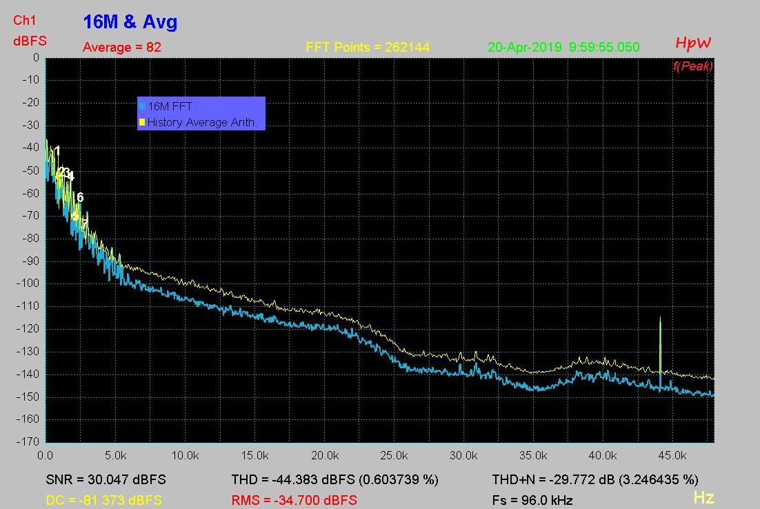

BTW has anyone ever tried a brute force FFT based filter at the length of an entire song. A 3 minute piece at 96K would take a 17,280,000 point transform, a modern PC should be able to handle that at double precision floating point.

BTW: Did a 16M FFT ver. 82 times avg 256k FFT, looks close as equal. IMHO a spectral or TFD (time freq distribution as used to analyze birds) would show much more the real beef.
Picture Note: Lindberg 2L-087_stereo-96kHz_06 source (nice to see some spurious )
