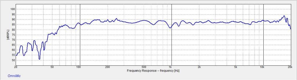

Here's the raw response of my Fusion 8 Alchemy. It is placed on a 25" high stand, and set out from the wall about 3 feet. The mic is 1 meter away, directly on the tweeter axis. There is no gating and smoothing is set to 1/48th octave in the measurement. It is also not set to any specific input level, so the SPL is arbitrary and does not mean anything. I do not see that it is lacking any baffle step compensation.

Well all I can say publishing this graph :
Is doing you a disservice as its clearly impossible from the Eminence
flat baffle measurements, and your graph is entirely sensible, but
is way lower sensitivity across the board, as it has to be.
Your graph never really gets above 90dB, which is right for
a 95dB bass driver with BSC, whilst the above never drops
below 90dB and is clearly wrong for a BSC'd 95dB driver.
There is a clear (and misleading) disparity in the representation
of senstivitity of the order of 5 or 6dB. The graph in this post
is impossible, and according to you, simply very wrong.
You say your input level is arbitrary, that is dodging the issue,
I'm saying the above graph is not possible with 2.83V/1m,
without some splicing shenanigans that would imply that
the treble level is not set for proper BSC correction, or
is spliced to totally misrepresent the actual senstivity.
rgds, sreten.

Wait, let me clarify - In the raw graph I posted above the SPL means nothing, it's just a number. It has nothing to do with the sensitivity.
The graph posted at DIYsoundgroup is calibrated to 2.83V at 1 Meter, just as it says. It is not lacking in BSC and it does have 93 dB sensitivity. I even measured it with my Continuums and the Alchemy averages 10 - 11 dB higher than the Continuum. Its calibrated sensitivity places it at 83 dB, just as I would expect it to be. Another way to look at it - the Alchemy's compression driver is rated at 106 dB sensitivity. My crossover is padding it down about 13 dB. It all matches up.
I'm sorry that you feel that my response is impossible, but from my perspective it is clearly not and is real.
Well it seems there is no real point taking this further :
http://www.eminence.com/pdf/Beta_8A.pdf
Half space the Beta 8 is about 94dB up to 1KHz.
Domestically I can't see that translating to a 93dB
speaker with BSC, about 90dB would be my guess.
Something doesn't match up, and still doesn't.
The graph shows 94dB 100 to 200Hz, no BSC.
rgds, sreten.

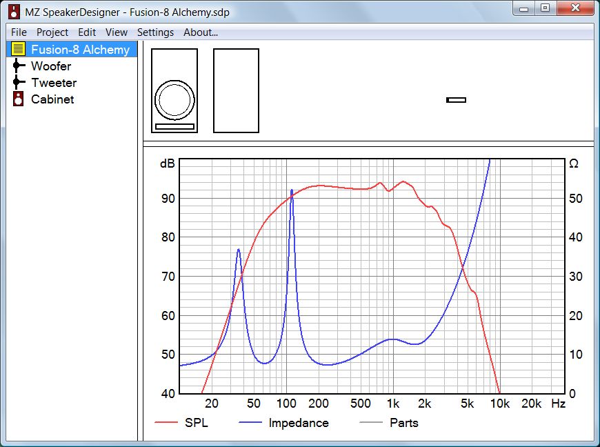

From my view the Eminence Beta-8A indeed reaches a sensitivity of 92-93 dB in the Fusion-8 cabinet. That's quite surprising for a driver with 94 dB in infinite baffle.
However, the response below 200 Hz actually is falling and the speaker really needs a subwoofer. This part of the published response graph is marketing and ignores baffle step.
Attachment: Simulation with a sample crossover.

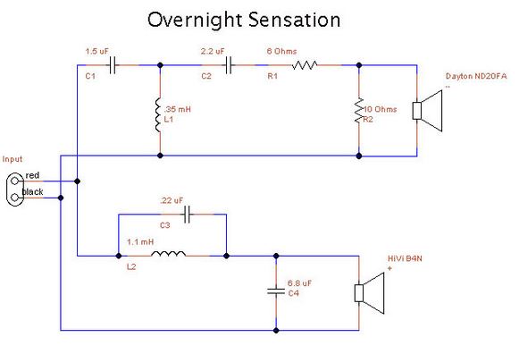

To get back on-topic, there is an aspect of Paul Carmody's Overnight Sensation that makes me uneasy. I think he did it for cost and simplicity, but IMO the 0.22uF tank on the bass coil should have a series resistor around 22R to avoid being overly deep.
Trouble with overly deep notches, which here is to reduce metal cone breakup, is they push up the range above the notch frequency. You're also going to mess up the good phase and energy storage correction that a correctly designed notch can bring.
