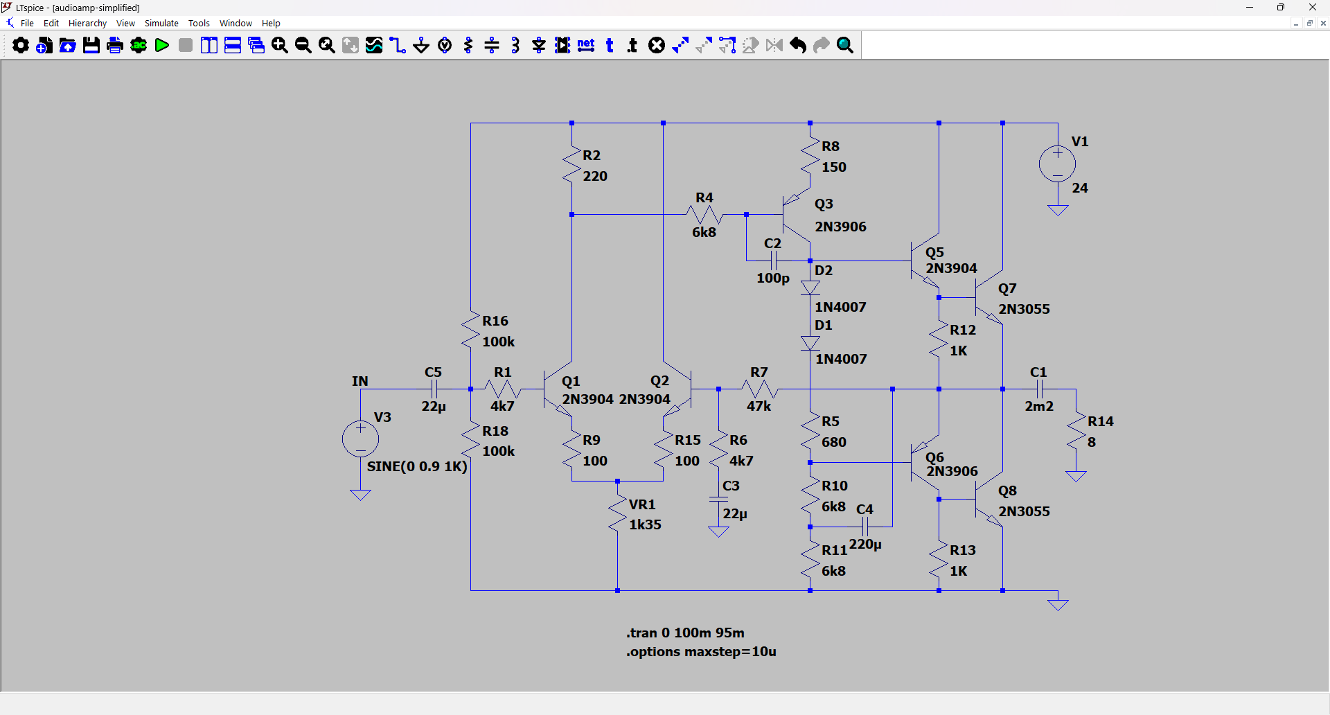

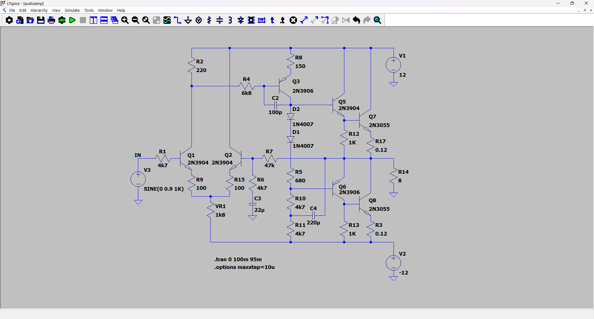

maybe add an weird bootstrap circuit or an led constant current source on the input?Cool, we are getting there. Least we have a Quasi output with the diode so its gonna be friendly.
Of course add the 2N3055 for outputs. Since gain and current and what is needed to drive them is
gonna be completely different than shown.
See we are at 14 volts now. VR1 is not constant current but sets the current regardless.
So variation of 12 to 14 volts is going change everything of course.
Using glass type diodes crossed my mind too so 4148 switching diodes be fine.
You can get bias with 2 diodes, but bias will jump like mad once you get it set with right resistor value.
Adjustment will be smoother and easier with 3 diodes.
Better to use 3 diode drops. 68 ohms wont bias the outputs now with 2 diodes.
likely in real life R4 needs to be adjustable. But the model helps you understand
a starting point.
Few issues, were learning. You lowered VR1 so current is going to go up.
Luckily using 3904/06 so they are very easy to drive. Q3 is easy load.
So we never ever need high current for Q1 /Q2.
In fact for stability which we haven't even got to.
Basically simplified, too much current is going to cause stability issues.
Were actually hoping to get to 1ma but 2ma was a tradeoff.
But you raised the current up by changing VR1 to almost 3ma
In order to get T1/ T2 to have equal current for no DC offset.
Were stuck with the limits of R2 and standard resistor values.
You raised it to 1K makes sense, trying to stick to 10% standard values.
But it needed to go down in value, since current was raised up
Anyways, stick to 2ma current for VR1 or were just shooting our own foots.
In fact we can even try to get down to 1ma even. Which will help with stability.
Q3 is easy to drive.

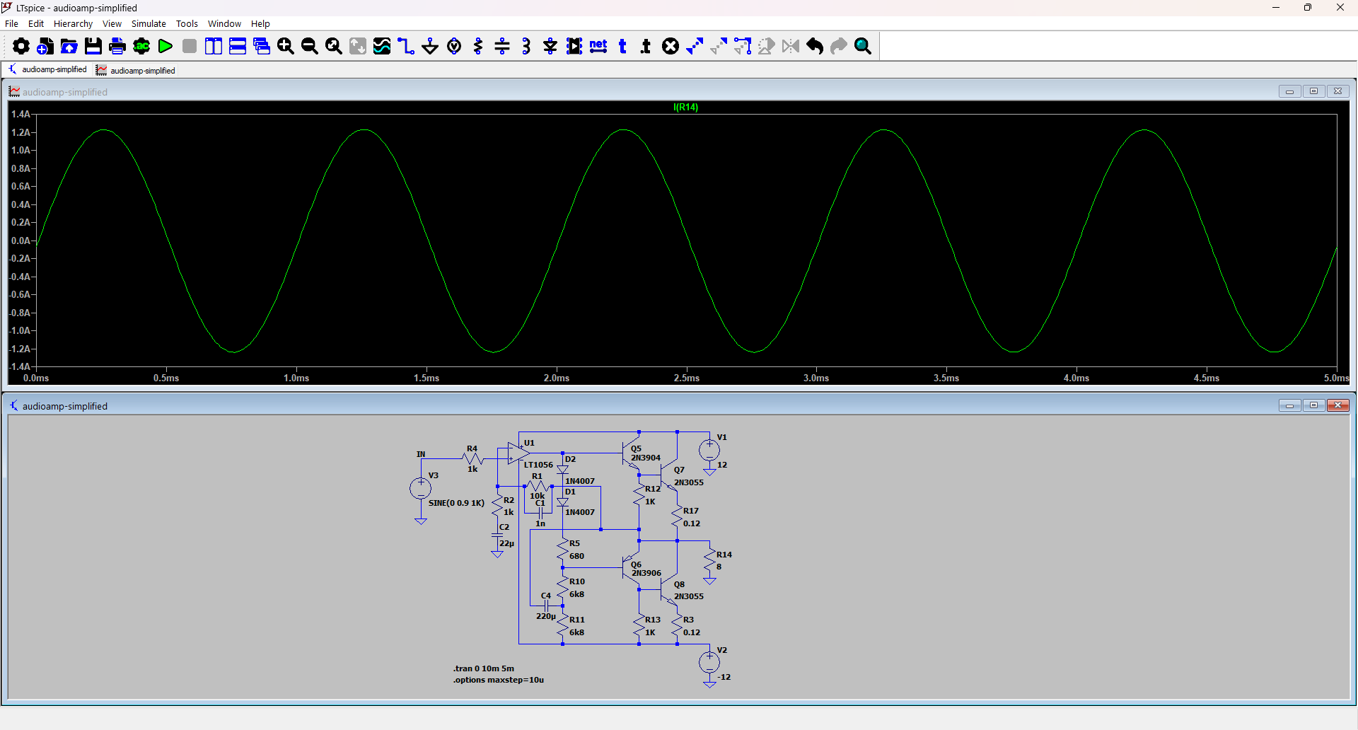

Show you screen shot of new circuit. Kinda went backwards
T1 and T2 not balanced. I'll give you a hint.
You will never ever get it without 5% or 1% resistors
R2 is going to make it happen no way around it.
You can vary R6 in your model or R8 in mine. or the load its driving to help a little.
But its limited to resistor values as well. I made sure to match my resistor numbers
to original model. Cant keep renumbering everything.
Indeed, although simplified it would hold current constant.
Under operation with linear power supply the rails will vary in voltage.
So yes definitely, DC offset wont dance around on the output.
As noticed a set resistor vary like crazy. Great idea.
Also second gain stage current was cranked up 9ma
Only needs to be 6ma. So the bootstrap with cap resistor values can go up.
Higher value resistors are more desirable to maintain current and raise impedance.
Actually since we are at low voltage, 12 to 15v feedback current source be ideal.
With simple Zener we could potentially loose to much voltage.
You can check, bring amp up to clipping.
And determine the max voltage swing of the differential.
led could work or similar voltage zener.
You loose the voltage swing to the zener or led.
Its fine why its common for differential.
For second gain stage we want full swing to rails.
So bootstrap and feedback types more common for that.
Bootstrap will swing pretty good, feedback types only loose .6 to .7 volts
basically the common drop of silicon at temp

Assuming wanting something simple with no extra transistors.
Just zener with 2 resistors. Show you in a min.
Can also add another transistor and zener.
Which yields far far better impedance.

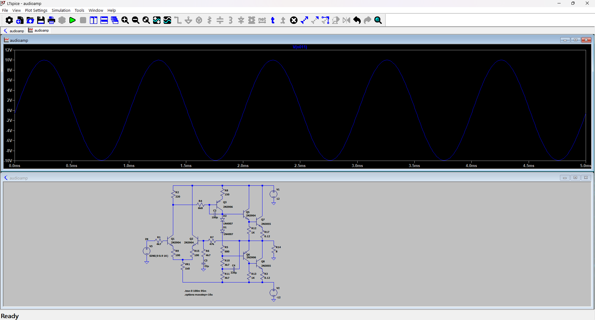

Was just hoping youd be able to check differential voltage.
To make sure or just basic exercise to see its output swing.
I already know were fine.
Full power before clipping 4ohm
differential on 100mV scale = VM2. Amp output 5 volt scale = VF1
diff is under 100mV or 200mV peak to peak
At absurd amounts of clipping 500mV scale
still under 800mV or 1.6 volts peak to peak.
So more than fine with 6 or 9 even 12 volt
zener. Not worry about limiting the voltage swing.
Or losing rail voltage of the differential with the zener
Simplified 9 volt zener be fine, with transistor usually
3 to 6 volt is fine. No worry with 14 volt rails or 28 pp

Getting there. Were just trying to get a basic amplifier with differential
without excessive DC offset on output.
Least we established the whole heart of the amplifier the differential.
Needs to be balanced, and the current must be constant, even with
rail voltage that varies in operation.
The amplifier is simplified. Distortion will be typical.
Once you try to improve that. Simplified designs no longer
remain simple. After I show him a simple current source for the Diff.
I can show Fourier for expected distortion.
Yes we will check open loop/closed loop phase margin / Gain Margin
And determine stability
Im redesigning the amp 4 or 5 times. Wont be doing extra work for open loop test.
Until the design is final.

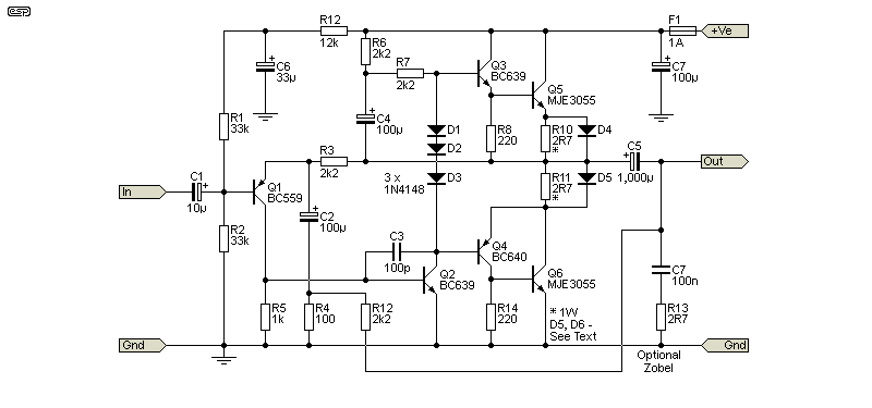

geniuenly intrested if i could copy this current source that uses an led instead of a zener becuse while i have zeners theyre hidden among regular diodes.
That is one way to do it. Somewhat conventional
Usual high parts count, but normal.
Combination of Led Current source for differential, and feedback current source for 2nd gain stage not fully visible
You would have to calculate proper values depending on rail voltage.
Like any other amplifier.
When using approx 1.8 volts LED voltage ref as shown with transistor.
Output impedance is around 300k
When shooting for low distortion amplifiers, and tossing in current mirrors / beta enhancement etc etc
You can raise the voltage ref to 3.3 volts or better 6.8 volts with a zener.
Output impedance goes way up to around 2M
So beneficial for low distortion amplifiers. 2M is about as good as you'll get
and feedback style needed to not reduce voltage swing is about 1M impedance.
We can use led or zener reference current sources for differential.
Since the 1.8 to 6.8 volt rail loss is no concern.
And the 2M impedance gained from 6.8 volts ref is beneficial for lower distortion
Aside from assumption the zener maintains well over wide temperatures
For the simple zener is shown.
The rail is simply regulated by the zener to around 8 volts. And since we obtained constant voltage.
Now a set resistor will have constant current. Simply zener regulation will reduce noise or rail ripple as well.
Could probably lower the current of the zener even more. Half watt not to worried.
Rail voltage can change from 12 to 18 volts or more and current will remain constant at 2mA
Of course the differential has no mirror
So your still at the disposal of R2 value maintaining balance.
Why im still using 1 to 5% value.
Any small jump of 50 to 200 ohms can cause DC offset to climb 20 to 40mV
Suitable for some, garbage to me.
Being aware with quasi combining CFP and E2 stages.
Any DC offset can effect stability and more so even with the dropping diode
in the CFP. DC bias will be unbalanced for the power transistors and again.
Becomes more likely for T8 to conduct more AC current.
I usually accept no more than 3 mV DC offset for any amp.
But important for Quasi.
Regardless 10 to 15mV is about all you get with simplified Lin topology.
Usually worse from 20 to 40mV over temperature ranges and circuit values
And includes the use of 1 to 5% resistors in certain locations.
R9 , R15 degen. And R2
1% ideal for degen, unless made adjustable. Ideal for many reasons.
Dual Supply Rail no output cap.
The voltage is fine.
What do you think it was when there is normally a 4.7k resistor there?
Nothings changed just the current is constant when the rail voltage changes under load
Diff operates under 2 volts regardless
Without Zener and just resistors, its the same
