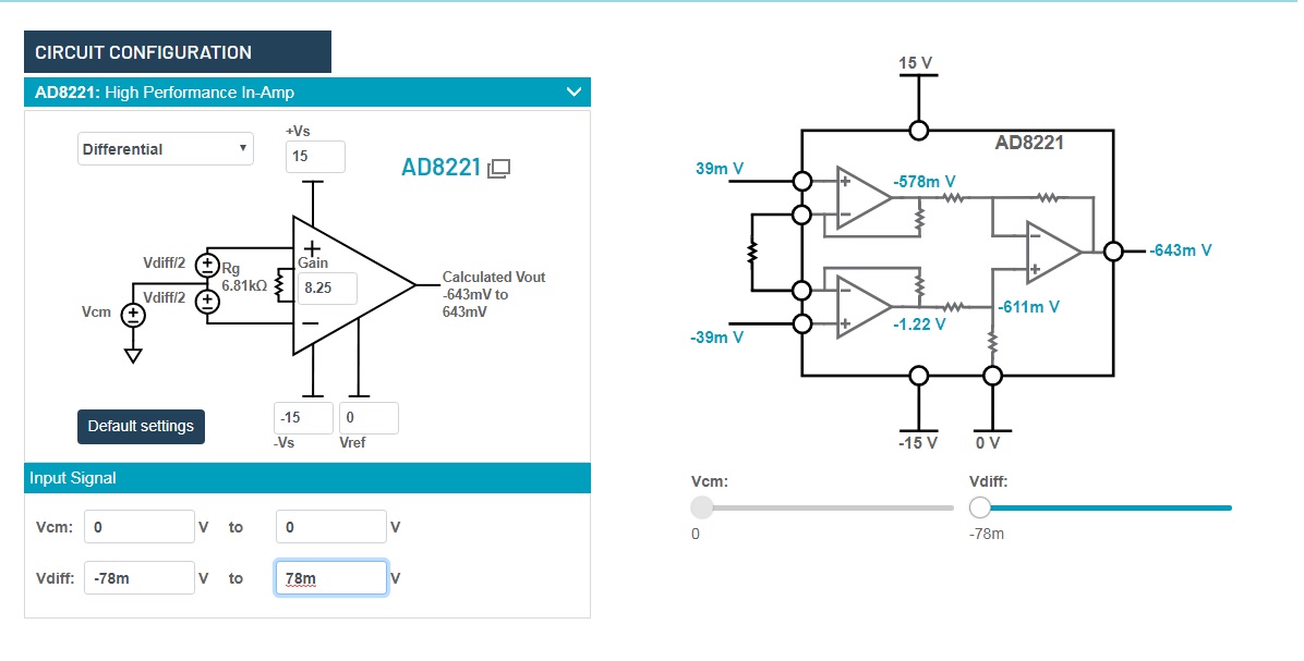

Hi all,
Been busy slowly getting everything build. Cables, CLC filter board for the analog supplies, InAmp boards, ...
Also been busy recalculating the optimal gain for the analog front end, given the following parameters:
Max input level from cart: 0.156mVpp (5.5mV rms @ 1KHz +20dB @ 20KHz)
Desired input level to ADC bord: 1.187928Vpp (-20dBFS)
Desired gain in analog front end: ~7.6X
So I ended up with the attached config. Does that seem right?
Why do you map the expected maximum level from the cartridge to -20 dB? To keep headroom for scratches or inaccuracies in your estimate?
What noise level do you get when you divide the ADC's input noise by the preamp gain?
I can't read the pictures, for some reason I only get a very poor resolution version on my screen.
