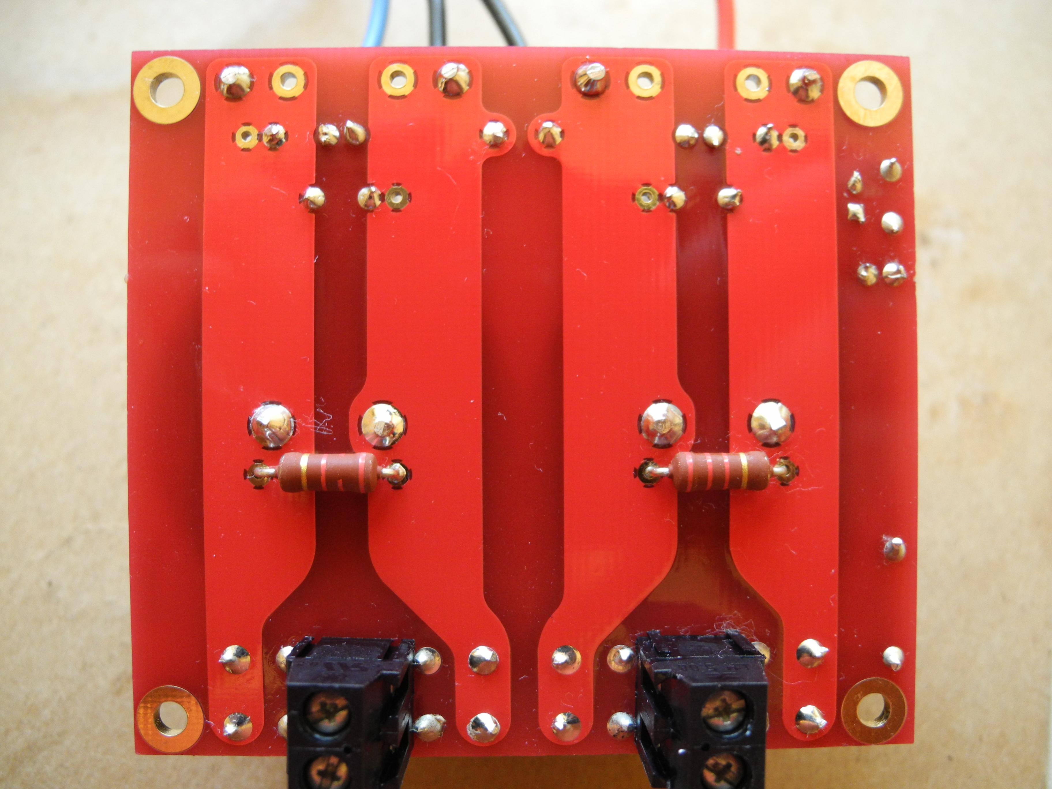

Here are some better pictures of the boards. Let's call the amp boards (acc. to who soldered them) b1, b2 and a1 for now. Let's call the PSU boards ps1 and ps2.
Here are some pics. In order, b1, b2, and ps1. I'll take photos of amp a1 and ps2 tomorrow and submit then as soon as I am able.

Some of the solder joins on the board look like they need a little bit more solder. Other than that, everything looks in place. Double check the polarities on the capacitors to make sure everything is in the correct direction. If none of that seems to be working, then I would point to the transformer connections with those terminal screws. Make sure the screws are good and tight, and that the transformer leads are in order (one winding connected to one set, one connected to the other). If the transformer has more than two secondary coils, make sure that the secondaries are isolated (not soldered to other coils. I had similar symptoms to yours, except if it weren't for me noticing the solder melting on one of the terminals, I would have fried the rest of my power supply! Culprit was a third secondary soldered to my second secondary coil. 🙁 )
Id much rather see the whole test set up. the PCB s/b OK since you built according to the kit. did you use volume control pot with DC block cap?
you used the coax is used improperly. use the center conductor to 'In" and outside shield to'SG'. don't need 2 coax cables for each amp.

Problem1: The inverting input coupling cap has been bypassed (not employed) in those photos. To use it, that resistor next to it hooks up to the second via (the hole that is currently empty).
Problem2: Whatever went into the input, including DC, will be amplified. Also, the input cable needs hooked up correctly.

What a difference a few photo's can make.
Incorrectly installed R3.
Badly soldered pins 1-3-5 LM3886.
Non twisted pairs for input, output and PSU.

OK, the above post may be largely irrelevant in terms of content now, because I took so long to edit it, that the Website timed out, and because I hadn't seen the posts on page 2 before I typed it. Consider this the more relevant post.
Capacitors are definitely installed with polarity correct.
So, according to the Chipamp.com manual (Page 8, section 1.7):
-For using the standard configuration, R3 is installed as shown on the right.
-For using the feedback capacitor, R3 is installed as shown on the left.
I obviously messed up installing R3. I did not notice the subtle difference between the two photos.

You amp is pretty clearly oscillating. It looks like pin 1 is not soldered on the top also and that plate through could be bad. Oscillation very likely caused by what I would consider one horrible grounding scheme.
Suggestion- Remove PG- and use a short piece of solid wire to loop between PG- and CHG. Solder PG- PG+ OG IG wires to this loop.
The way this is now there is no single point ground. Please recall it is the lowest impedance path and not the path or least resistance. Avoid ground planes for analog.
To do more cut about where the green lines are and run wires from the remaining holes between the caps over to the loop also. Isolate those ground current paths. You may have to run a ground to something else on the bottom but, cannot exactly tell by looking at your images. This puts all the high current grounds in one spot defining ground. Low current ground can use the remaining ground plane. The input ground and feedback ground should be very close together.
Sumaudioguy, the ground plane, at the top, is only used for power, output, bypass capacitors and zobel. The input and feedback returns (grounds) are on the underside. the two grounds connect at the output.
