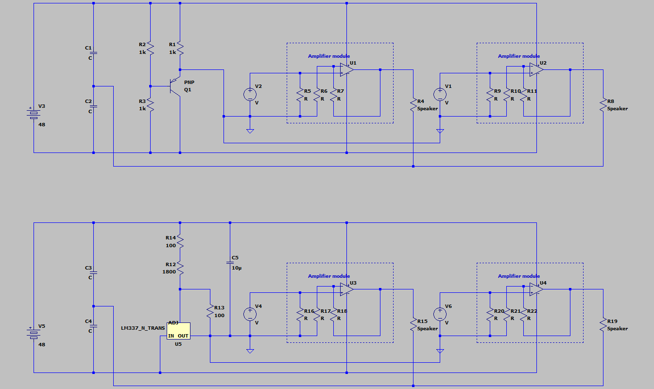

This can work but you need to separate the input and output ground. The input bias must not be exposed to the speaker return ground. Return the speaker ground to a separate pair of capacitors, not connected to the amp ground. But I notice on the data sheet this chip has some mute and standby circuit that returns to ground, which will require some DC ground current. So you will require -24V regulator wrt +48 to hold ground to 0V, assuming that cct draws positive current. That could be a pass transistor, a 7924, a 7912 wired like a LM337, or a LM337.

SteveU: this looks next level. Just to make sure that I understand correctly:
The upper circuit shows the principle of a separate ground but cannot be used due to the standby and mute circuits.
Going this way means that I have to cut the ground track on the TDA board between the input and speaker connections.
The LM337 can only handle 1.5 A but this is ok since it only serves the input signal.
All correct?

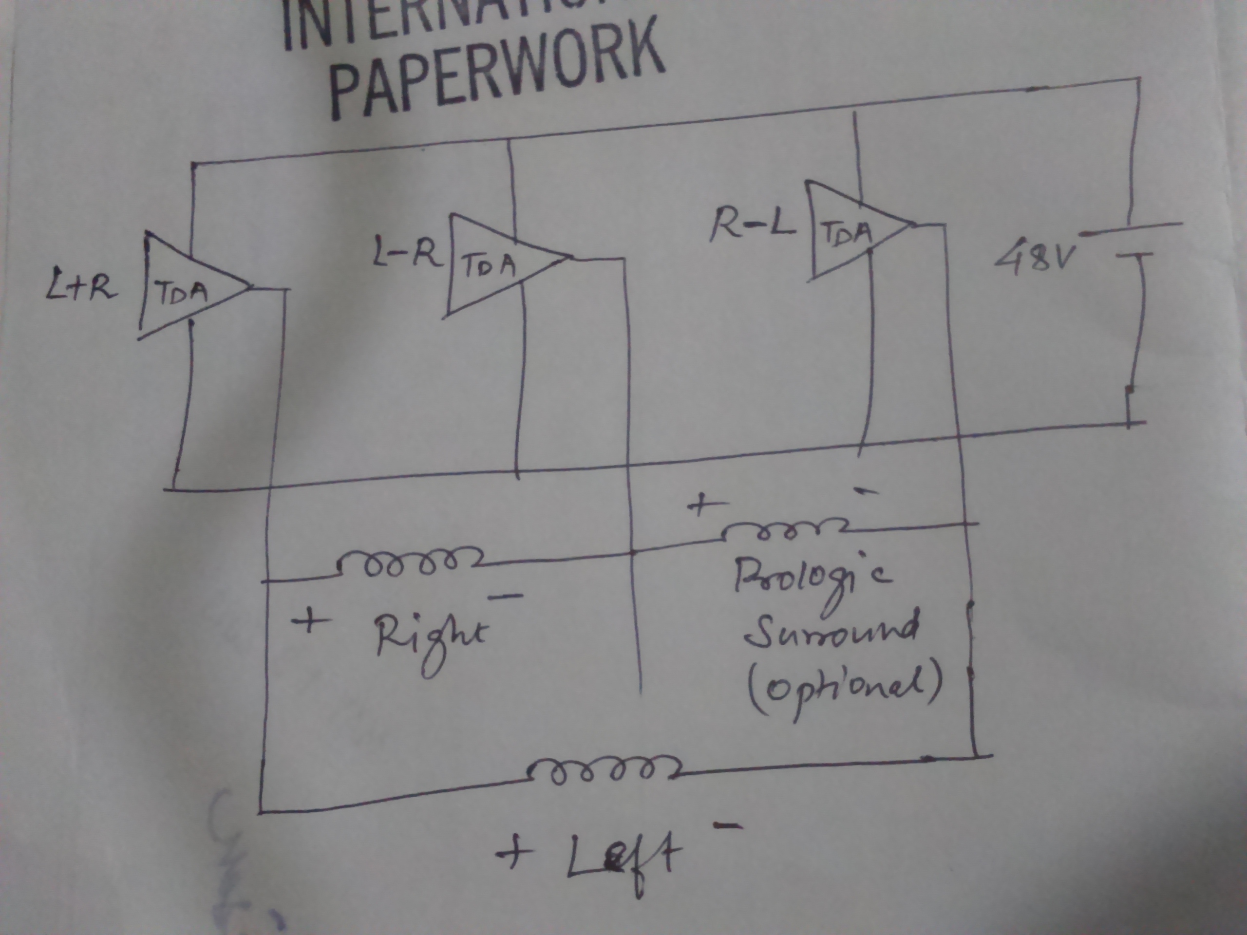

Well, if you're into crazy methods, here's another one for you. Attached picture shows three single-ended amplifiers (like a 3-phase inverter) with three speakers connected between the phases (like a delta-connected 3-phase motor). Only a single supply required, enjoy ! 🙂

Not exactly. The two circuits are roughly equivalent and should provide enough current for the mute and standby circuits, vs just a pair of resistors that probably doesn't.
No you do not make any PCB cuts. Just wire the speaker return (negative) to the external caps (only, not resistors etc.) and leave the module speaker (-) terminal unused. The bias circuit (resistors etc) still connects to the amp ground. This is actually the way an amp should be wired, ie return the speaker to the power supply and not to the amplifier module. This keeps the heavy speaker current off the amplifier module ground.
Simply wiring the speakers this way may be enough to make the resistor circuit work and maybe not, ie possibly no need for the transistor or LM337. The amp will drive the voltage between the caps to something close to 0VDC, but the slight offset will feedback to the input and latch up if it is not separated.

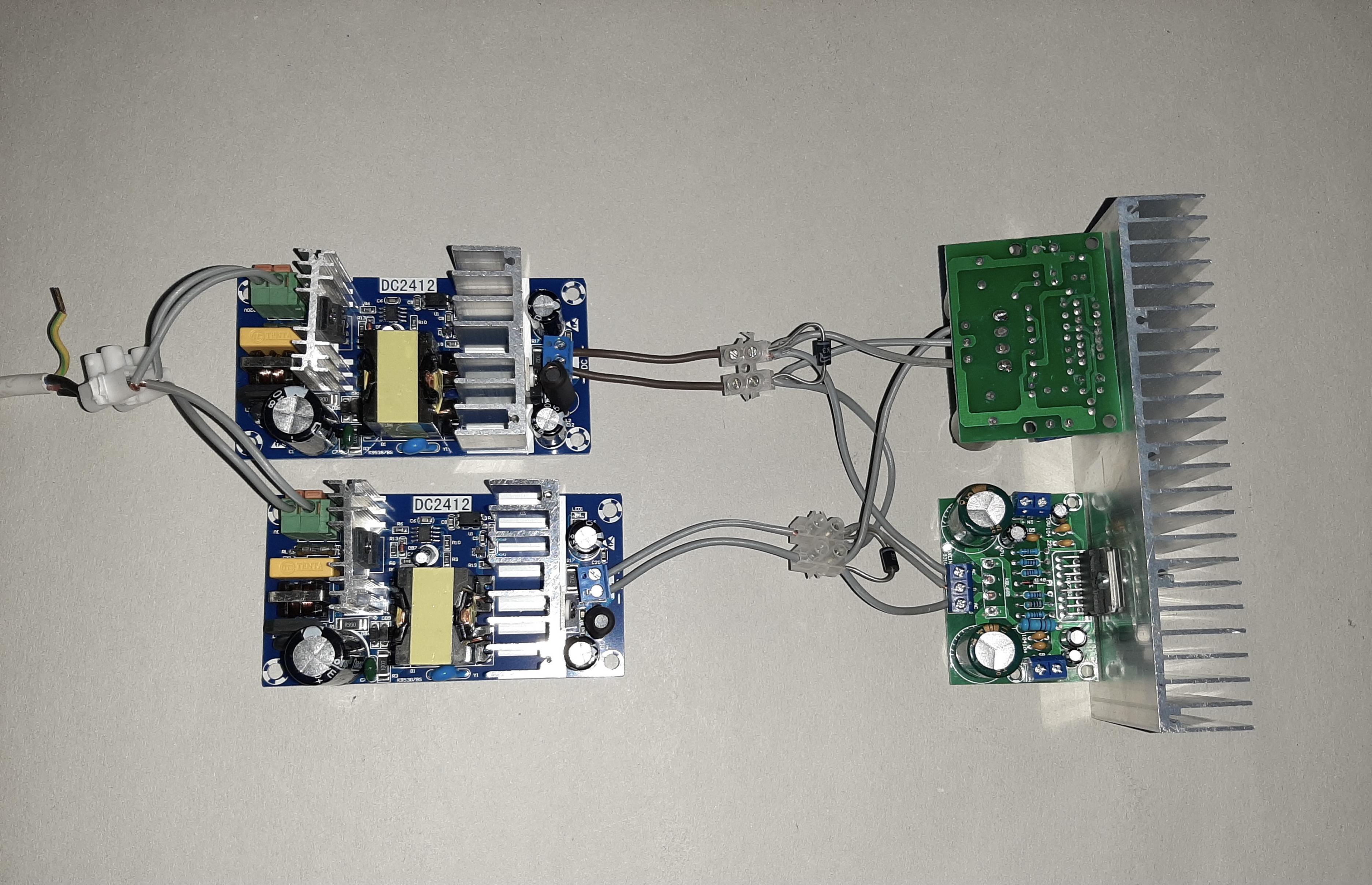

Small update: I choose to go for 2 SMPS’s. No success so far, also these guys their safety switch kicks in 🙁 Seems that something’s wrong with the TDA boards…

What is your TDA filter capacitor? Adding a lot of decoupling capacitance can de-stabilise SMPS' control loops.
If the problem doesn't disappear even when speakers are disconnected, I suggest you have the thread moved to the power supply forum to get better response(s). After all, nothing about your issue is class-D anyway, don't you think?
Try checking for an internal short from V+ to V-/GND/Vout of the ICs. Amplifier ICs sometimes blow if they oscillate at high frequencies (due to a poor control loop etc.) where considerable amounts of shoot-through happen in the output transistors.
It's also possible that someone deceived you with fake ICs in which case, you better check everything well before you discard the boards. You may also put up a question in the chip-amps forum to find out if there's a way out.
Thanks for the tips! With the chip installed, all these resistances are <0.05 Ohm. So I guess the IC’s are gone.
What do you mean with “you better check everything well before you discard the boards”? If I got fake chips then only option is to toss them away, or?
Try changing the ICs, as it's quite possible that the circuit/PCB is correct but the chips that were put in were fake and the seller simply decided to pass that on to the customer (i.e. you).
However, note that the above is based on the assumption that other components (resistors, capacitors etc.) are not fake.
