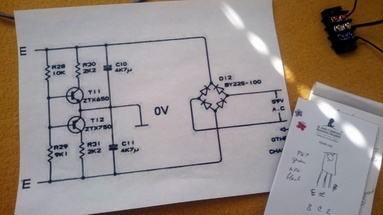

this worked for me for chip amp, to split the power supply into symmetrical
post #9

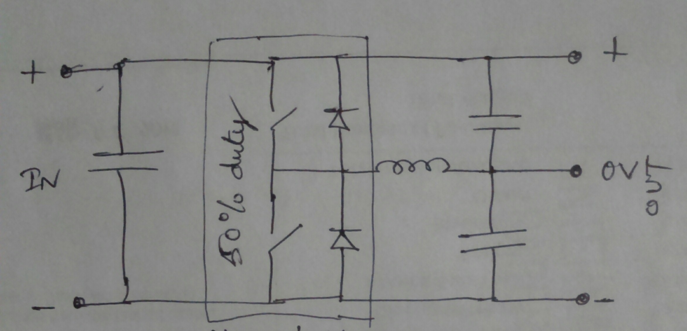

That's buffering the neutral using active electronics, which is definitely an option, but the OP seemed to suggest passive. As long as it's balanced, the current into the mid-point will be zero and the buffer will work, but if somehow unbalanced, will it come back to null point? And how many amperes can that do?
It could be done properly though.

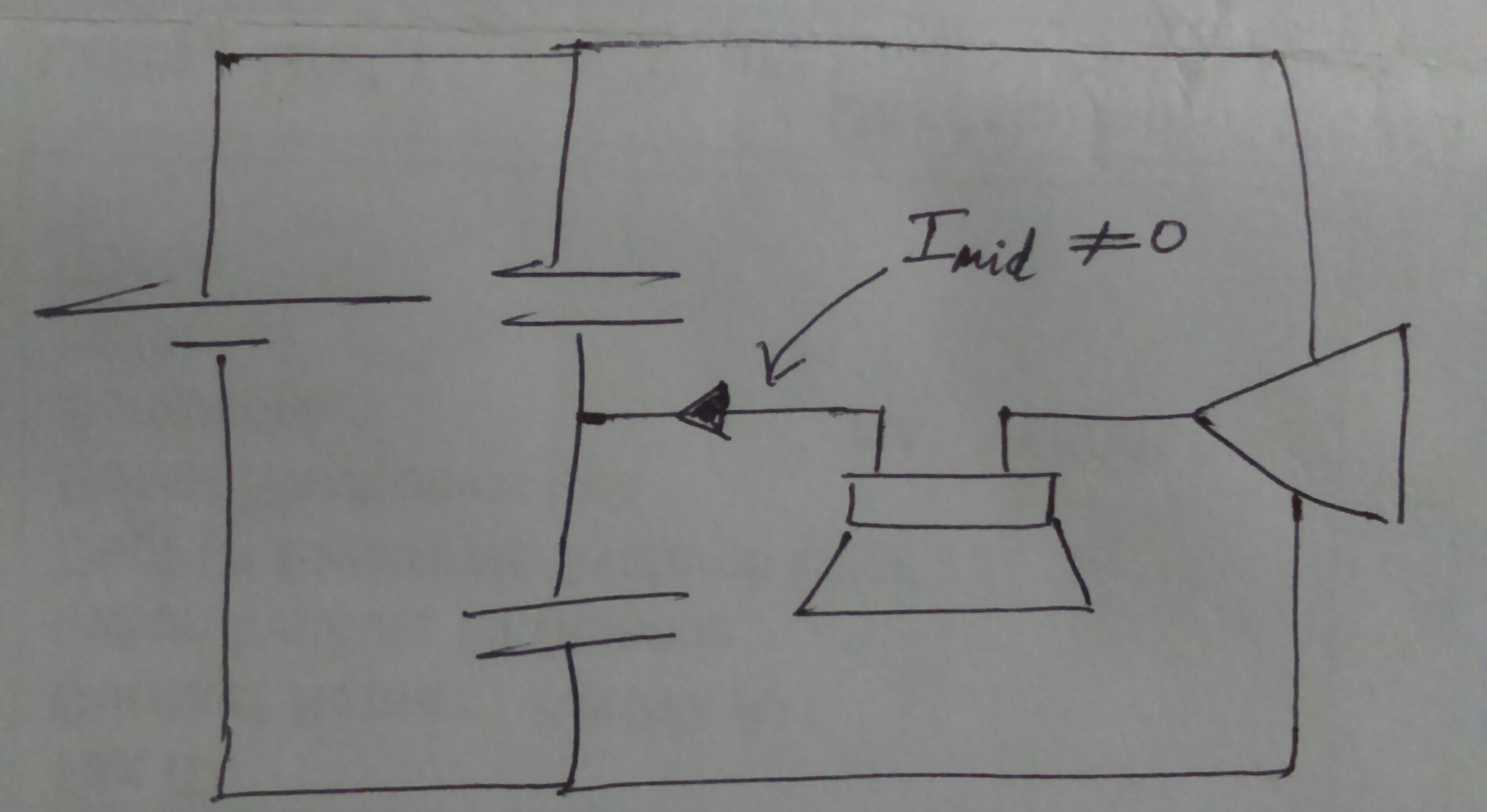

Well, let me rephrase the question for you:
The capacitors get unbalanced by the speaker current flowing into the midpoint (picture). Aren't the emitter followers then supposed to balance them again by conducting appropriately? And since these balancing currents (amperes) are now limited by the collector resistors of the transistors, don't they also limit the balancing performance of the arrangement?
By the way, passive methods are guaranteed to fail (at least in the long run) and some form of active control would be necessary in my opinion.

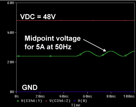

I don't think I said "DC" anywhere, as most people in this forum (including myself) already know (without anyone having to tell them) that the load current is AC.
Capacitor unbalancing is a dynamic/instantaneous thing that occurs as load current flows through the speakers. The picture (attached) shows the imbalance caused in a 2 x 4700uF capacitor neutral by a 5A load current at 50Hz frequency (bass).
Now, Adason, if you still think such imbalances are only due to DC, then I don't think I can convince you otherwise. Also, the fact that you didn't get what I drew does not mean it's utter nonsense, maybe it was truly beyond your reach !
