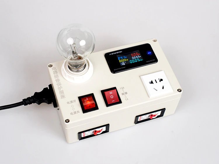

Some (unusally) usefull crap from AliX; https://www.aliexpress.com/item/1005003590590913.html?spm=a2g0o.order_list.0.0.2d971802l5zuIh

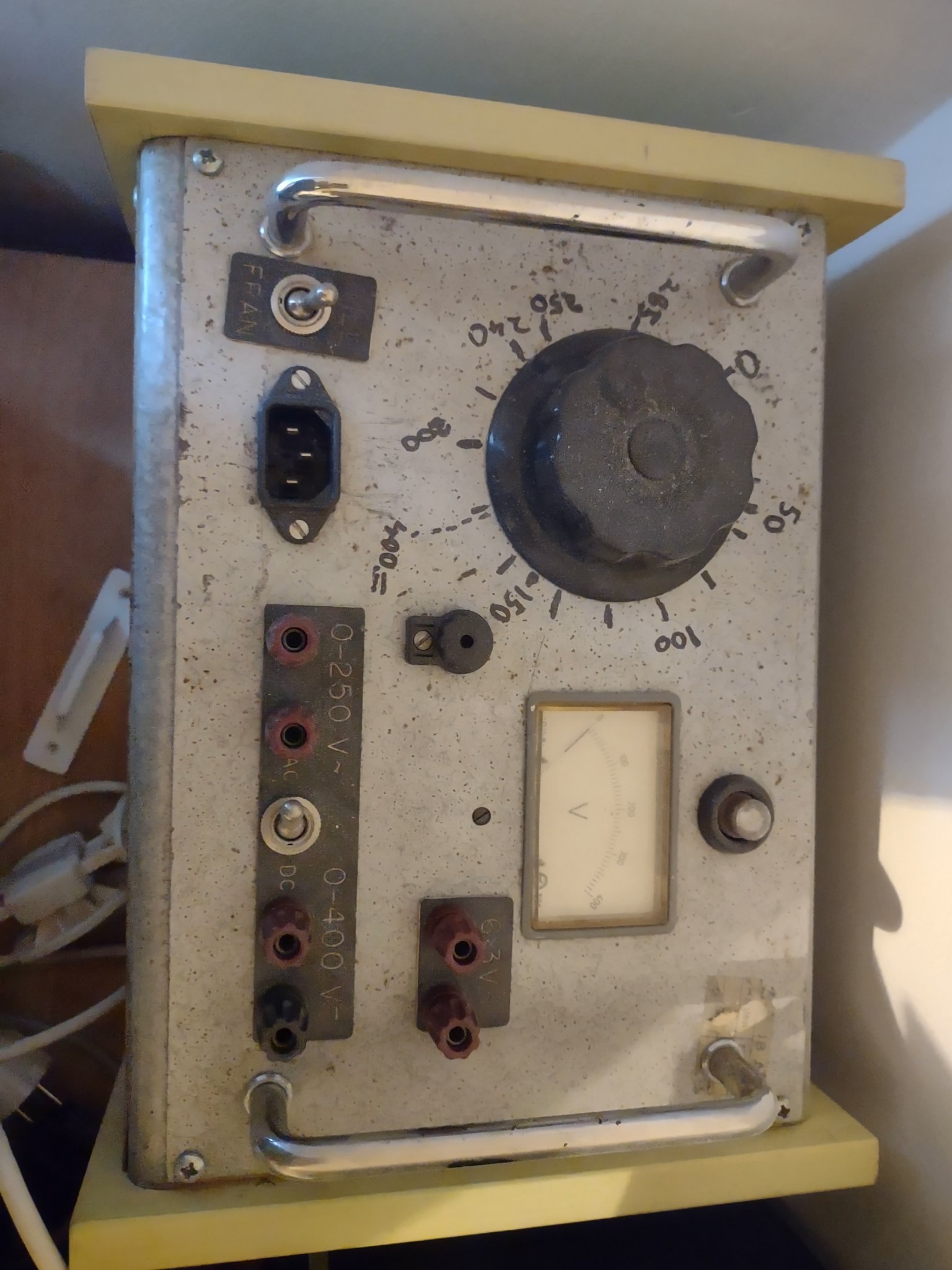

I have this old thing that I think was built in a service shop. It used to be twice as long, with a 30V section, but it was just too big to be useful. The difference with the other suggestions here is that the variac is connected to an isolation transformer, and that output is sent to the device under test. There is also a rudimentary full wave rectifier with CRC smoothing for a 400V DC supply, if needed, and a 6.3v supply.

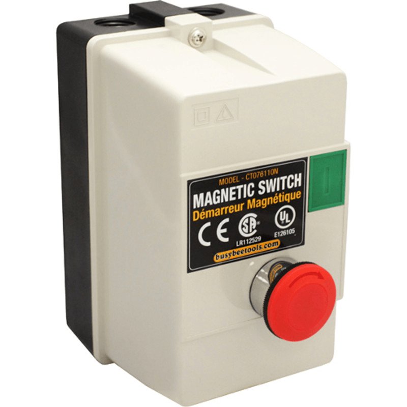

It's absolutely a good idea to equip some stuff with magnetic switches for safety.
Woodworking equipment comes to mind...
All of my tube amps use latching power so they remain off if there's a power failure. The bias supply turns on B+, too. If there's a failure, B+ turns off instead of blowing things up.

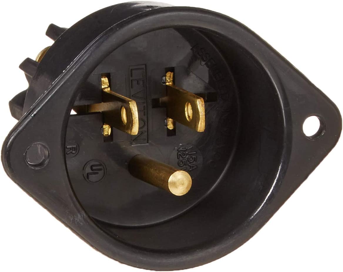

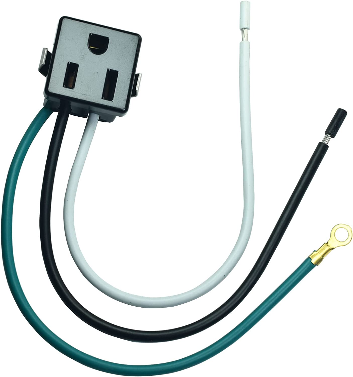

to feed my variac and to get its output connected to this "box" I'd have to use a female outlet for the feed side then a boat/rv inlet for the return side.
feed to variac and return from variac
return from variac:
return from variac:

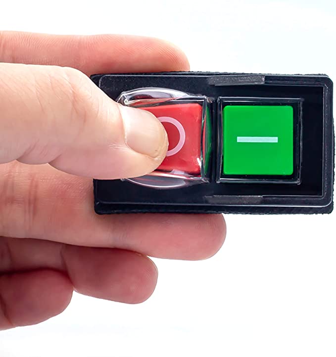

Makes sense Looking for a smaller lockout switch on the box.
This one is only 2 inches long, Ill still have my plunger stop switch, but this switch can be the main power on switch. When power is lost and restored it won't be engaged.
https://www.amazon.com/POWERTEC-713...emergency+stop+magnetic+button,aps,100&sr=8-9
