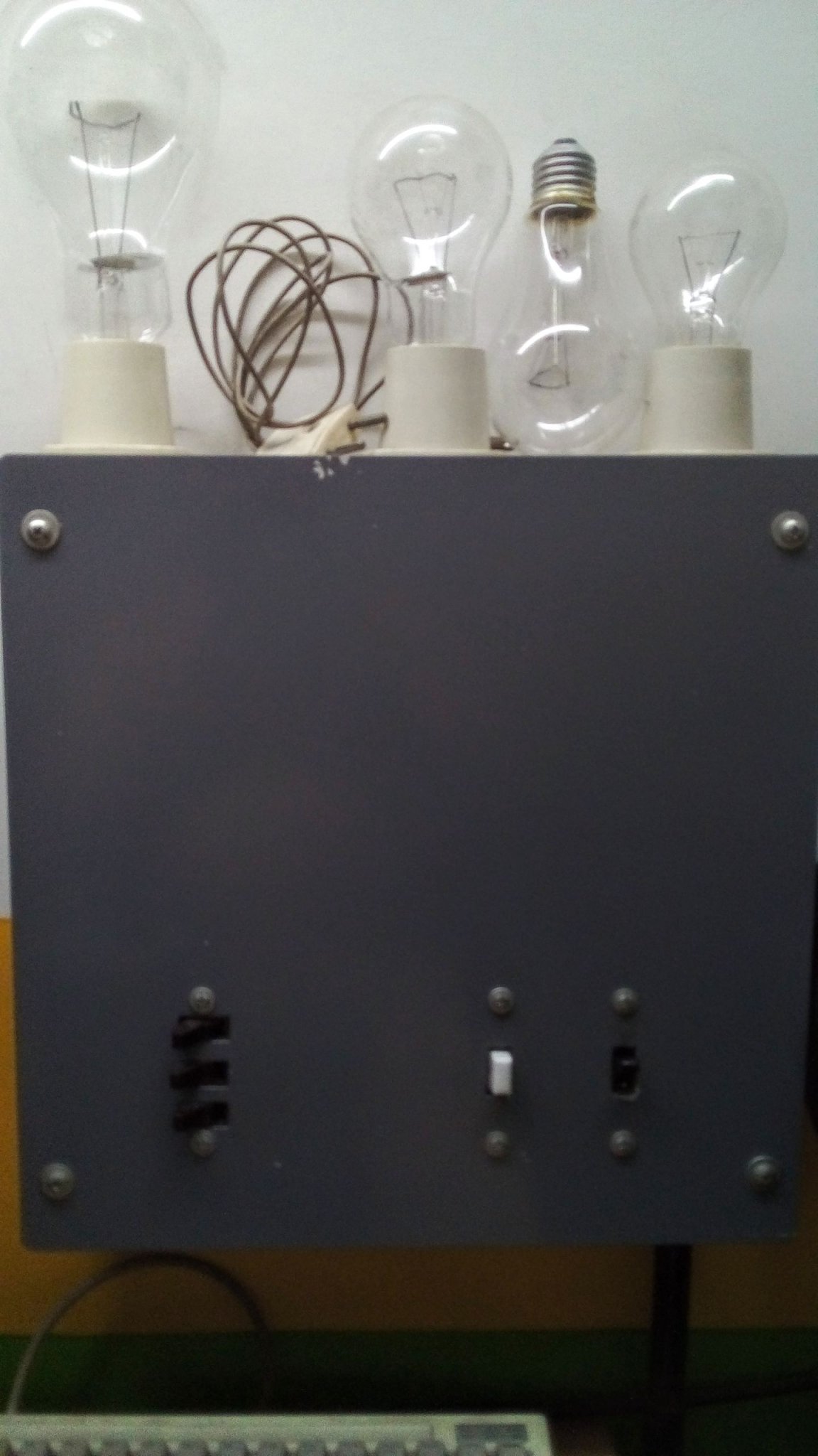

1) a well made inlet with fuse and indicator light to make it compact ? like this
2) high wattage series resistor/s at light bulb to make it multiwattage bulb if how bright the bulb glows as an indication is required ?

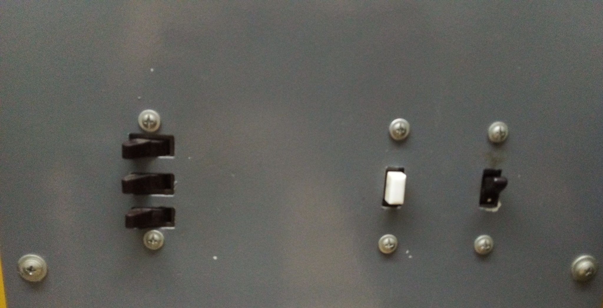

Newby too, but I think a resistor defeats the purpose, adding bulbs in parallel would give you a way to tier the current limit upwards if needed. If your device under test starts to short or go to a lower resistance it's acting like a light switch to turn on the bulb that is in series, making what would be a short or overload, just a harmless turning on of the bulb takes the current instead of the short. My on off will be a magnetic lockout switch, so just a single IEC inlet no fuse or switch there. It will have the fuses on front panel.
One other safety feature must be added and that is GFCI. I found a GFCI you can insert into the power supply cord. Ahead of the IEC inlet. 4 ma of leakage and it will trip.

No. An incandescent (hot filament) lamp is low resistance when cold and higher resistance when hot. If your build is good, the lamp hardly lights at all. If your build is near-short, the lamp will glow near-full-bright, faster than your hand could react, and your house wires are not strained.if how bright the bulb glows as an indication

mmmm these are nice and small and available in many wattages. Properly considering their extra heat when mounting them in the case, these could work out pretty nice as the dim bulbs due to being so compact. Halogens should behave the same as an incandescent when the DUT shorts out.

I drew out what I'd like to build. I only desk-checked it for short circuits in switching, but if anyone spots something wrong or if more safety features could be added, please post. Criticism too.
I chose to not fuse the neutral side as I think that would be a hazard, should a neutral fuse blow first then the hot side fuse wont blow at all, leaving the device with a hot leg that is energized. Someone might touch something thinking the fuse is safely blown when only the neutral fuse is blown, then they touch anything in the room to complete the circuit. Not good.

Duh, while sleeping I realized that I made an embarrassing mistake. The lamps need to be added in parallel not in series in order to vary the amount of current absorbing. I will update it today and repost the correction to post #1. #49 schematic is wrong!

I changed it to G8 halogen very small very rugged.
Using JDD bulbs, you could juse use a socket and change the bulb to suit.
I added ground banana jacks one direct to PE the other lifted with the usual diode bridge circuit. I also added a DC blocker option in the neutral in case any DC is on the home power line.
