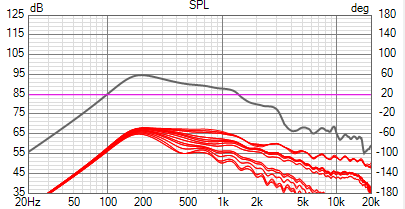

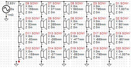

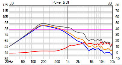

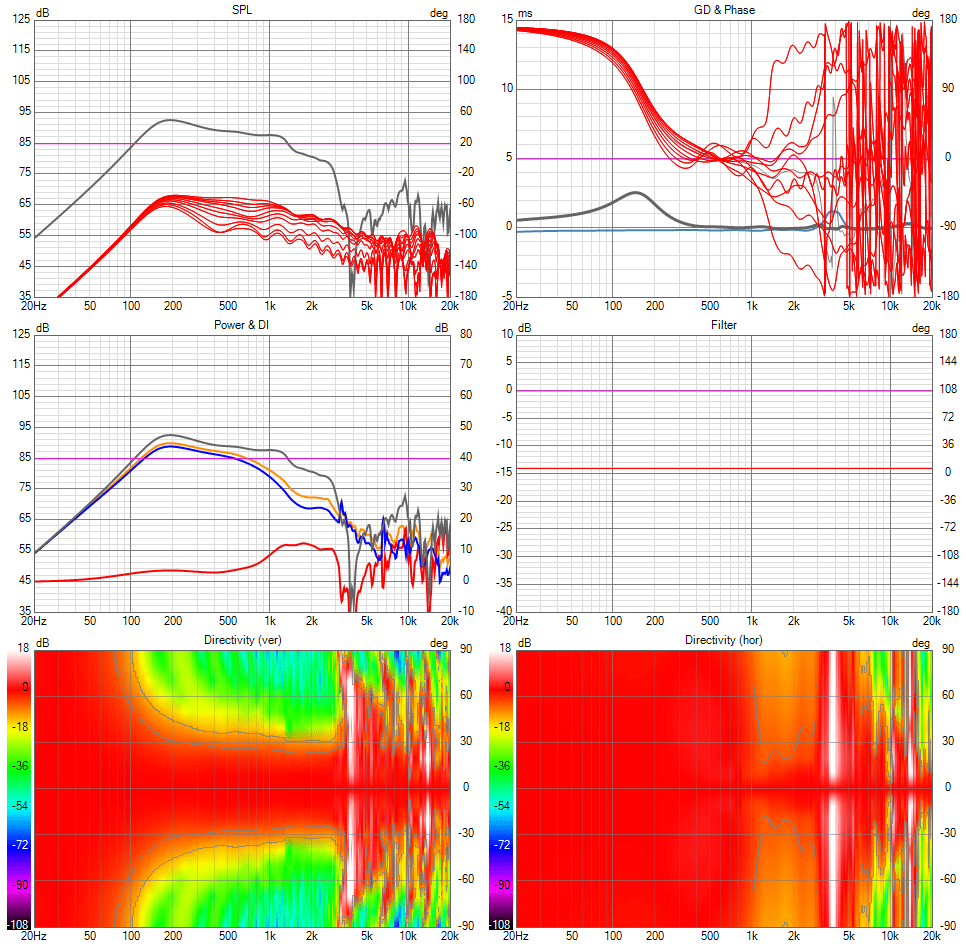

So I have three starting points:
20 aligned verticals:
25 offset verticals
42 aligned horizontals
Based on the simulations, the 4Khz point appears to be a driver limitation. What is the order of priority to choose the best scenario? The red line on the Power & DI chart, the vertical directivity or the horizontal directivity? I don't have all three in the same package.

The ‘best scenario’ is the horizontal arrangement and crossed to a tweeter at 4khz. Without a tweeter, this alignment would be an exercise in confirming what’s already practical line array behavior.

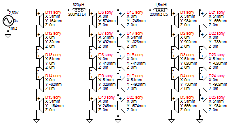

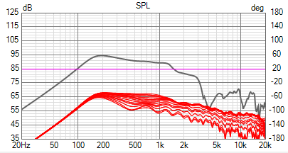

With frequency shading I was able to soften the red line only in the offset model. Just using inductors. I didn't have success with the others.Just wish it was a bit less unbalanced at ~4K and ~11K
View attachment 1328797 View attachment 1328799 no shading with shading

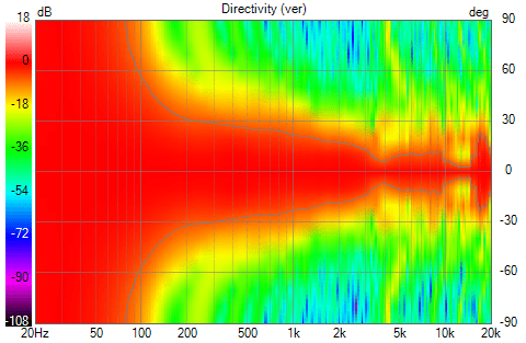

That's quite narrow both horizontally and vertically as far as direct sound goes! Easy to be outside of a good listening position.
The DI shows it's illuminating the room more even though. As long as there are reflective walls etc. (Edit: just noticed the DI numbers are quite high)
Even though the DI looks much
The graph with the filters on would have a very small vertical window of good sound. The DI (red line) shows it's starting to beam from 2.5K upwards (higher DI numbers). So the listening window would be quite small for having good sound. Get out off that window and you'd loose a lot, no good balanced sound anymore.
I didn't like it either. I want a good listening position for at least two people to sit. Vertical narrowing is more acceptable than horizontal narrowing. So, the first model, with the drivers mounted aligned and vertically, looks more interesting, but needs to be improved from 3Khz onwards.

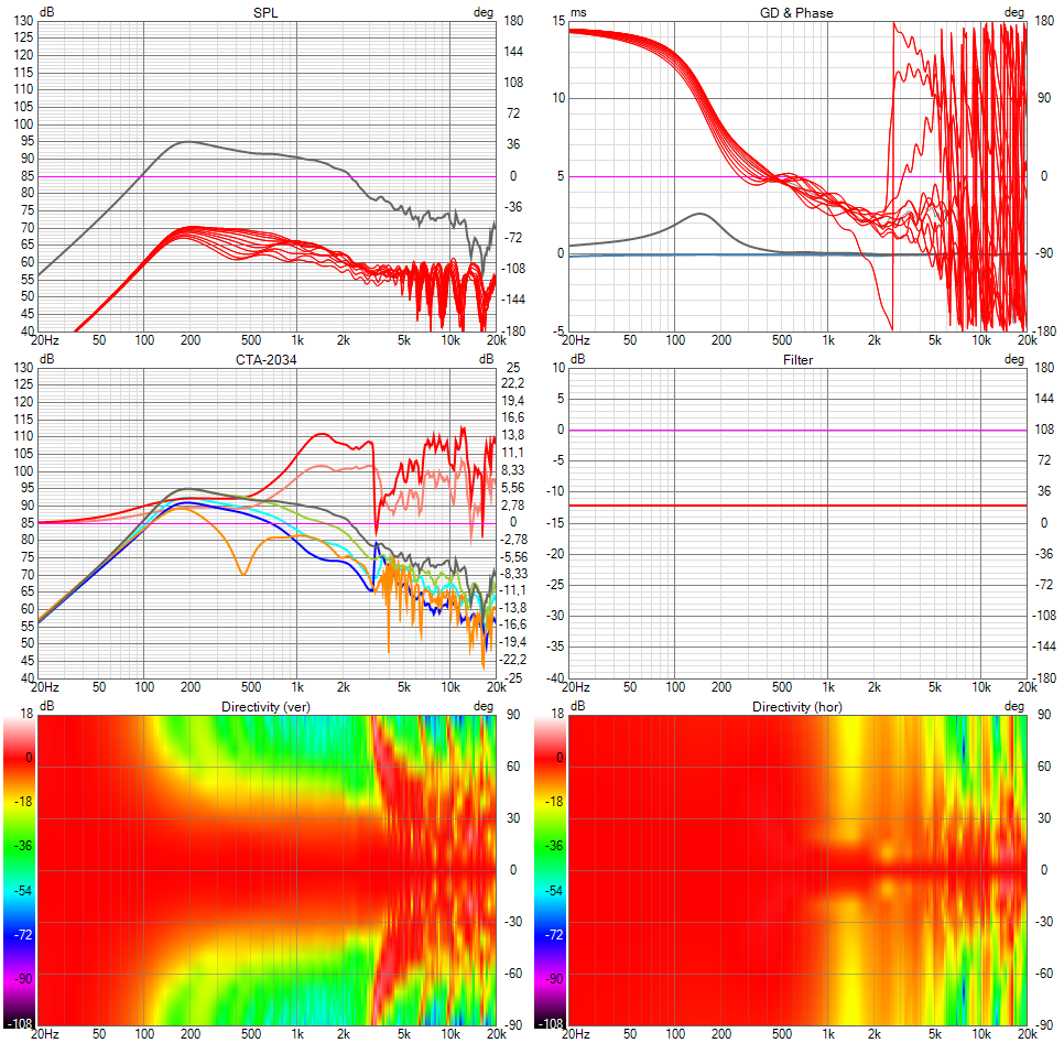

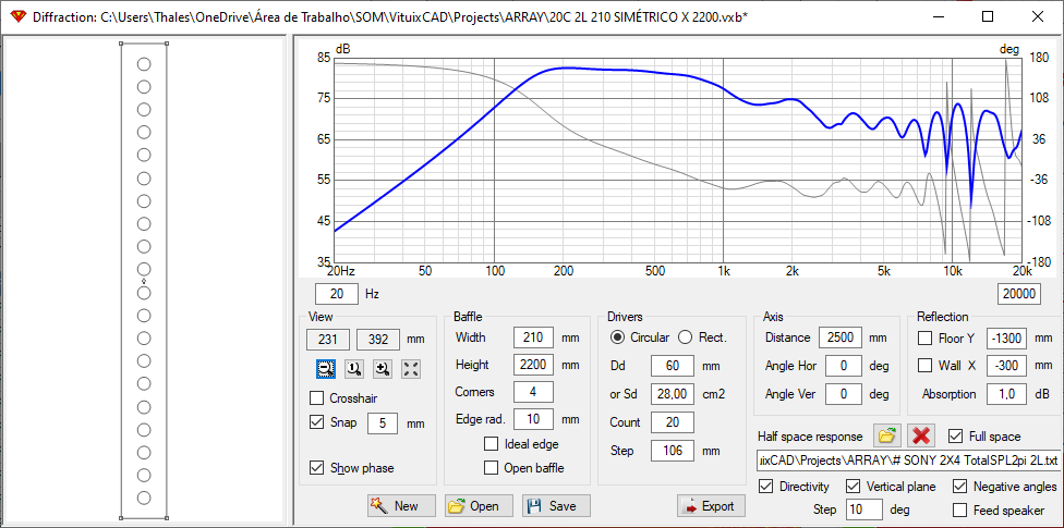

My intention is to point out my error so that no one reads this topic and follows the wrong path I took.

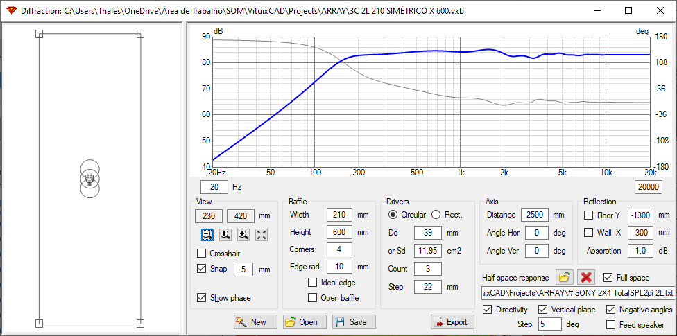

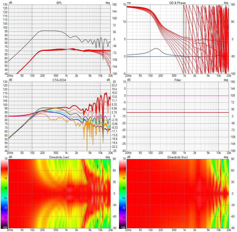

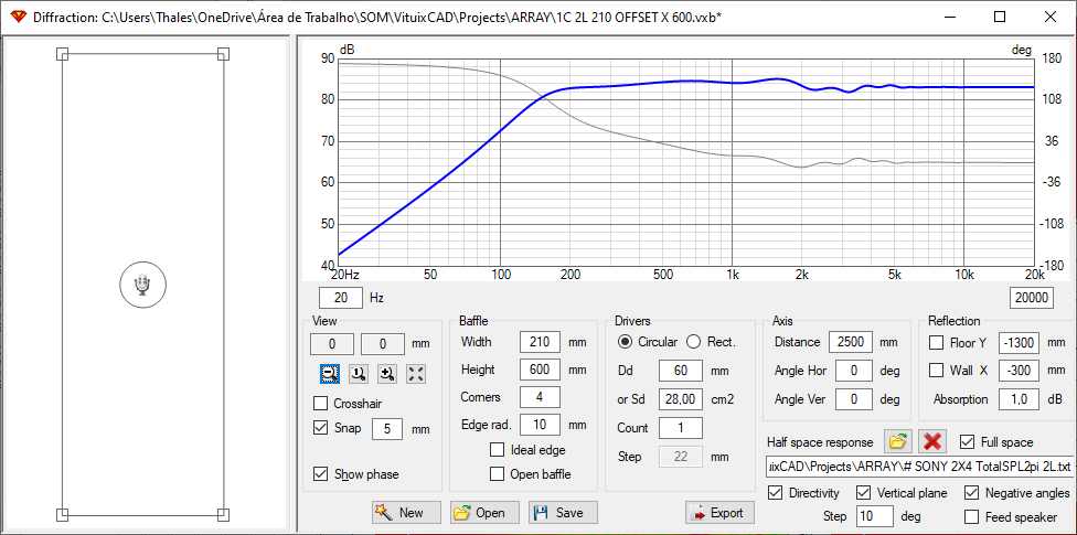

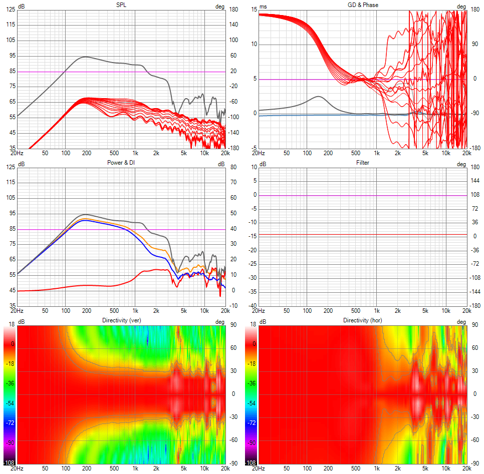

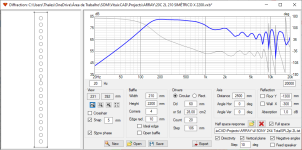

Intrigued by the bad simulations, I left the project for later. Now that I decided to delete the old data and start simulating again, I discovered where I went wrong. As can be seen in the first post, I don't know why, I used 20 drivers in the diffraction tool. Use just one and the program will take care of simulating the different positions defined with the driver's layout tool.
Wrong way ("Kids, don't do this at home!"):
Right way:

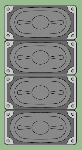

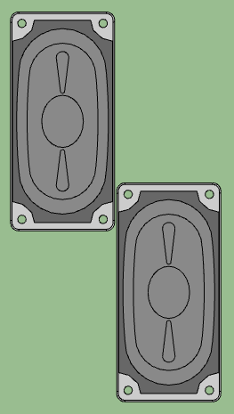

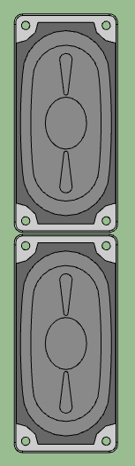

As proposed by kimmostro, because of the different shape of the drivers I have:

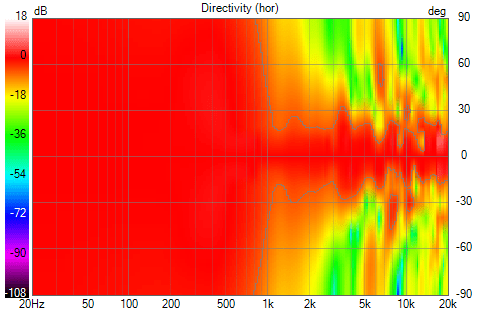

Notably SPL, CTA-2034, GD&PHASE and DIRECTIVITY (HOR) charts are now as expected. It wasn't for lack of warning, but the package provided by nc535 here helps a lot in your first contact with VituixCAD.
I thank everyone for their attention and I apologize for the misunderstanding.
Right way:
