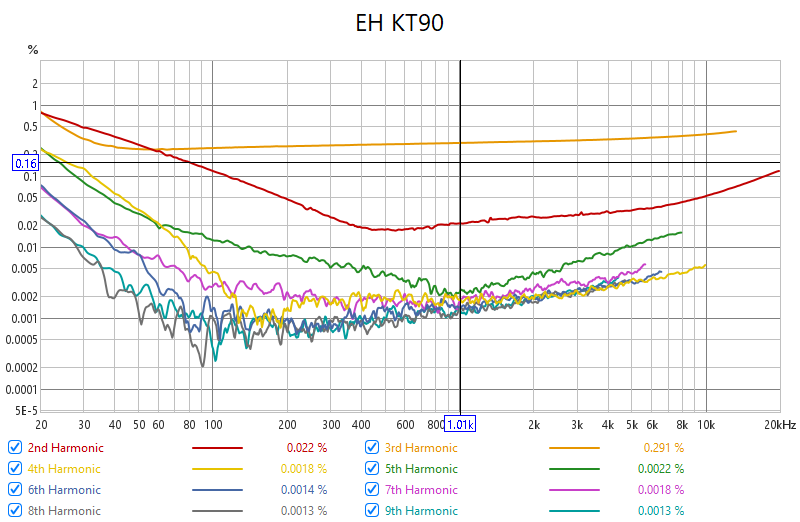

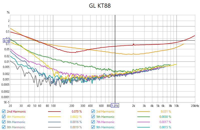

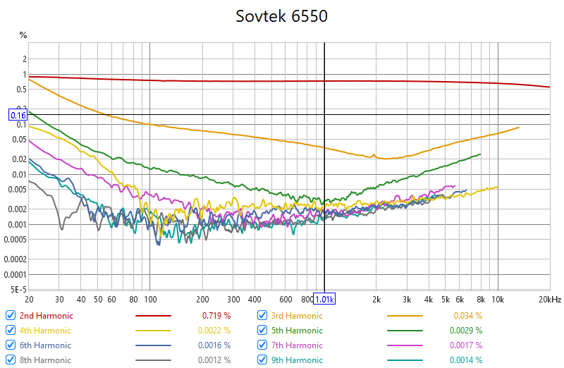

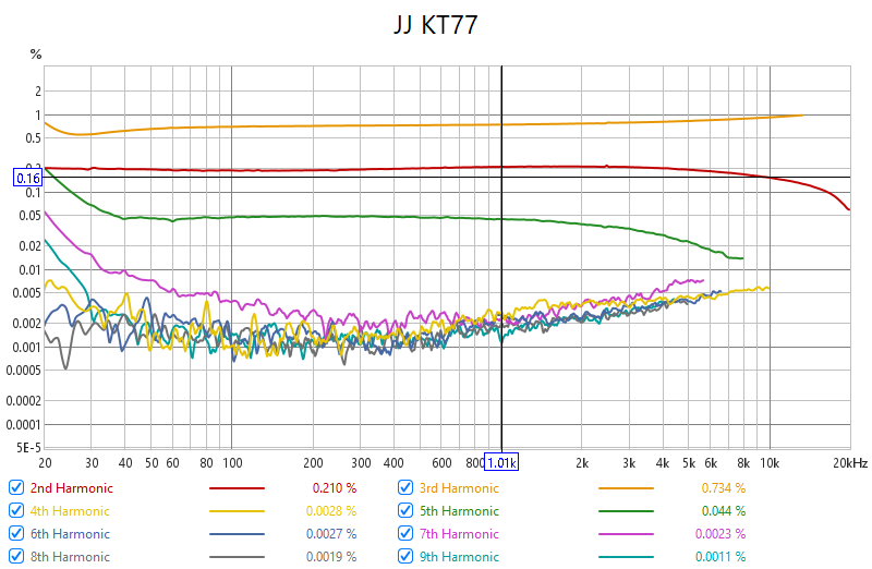

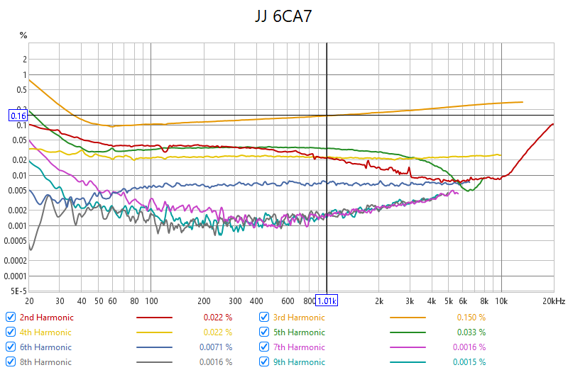

Here are the open loop measurements. Same setup, 5W into 8ohm load. The legend is the % at 1kHz, I added the cursor for clarity.
Idle bias 20W (42.5mA) for the 6CA7 and KT77
Idle bias 25W (55mA) for the 6550, KT88 and KT90
I encourage others to post HD responses of setups (amp/output tubes) that they prefer. It would be interesting to see if there is some correlation between HD response and preference.

The only one which sounded different was the kt77, I was hearing weird stuff, it had a edgy sound , and what it was was THD, it is a very bad tube for audio, I would never understand why using this and not EL34 or 6CAg
