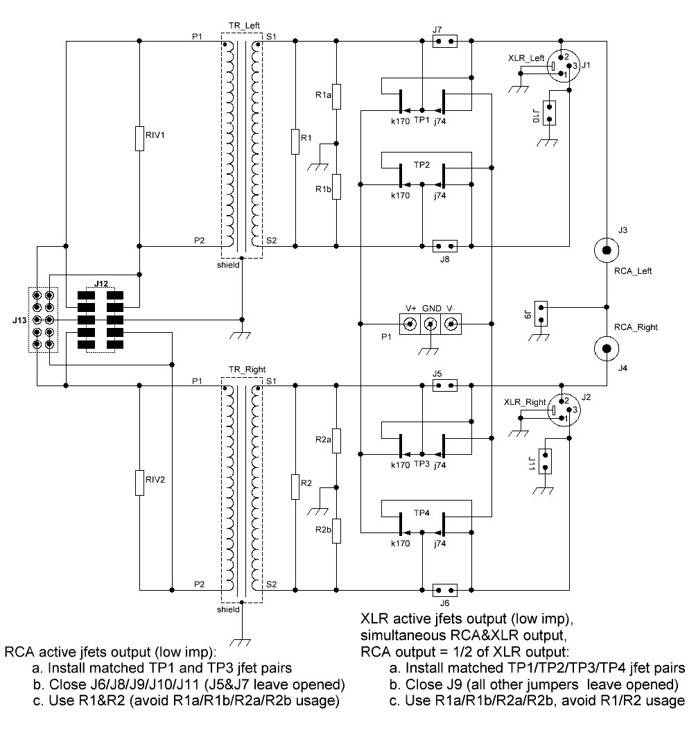

The ES9018 DAC models as 3.05 Vpk in series with 208.5 ohms for one half of the differential output in stereo mode (4 channels in parallel.) This works out to ( 330 ohms / ( 208.5 ohms + 330 ohms) ) * 3.05 Vpk = 1.3 Vrms, which corresponds well with what I measure.
I have the option to use mono mode which parallels all 8 outputs. Doing this halves the DAC series resistance and load resistance for the same output level which would reduce the system output impedance.
My goal is to keep the output level near where it is now (1.3Vrms) while keeping the output impedance at the secondary less than 3kohms.
I would probably be most interested in the larger of your transformers. What are the transformer parameters you recommend for this application? Something similar in specs to the Sowter 1465 would seem to suit my goals and give me a different few options to try, but I would like to hear your views on what suits my needs.
Hi!Thanks for the reply, Ivan!
I don't know a lot about L2 - I've had it for over 20 years and didn't know enough to ask many questions at the time of purchase. Checking back through old emails, the only info I have is that it's upwards of 20H inductance across the full winding, which would be well over 100kohms at 1Khz.
Inductance measurement depends on the measuring signal level at least. 20H at 1kHz is one story, but it is different in most time as manufacturers usually measuring inductance at 100 Hz. At least the regular (permalloy) cores based transformers losts x10 times their inductance from 100Hz to 1kHz (and continue to drop at higher freqs). My transformers has a +/- linear inductance from LF to HF. However, I am not ready to insist on the superiority of any approach in terms of sound quality, just a remark about inductance measurements.
Let me consider that the current output mode (on to the low load impedance) is much better for this DAC than the voltage output mode (high impedances load). The lower impedance will see the DAC, the better SQ you can achieve from DAC chip itself. It is not a theory, it was proved by me myself on 9018S chip based DACs and by my customers. The lower the impedance seen by DAC, the better the result.Yikes! The resistors soldered in place are R1 / R2 are 330 ohms. How I read the colour bands as 80 ohms, I don't know but this explains why I couldn't get predicted and actual measurements to agree.
The ES9018S DAC chip in mono mode (all the 8 channels are in parallel) gives you 8*3.9mApp=8*1.4mArms=11mArms of the signal.
If you want to get 1.3Vrms below the 3kOhms, then I suggesting to use:
1. Large transformers with TR (Turns Ratio) of 1:16 (15.75 in real).
2. 16R resistor across the primary, 4kOhm resistor across the secondary. 4kOhm reflects to the primary as ~16R.
Calculations:
16R||16R*0.011mArms*16TR=>
8R*0.011mArms*16TR=1.4Vrms
Output impedance is: 16R*(TR*TR)||4k=16R*248||4k=4k||4k=2k
So you will get the output of ~1.4Vrms an 2k output impedance. DAC will see ~8R of the load.

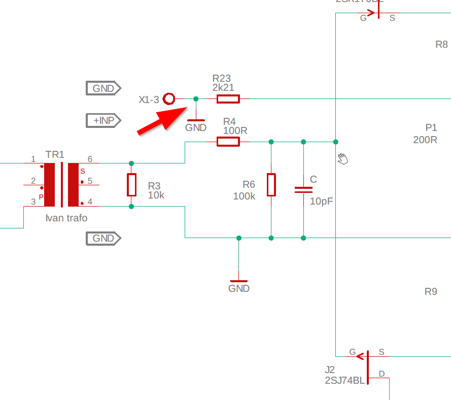

Hello Ivan,
today I made some tests with your Trafos and the output of my CS4398.
To describe the situation I have done a fast sketch in EAGLE. I did not find the right symbol for the trafo, but it does not matter if the Pins are right now.
My idea was to have a common differential filter between PIN 24 and 23 of the DAC as I have in my CD player . After this filter I connect the trafo.
The output of the trafo is connected to the INP+ and GND of the Buffer stage a La Borberly. Since I have done a preamp with that PCB and I had still a pair I wanted to make a trial for DAC in developing phase. I use them as a buffer stage.
Well I have measured with the oscilloscope the output voltage Vrms and compared to the output of the CD player.
Configuration 1
Trafo connected to TP3 and TP4 and on the secondary a 10k resistor. Result: Vrms is some decibel lower than standard , the sound is thinner and bass are not there.
Configuration 2
Trafo connected to TP3 and TP4 and on the secondary a 3.3k resistor. Result: Vrms is at least the half of the nominal , the sound is thinner and bass are not there.
Configuration 3
Trafo connected to TP3 and TP4 and on the secondary NO resistor. Result: Vrms is at maximum and at least the sound is more full.
There is always a lack of low frequencies compared to the cd Player ( I have almost changed everything there. There is a discrete op amp now, but the 2nd order filter is always in use).
Configuration 4
Trafo connected direct to TP1 and TP2 . No differential filter before the primary.
Finally the sound is there. Same volume in Vrms like in the CD player. Bass are there. With the filter the sound is thinner... It is strage because this filter is present in the CD player before the Op amp stage.
Has someone of you some ideas what I can still try?
At the end it seems I do not need any filter. Of course there is some filtering ion the input of the buffer stage.
Thanks to all.

Hello Michele,
Thank you for your experiments and for detailed description of options you tried.
Well... Transformer itself has LPF function as its bandwidth is limited by construction and internal losses at UHF compared to OPamp.
Don't you tried to remove R4, R6 and 10pF as well, in addition to excluding of R1, R2, C1?

Could I use the Ian Canada Bisesik I/V board as a preamp output transformer? What voltage should it be operated within?
I'd like to use it similar to Jensen Iso-Max.
Trafos are just trafos, they simply converts impedances. Sure you can use it as a preamp, as ISO-Max from Jensen.Could I use the Ian Canada Bisesik I/V board as a preamp output transformer? What voltage should it be operated within?
But trafos are different in terms of their purposes. For example the mentioned by you Iso-Max solutiuon is a wide line with different transformers inside box in terms of their impedances, turns ratio and compatibility with different sources and receivers.

Hello Ivan , I had forgotten to connect R23 to Ground... that is way maybe the sound was "thin"...now the floor shakes with the bass....My neighbors are really happy with it ;-)Hello Michele,
It is strange that the output stage was delivering anyway a Gain of 1...
I did not try again all the possibilities.
Just tried with and without differential filter with R1 R2 and C1 at the primary. I did not noticed any deterioration or macro changes in the sound.
