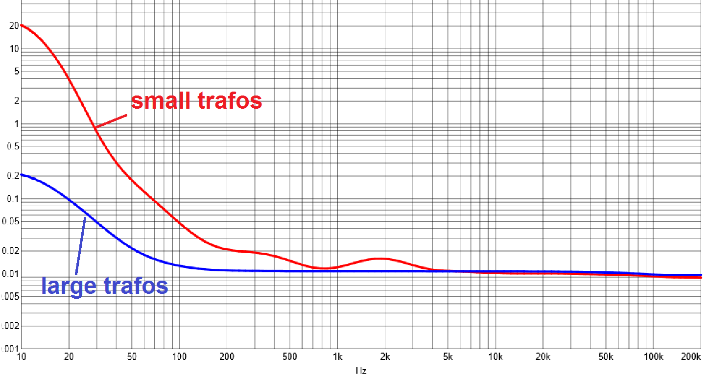

Is it also technically possible to explain why the sound quality is better by means of a larger output transformer?
Or in other words, what are the technical differences between the large and the small transformer that can explain the sound improvement.
I know the importance of technical approach, but still... I do not want to build the superiority theory based on measurements as for me music and sound is an art more, than boring measurements.
However... Below pic can't explain all the things but quite revealing explanation at least:
THD plots for both transfomers versions within the same conditions:

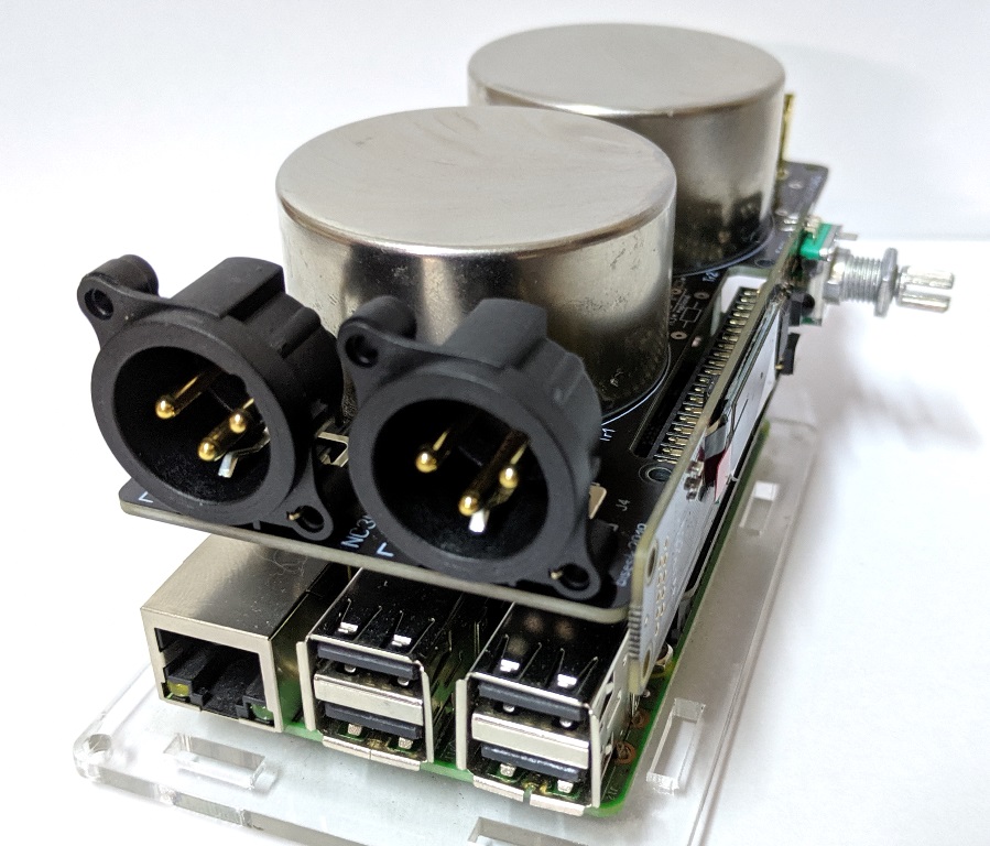

Here are some impressions from iancanada IanCanada's Latest RPi GB Goodies Impressions... and your tweaks, mods and hints...
And here is the page from Andrea Ciuffoli: DSC Output transformers test

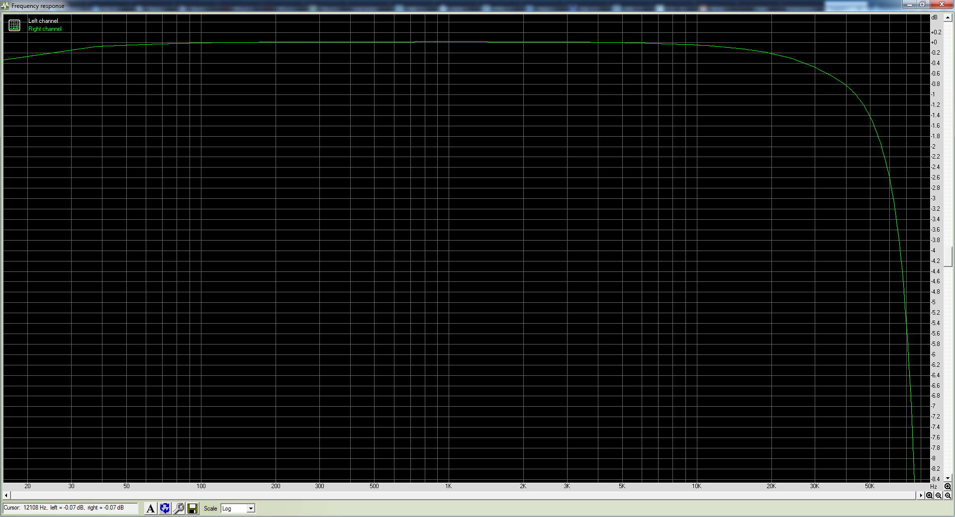

Dimensions: OD=47mm, H=24mm, thickness=0.3мм

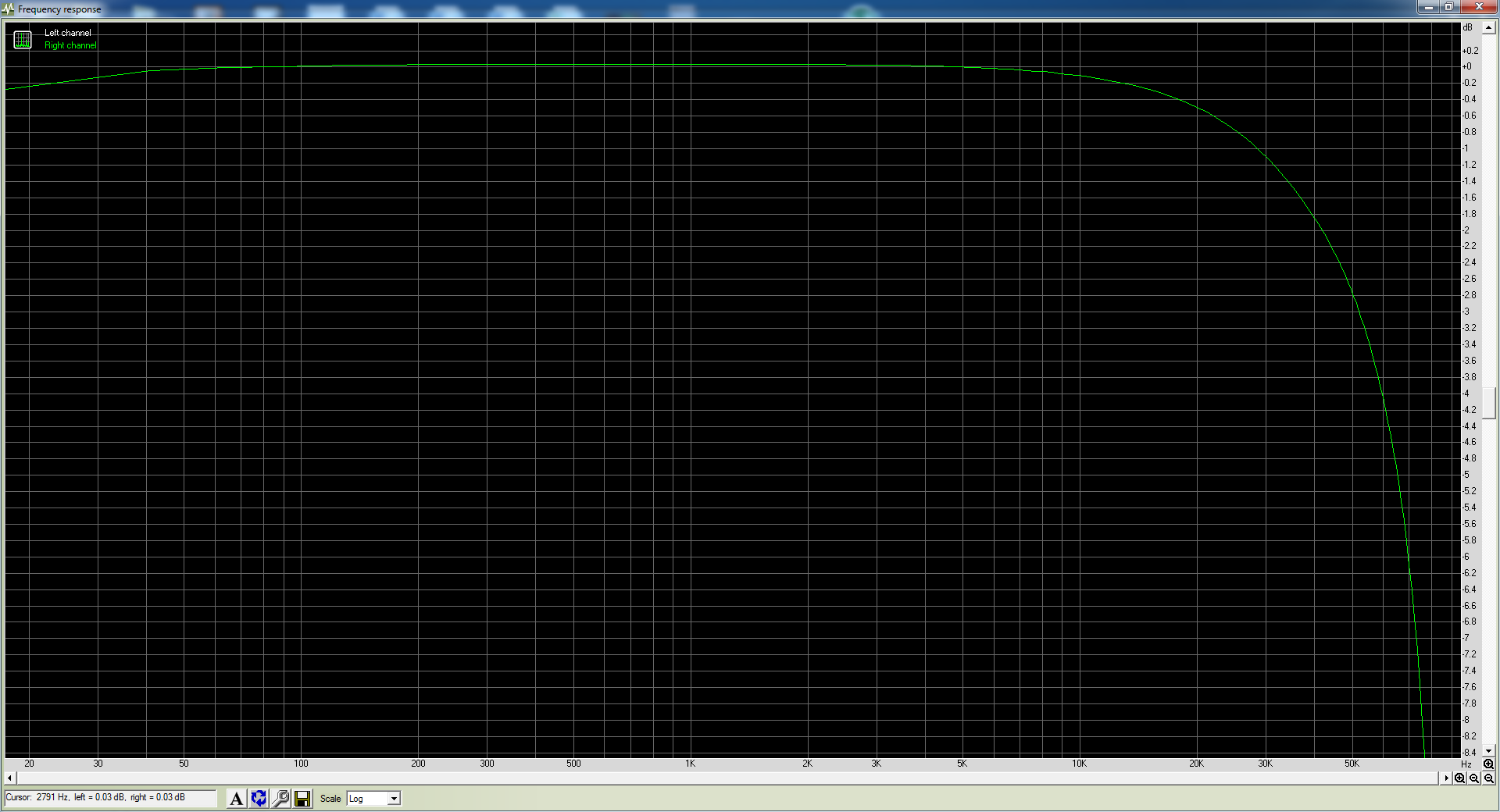

Frequency Responce of transformer with ES9038q2m at 1.4VRMS (~8kOhm in secondary loaded on 100pF cable): 20Hz=-0.3dB, 20kHz=-0.2dB (rel.1kHz):
Same, but with 470pF in parallel with secondary:
The possible output level depends on the output current of the DAC (and I/V resistance). In practice it sounds without problems on LF and HF with +/-2mA DAC types such as PCM63\TDA1541 at 2Vp level (1.4VRMS). Less powerfull DACs like PCM58 with +/-1mA have good enough LF even with 1.3Vp witout next buffers.

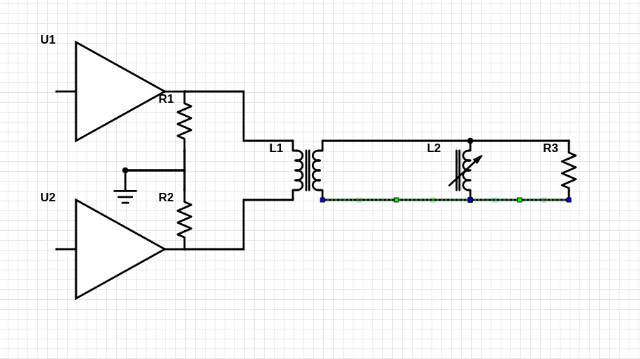

hi bisesik,
I have been using transformer i/v for one of my dacs for a number of years. The DAC is an ESS9018 based DAC that syncs clocks back to an SD card based transport. As shown here in this link - I bought it without the op-amp based I/V module: link
I threw together a quick schematic of the I/V and downstream components:
U1 - ESS9018D (+)
U2 - ESS9018D (-)
I use 4 dac outputs in parallel per channel but the DAC is dual mono so I could use 8 per channel. 4 was more straightforward to connect and I'm lazy, hah. I'd actually forgotten.
R1,R2 80 ohms
L1 Sowter 3575 (10k:10k)
L2 Tapped autotransformer stepped volume control
R3 22kohm amplifier input impedance
I set it up this way to try it and never touched it after. It sounds pretty great, but it could use a bit more voltage output.
I'm about to put the DAC into a proper enclosure and I was looking at more purposeful i/v transformer options when I came across yours. The Sowters were something I already had in the parts box.
What would you advise for my situation? The tapped autotransformer volume control adds a complication. The more voltage from the I/V the greater the step down from the autotransformer for the same volume level, other things being equal.
I'm going to do some research on my own, but it would be great to have your experienced input.
Thanks!
