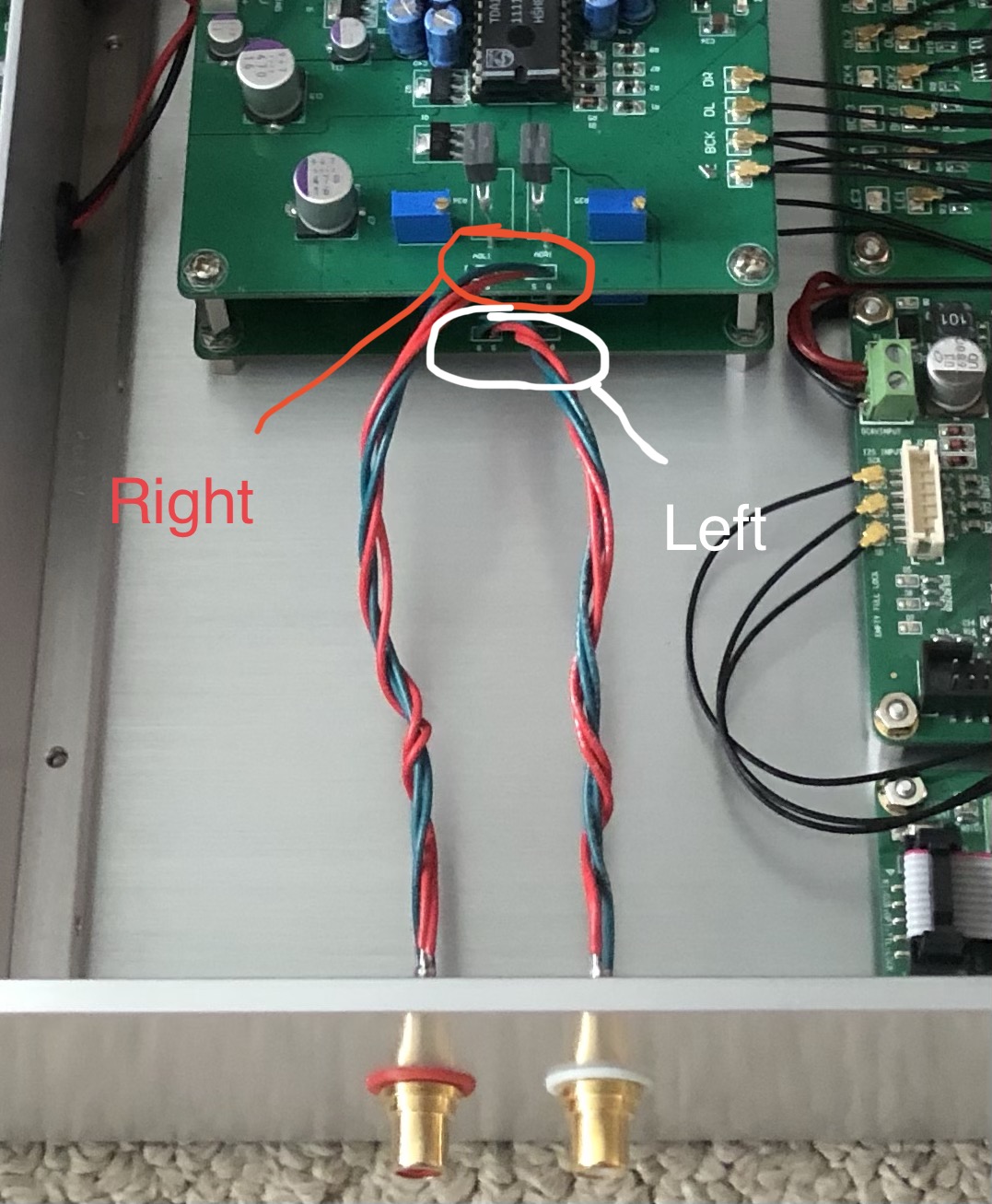

I think I understand your diagram for a single D3 board.
Could you show me how the wiring would work with the two D3 boards I have set up as dual mono?
I have attached a picture. They are stacked and one board is used to process either the left or right channel.
Also, should any of the jumpers be removed or changed to use the transformers with my dual mono boards?
I don’t know what value resistors are installed between R1a and R1b or R2a and R2b yet.
Regards
Kevin

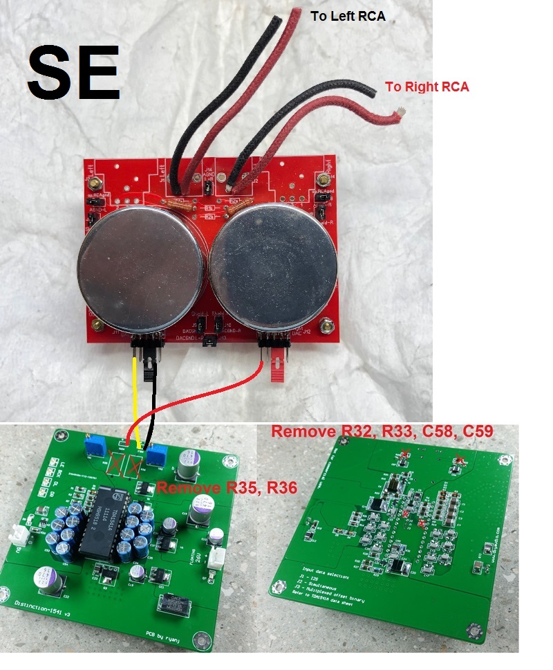

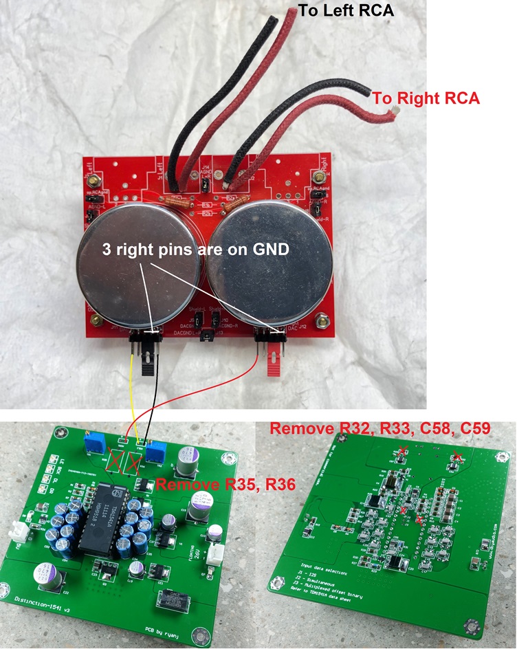

Kevin, I forgot that tubo's version was with two primary coils. That is why the previous drawing is wrong. That is why I was a bit confused regarding your wish to try DualMono setup. I think you mean the differential connection when talking about using of 2 D3 boards, right?
So, to correct the previous drawing, for SE mode (single TDA1541A) it is needed to connect this way:

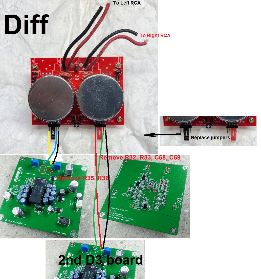

For dual mono (differential connection) you will need to follow this drawing:
Regarding R1a, R1b, R2a, R2b - there is no need to use them as you have already the installed R1 and R2 resistors 11kOhm. R1 and R2 are the i/v resistors that replaced your R35/R36 resistors on D3 boards. If you want to try i/v resistors on R35/R36 places on the D3 boards, then the exact same signal can be achieved using:
11k/484=~22 Ohm
