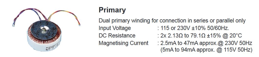

The AC magnetic field in a transformer is given by
Bac(max) = (Uac x 10⁸) / (√2 π fo S Np)
It has nothing to do with current, but with voltage.
If a power transformer is used, maintaining Bac(max) constant, being fo' the new lowest frequency, the useful plate to plate RMS voltage will be at most
Vp-p(max) = (fo'/fo) Uac
Let's suppose a 230V/50Hz mains (best case scenario) for fo'=30Hz
Vp-p(max) = 138 V RMS

I wonder how much tolerance is designed in for mains fluctuation; perhaps a 230V winding doesn't cause core saturation until 250V input?
I very much agree with Shoog that unless you've tried you cannot know how successful these mains toroids can be with the right tubes. If you've got efficient speakers and a few horizontal deflection tubes, it's an easy and inexpensive experiment.
I do not think so, manufacturers are greedy, and they mostly works on the saturation knee, even so, for 250V
Vp-p(max) = 150 V RMS @ 30 Hz
For primary load Zp-p=2K, it yields about 11W, mere 1.7W more.
I like to design my transformers for fo=15Hz, but if some folks are happy with 30Hz, it is just fine.

Since you know a lot more math than I do. What is the max 20Hz freq through a 25VA 120+120:6+6 coil at a voltage of 300V B+? In otherwords, can you give me the math to explain why this set up give only 2.5V out sine at 20Hz but 1000Hz is good to 15W? Sorry if this seems "noob" but I am definitely a "shadetree" builder.

Roughly, the magnetic field B depends on voltage and the magnetic field H depends on current.
With no load B reaches its maximum, with load, primary voltage is slightly reduced due to primary DC resistance, and hence B is slightly reduced too. The current creates H however both fluxes, primary and secondary, cancel each other.

I am just a TV repairman, but following above analysis
Vp-p(max) = (20/50) 240V = 96V
Turns ratio remains the same
Np/Ns = 240/12 = 20
Then on the secondary you have (neglecting losses)
96V/20 = 4.8V
If you apply a huge AC voltage at 20 Hz, the core will saturates and losses will be huge too, difficult to make a proper calculation.
At higher frequencies, the core is going to leave the scene (Bac goes as 1/f) and the windings are dominant.

Thank you for your explanation. So it would seem that low frequency response is limited which backs up what Shoog and others have said regarding low voltage, high current tubes.
You are welcome. Yes, the low frequency response is limited, unfortunately.
