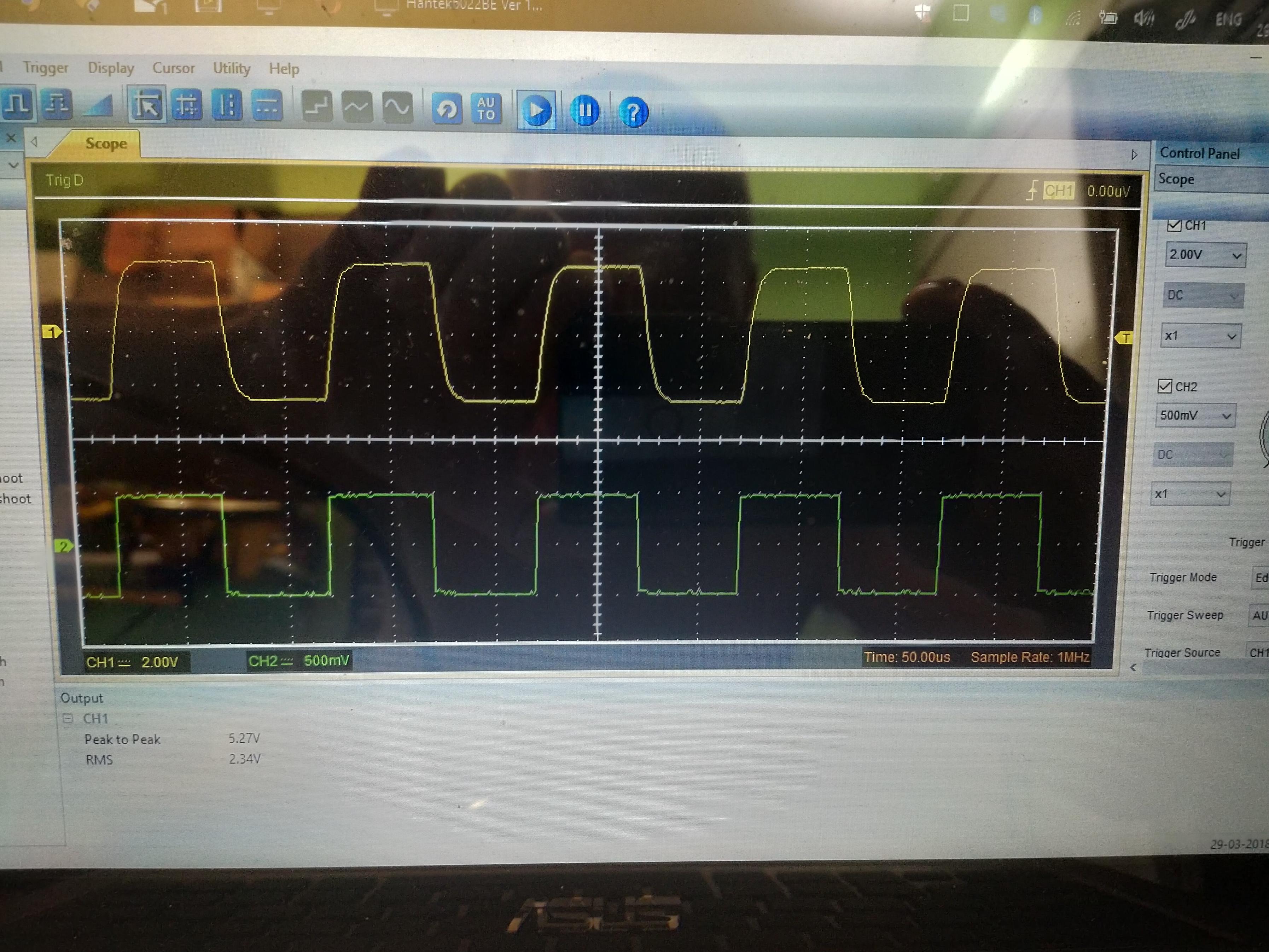

The sine wave looked fine in open loop at 60kHz. The square wave was awful. Still, when was the last time you build a feedback free amp while trying to "cut corners" by using PT's as OPT's? 🙂
Attached is an open loop trace of 10kHz open loop square wave. Bottom trace is DDS.
Could you please post 10KHz square wave closed loop if you where so kind?

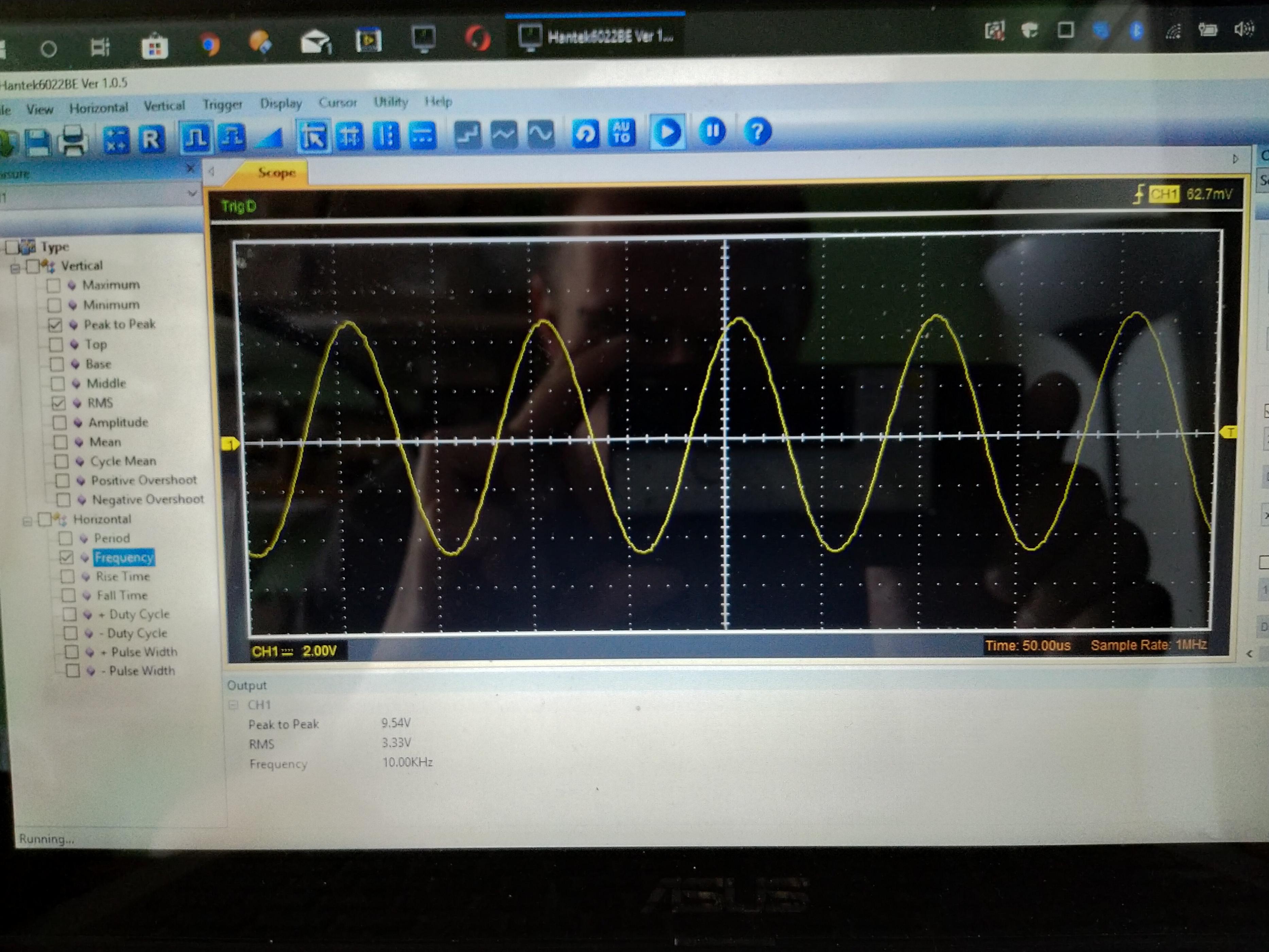

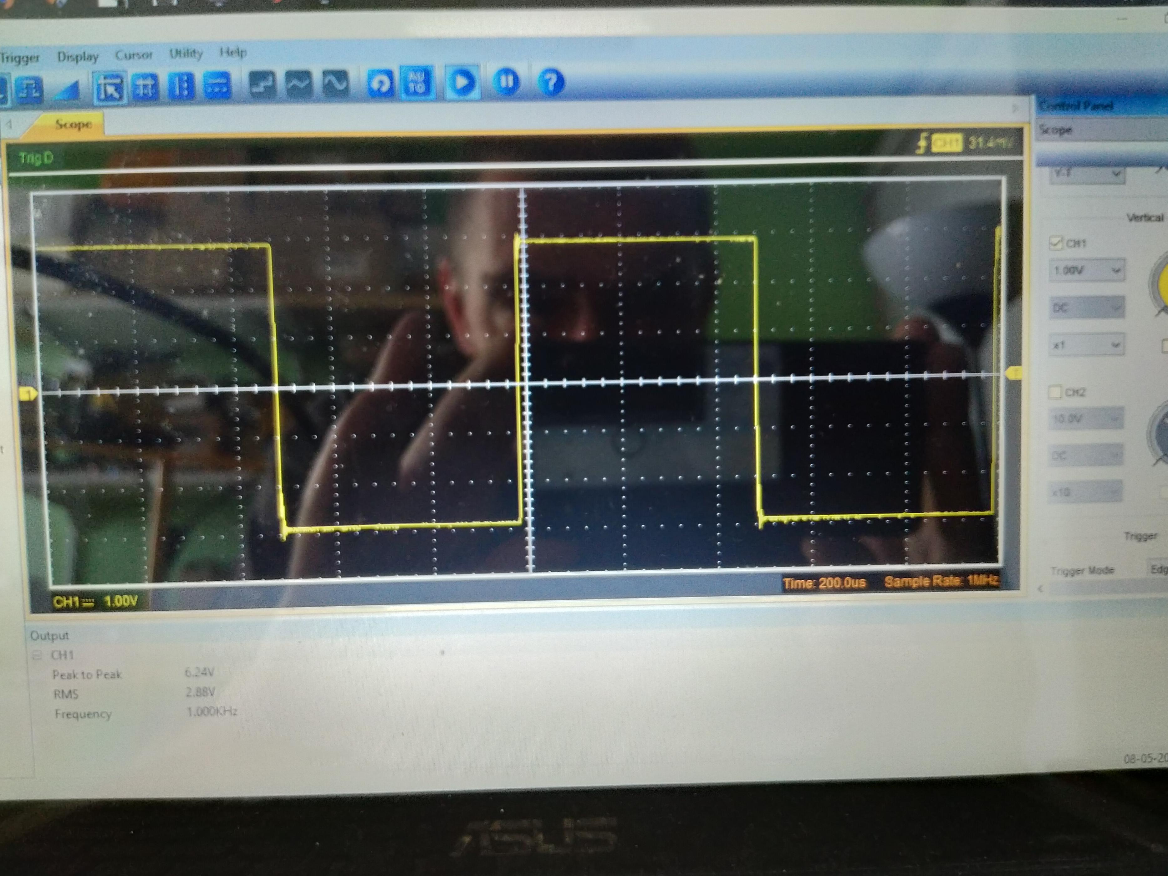

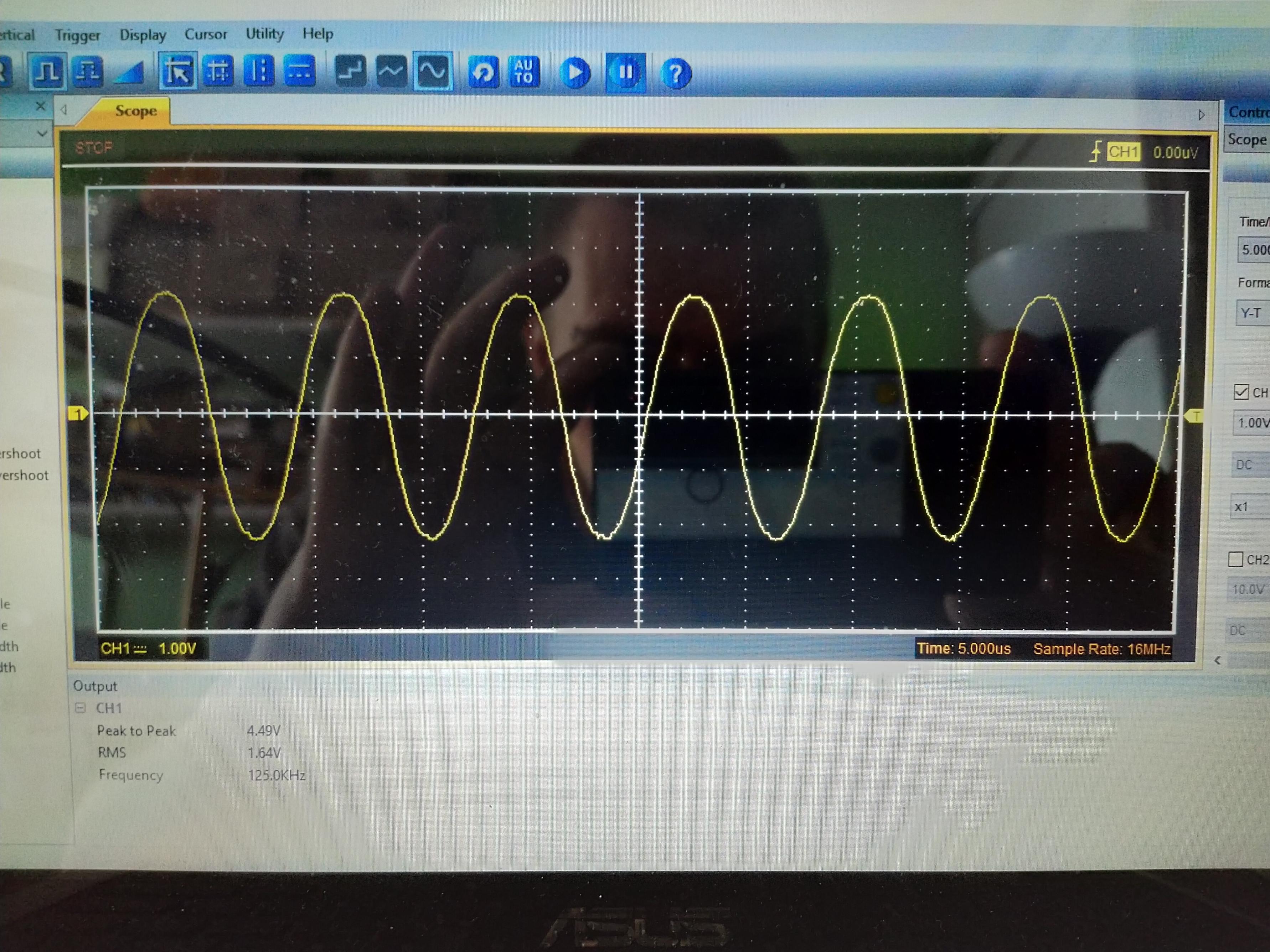

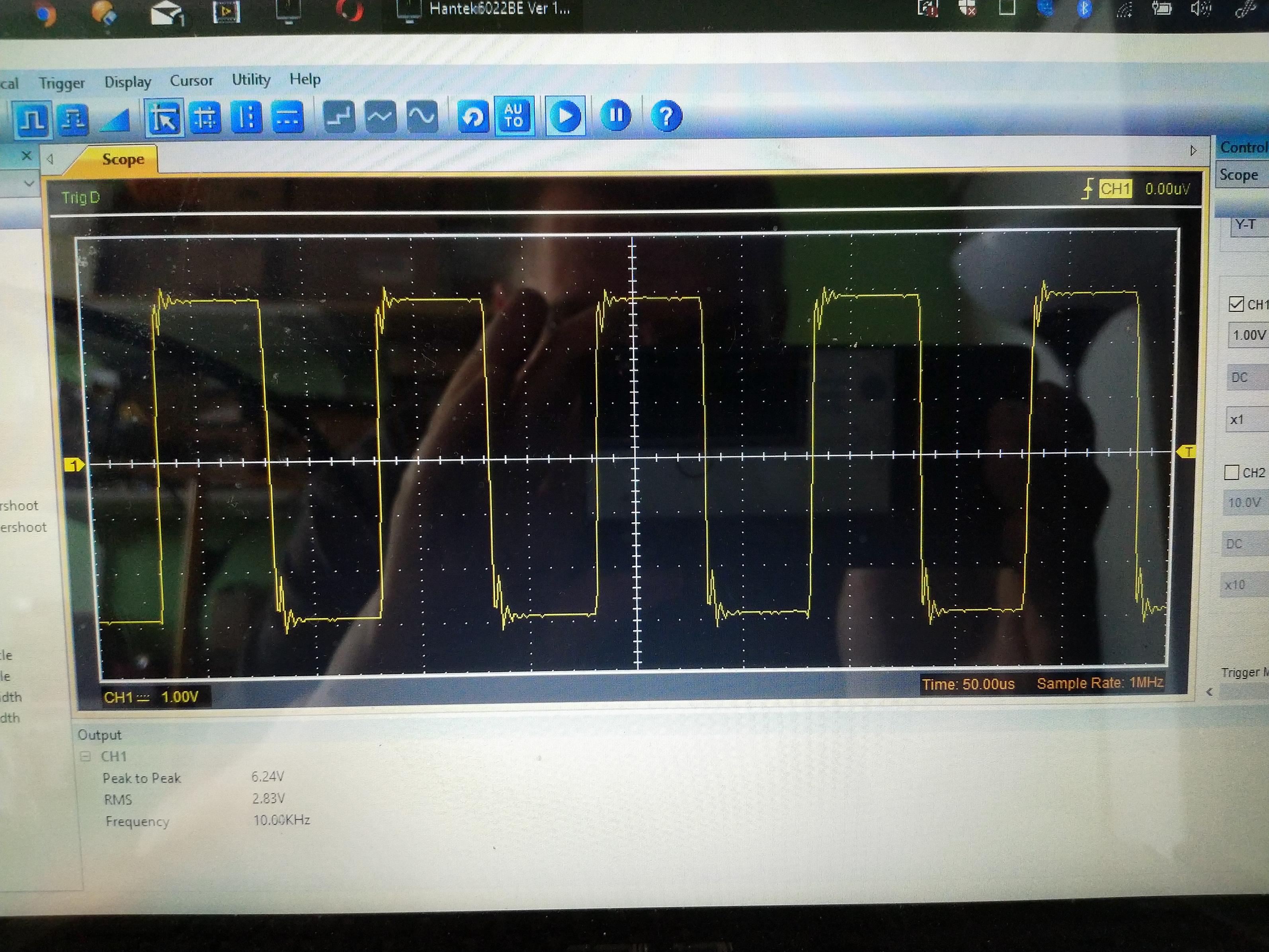

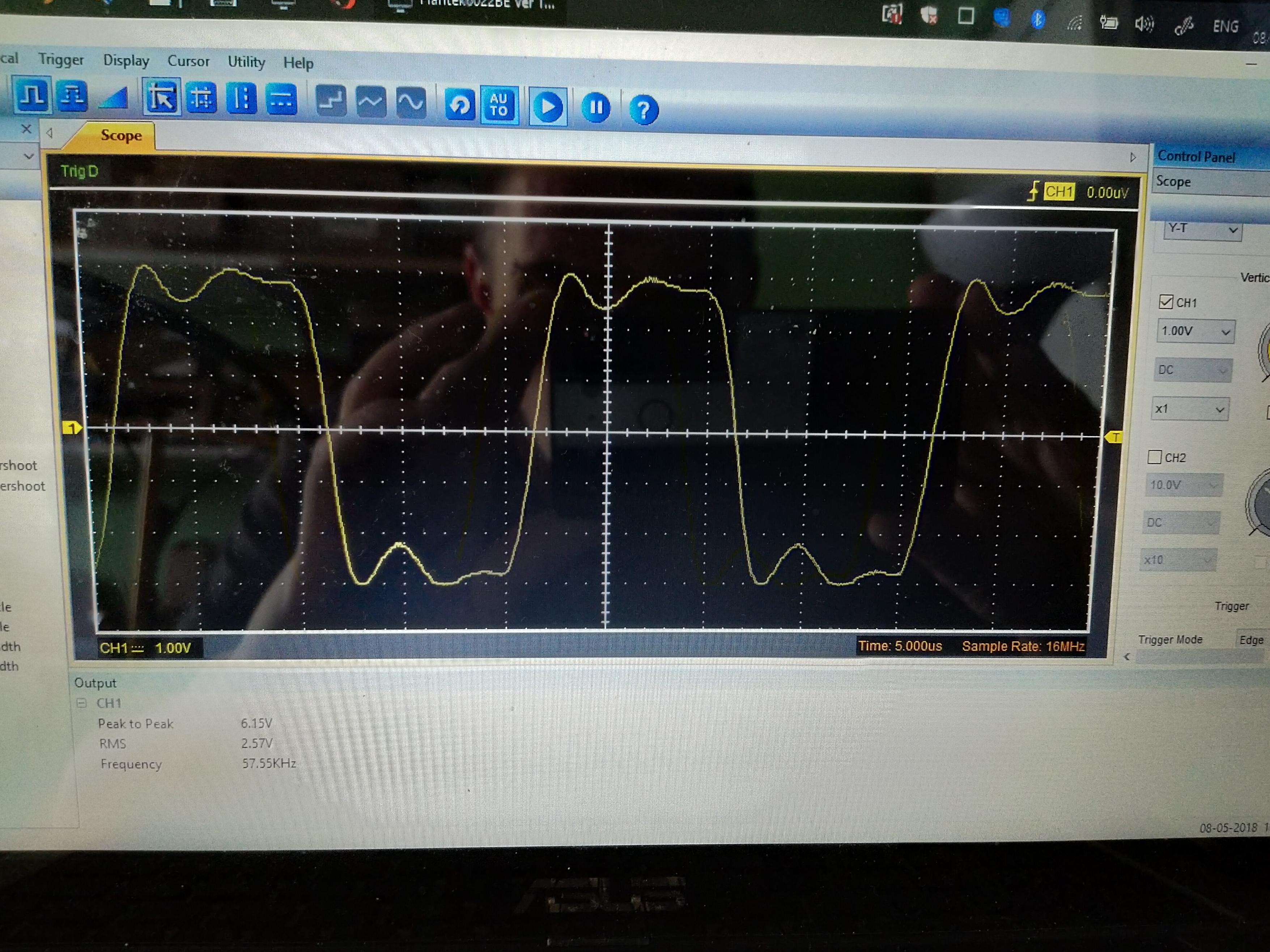

I just ran some tests, here are the results... Improvement would be made by fine adjusting the NFB cap, but I only have so many values, and that was the best I could do with what I had. The source voltage was changed on these tests, the output voltage isn't to scale.

Gotta say… that looks almost incredibly good given the output transformers you've chosen to use. Personally I don't mind a bit of way-high frequency ringing on the leading edges of 10 kHz square-waves. Just points to a pole fairly close (in interpreting your oscillograph traces) to 200 kHz with a Q of about 7. Nothing to worry about. I might be inclined to introduce a very small amount of anode-to-grid external capacitance (47 pF in series with 18 kΩ) in order to squash it, but that's about all.
