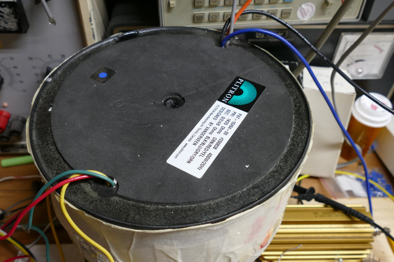

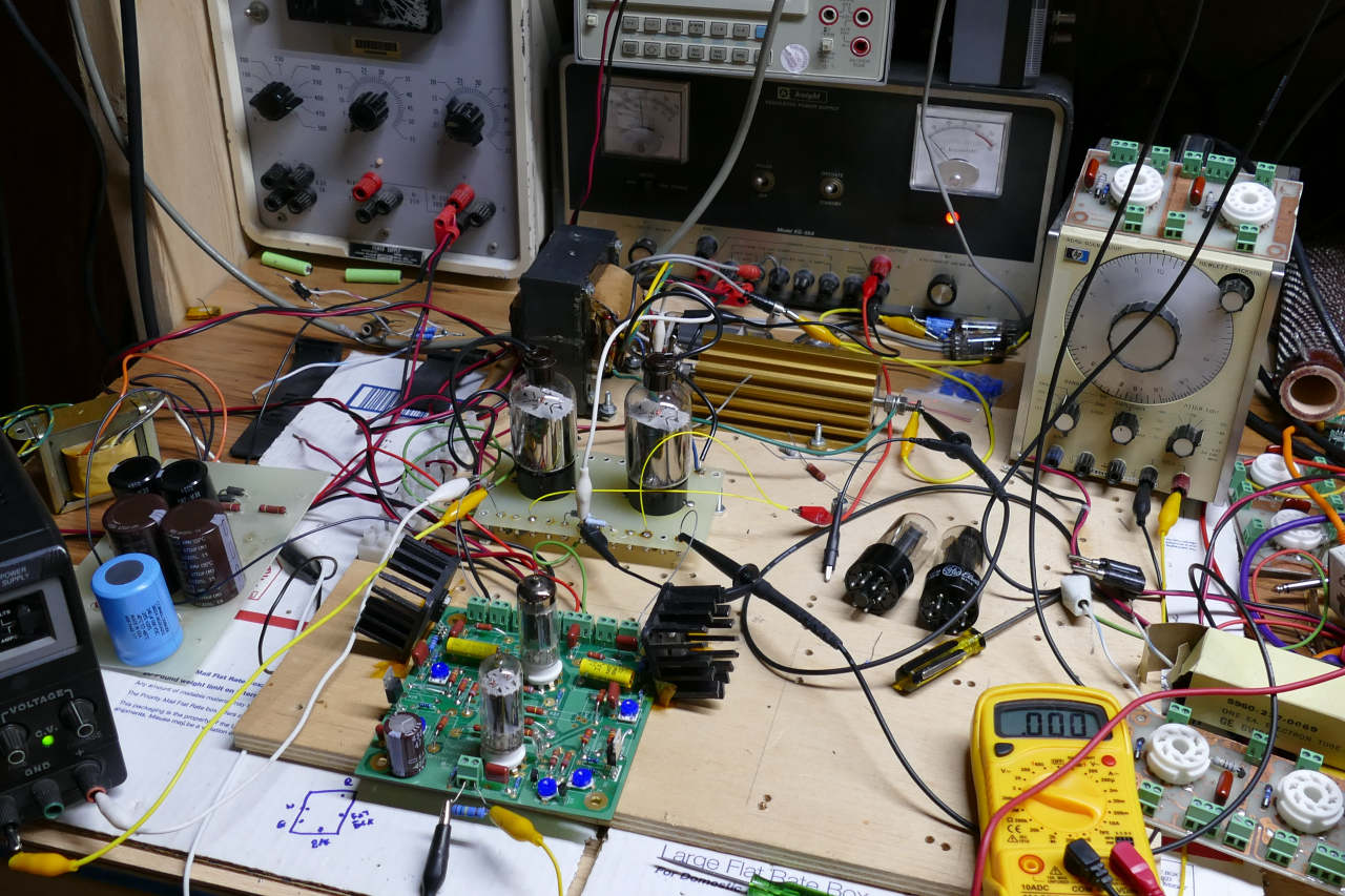

The transformer can be seen in the first picture squeezing 112 watts from a pair of 6DQ6's. Its behind the tubes, and to the left of the load resistor.

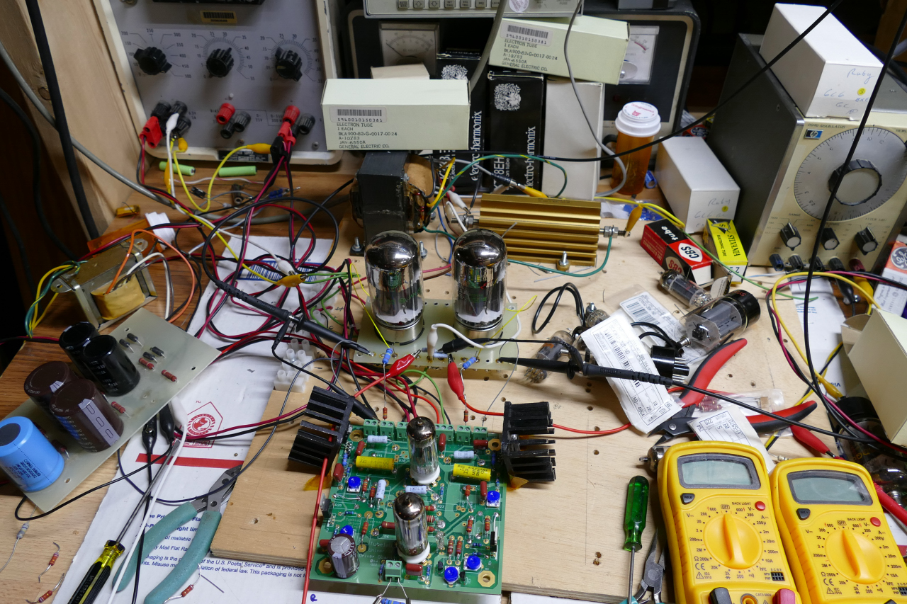

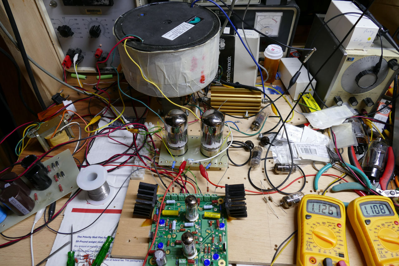

The second picture shows a pair of $$$$ NOS JAN GE 6550's in the hot seat. I get everything working with the cheap OPT's , THEN hook up the $$$$ Plitron toroids. The cheap OPT has the tube box sitting on it. The picture is not totally clear but the fat secondary wire goes to the black (0 ohm) wire, it's other end goes to the yellow wire (4 ohms), as does a thinner wire that will emerge and connect to the green wire (8 ohms), the 16 ohm wire is too thin to show easily in this picture.
The big Plitrons DO outperform the Cheap OPT's.....I paid under $20 each for the budget stuff. The Plitrons.......Used they were about 15 X more expensive.
