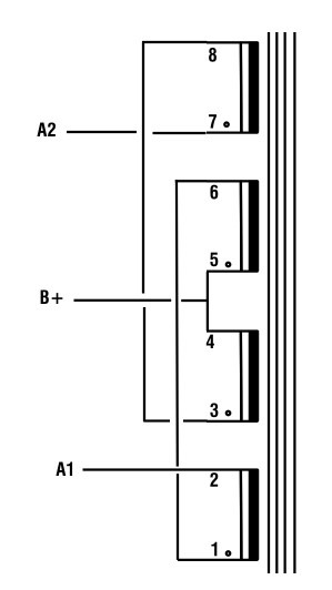

Output Transformer Interleaving
Leak Stereo 60 OPT: it's OK, but not the greatest

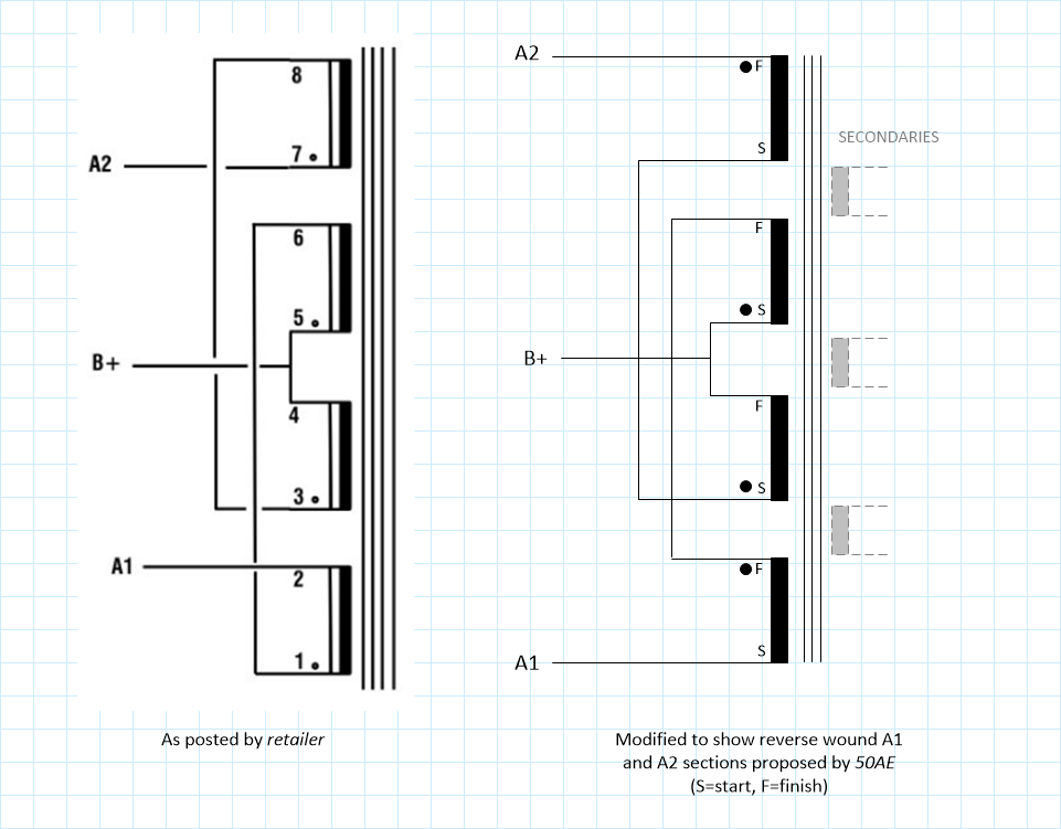

Yes. In this case Basically, keep the winding direction of primary 1 and primary 4 (anode chunks) as the same winding direction as the secondary. Reverse-wind the Primary 2 and 3 (B+ chunks).
To be easily understandable.
Normal winding direction of a primary chunk
Output---Layer4------------
-----------Layer3------------
-----------Layer2------------
Input-----Layer1------------
Reverse winding direction of a primary chunk
Input-----Layer4------------
Output---Layer1------------
To reverse wind, you don't necessarily have to change the motor direction of your machine. Just detach the coil mandrel and reverse it in the other direction 180 deg. Note that lead-outs will also be swapped, so if you have begun your wire lead-outs from the left side of the coil, to reverse wind you'll have to start from the right side.
