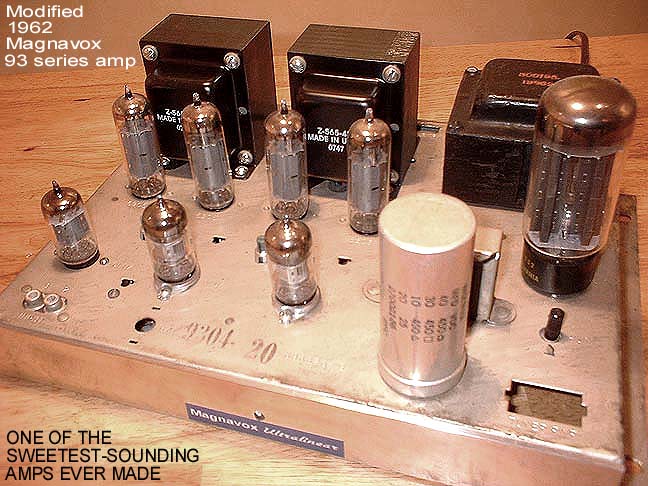

Years ago, as I was building my EL84 stereo amp, I carefully did my homework for suitable output transformers.
I didn't go into messing around with opinions, and I wanted a transformer that naturally performed with as pure and undistorted output as possible.
I checked out the "transformer shootout" details on Triode's site - http://triodeel.com/pdf/xfmrshootout.pdf
I also went over other sites relating to the use of these transformers, including David Gillespie's biasing idea - the "EFB" system. - New Modifications for the Dynaco SCA35 and ST-35
After testing several transformers for EL84's, I settled on the Dynaco Z565 in ultralinear duty, along with Gillespie's Enhanced Fixed Bias system.
No opinions from others, no endless babbling from internet blogs, I wound up with a near-perfect amplifier that drives my hungry floor-standing Advent Maestro's (4 ohms) with ease and grace.
The original chassis, taken from a console Magnavox 9304 amp chassis was the base, and now competes with EL84 amps costing rediculous prices.
The bottom line - I'm quite pleased with the results, I haven't had ANY problems with the amp since 2007.

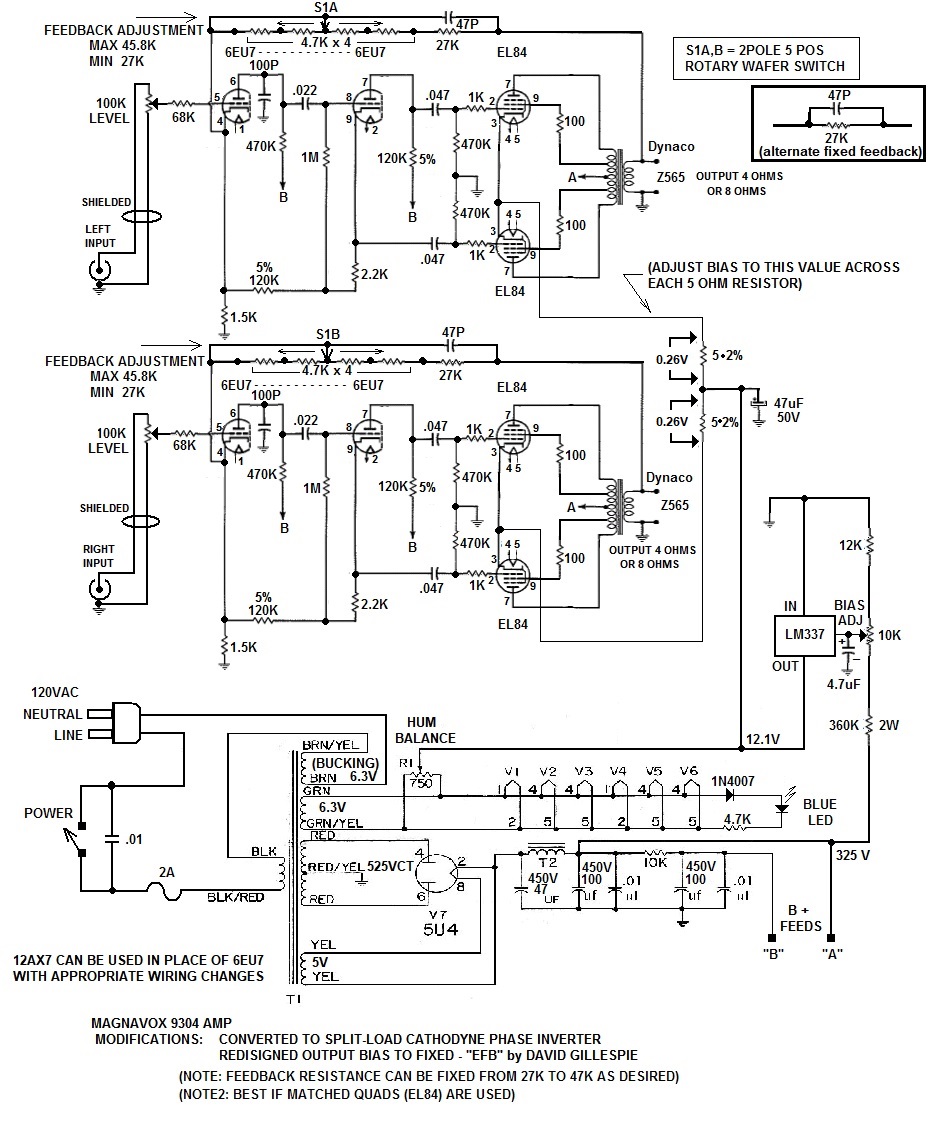

Is the schematic for your amp available?
Sure thing.. 😀
If you must use any other power transformer, make sure it gives close to 300-325V DC for the B+ to the outputs.
This is the schematic, and although it's using 6EU7 preamp/phase inverters, you can use 12AX7's with the appropiate wiring changes.
I chose the 6EU7's for their very good immunity to noise.
If built to my design, it's a terrific amp.
Also, if you don't need to fool with the "variable feedback", you can simply use just a 27K resistor instead.
If you build it, let me know what you think.

@wiseoldtech thanks for posting your schematic - it is a nice design. I particularly like the EL84 baising/cathode arrangement.
For my own edification, I wanted to ask a few questions about the preamp/phase splitter stages. Why do they have a common cathode resistor? With the phase splitter, isn't there some imbalance becasue on the anode you have 120k, while on the cathode 123.7k? I know it's a small difference, but still.
The 1M grid resisitor of the phase splitter triode doesn't go to ground, but to the top of the lower ressitor - isn't that then feeding back the output into the grid of the triode - positive feedback?
Ahh, the questions!
To put it simply, the biasing arrangement and feedback design is from a long-gone great designer of audio equipment, a bit unconventional, since you must have in your mind that the 1 meg resistor "must' go to ground.
In this case, its use is also to hold a steady biasing of the phase invertor regardless of drive conditions - resulting in a cleaner and more balanced drive to the outputs.
The small "deviation" you mentioned about the lower resistances is also a controlled "system" allowing some local feedback to the preamp.
All that, and along with the novel output biasing arrangement, results in a highly stable amplifier under even stressful conditions - distortion is difficult to get even when pushed hard.
My neighbor, with his "picky ears" cannot tell the difference between this tube amp, and the 60W/ch SS amp when I "A/B" switch between them.
Even at louder than normal listening levels - driving the Advent Maestro floor speakers.
I've used this tested and reliable design on other amp builds, all perform excellently.
When you get something "right" as this amp design shows me, you stick with it.
