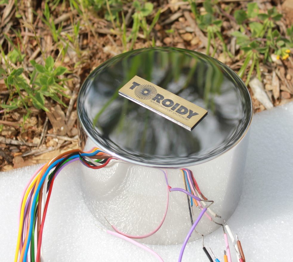

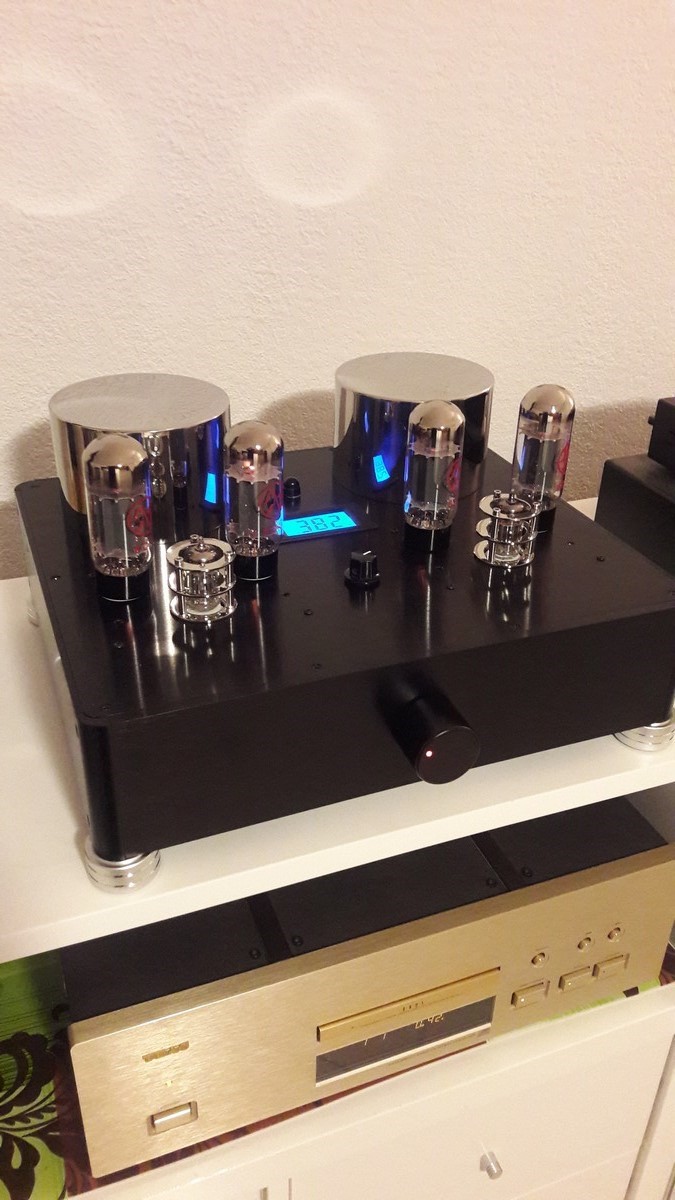

Several builder of the Baby Huey amplifier including me have used EL34 6.6k and KT88 4k Toroidy output transformers ( Transformatory toroidalne - Producent transformatorow Toroidy.pl ) and I can recommend them without hesitation :) They are very good and the price is fair, nearly half of Plitron ( Plitron Manufacturing - Engineered to Perform Like No Others ) with the advantage of very reasonable shipment cost.
You can buy them from TME their distributor for standard version but if you want the very nice potted version (see picture, the sticker is easily removed as you can see on pvphil picture) it is made on request directly from Toroidy very quickly :D
You can find some information from Bfpca here : EL34 Baby Huey Amplifier
