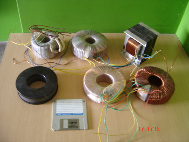

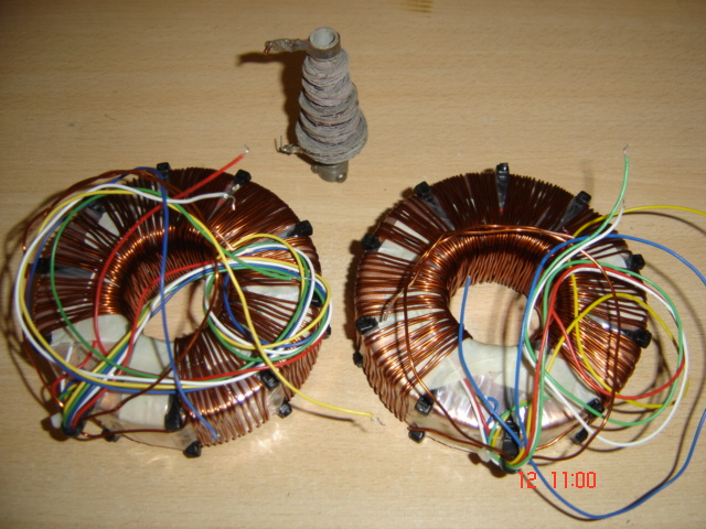

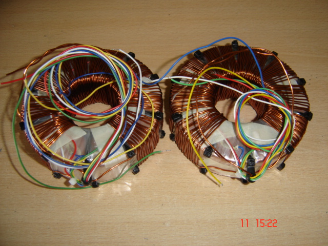

Toroidal cores are not in the list. Why?
Of course Dave, it's a discussion about GOSS since the beginning and numbers are referred to it.
They are. See post n.50.Toroidal cores are not in the list. Why?
With minor differences (in practical use), GOSS toroidals can be included in the same class of C-cores.

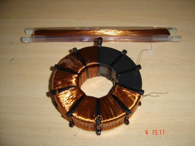

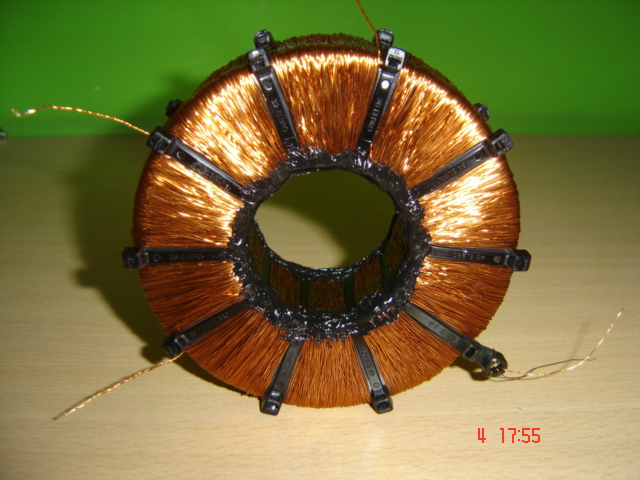

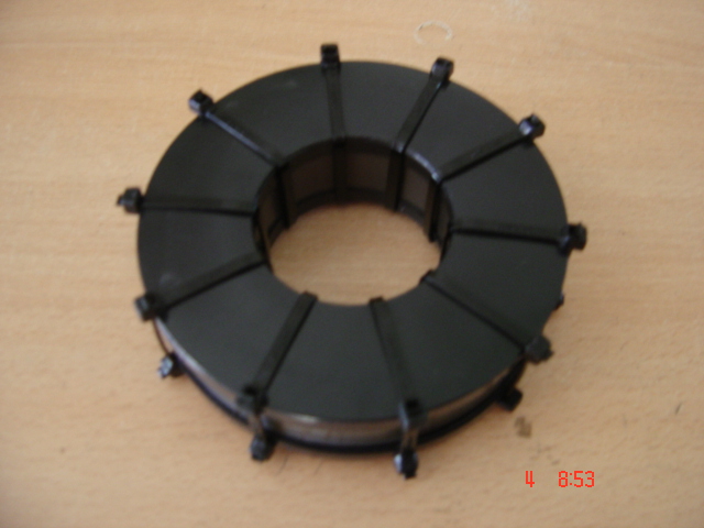

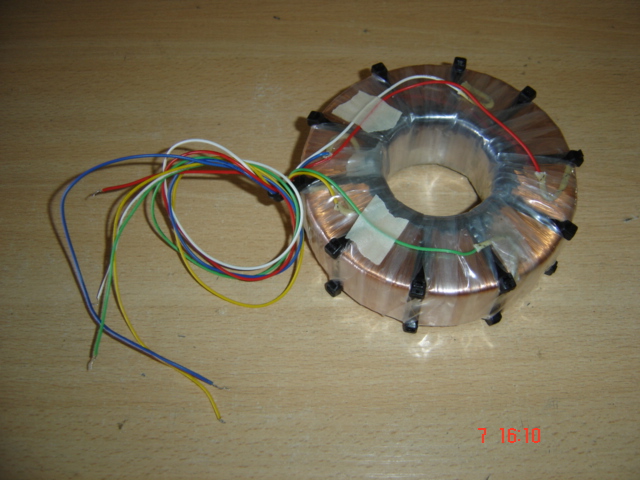

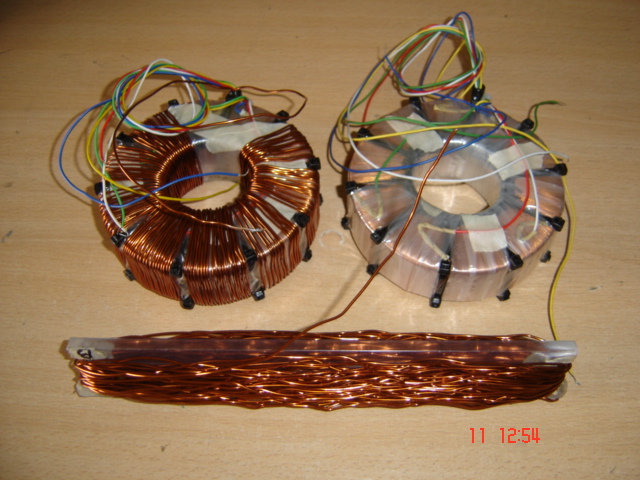

Did you make those in the pictures?
I refer to the first post. The post doesn't mention toroidal (Except you are using another name for them).
Yes, I made them turn by turn. 3000 + 3000 with derivation for UL at about 33% (1000 turns), and 160 for the secondary, to match 6Ω speakers. But they aren't the only I made, I made several more including power transformers for 275VDC at choke mode input. Again, turn by turn hand made.
