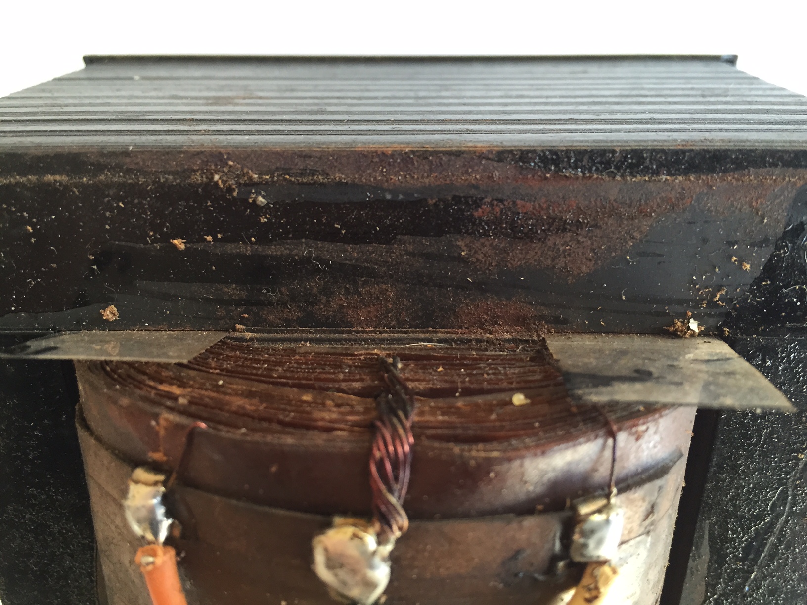

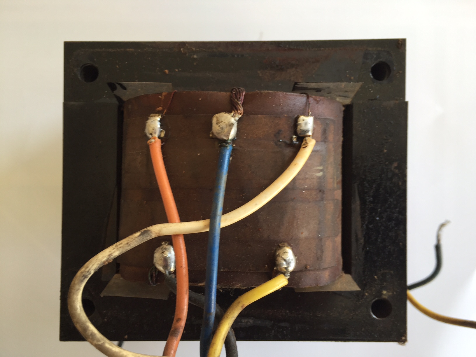

The gap can be created outside the core itself.
My first attempt of a toroidal transformer for audio, was 8KHz width :(
I don't known anything about this name. But if you wind the wire with a diameter higher than the core external one (The cross sectional perimeter of the iron), then, part of the magnetic lines will close in the air, like a "manageable" gap.
Does this really prevent the core from saturating? As far as I can see, this primarily will increase stray inductivity.

Sure! But I say that I watch it in battery charger where a intrinsic current limit is desirable to protect the trafo itself and the battery. Obviously in OPT it is undesirable, although in some circumstances it may be wanted as a way of increase the false bass of the speaker's bass resonant frequency, for example.
