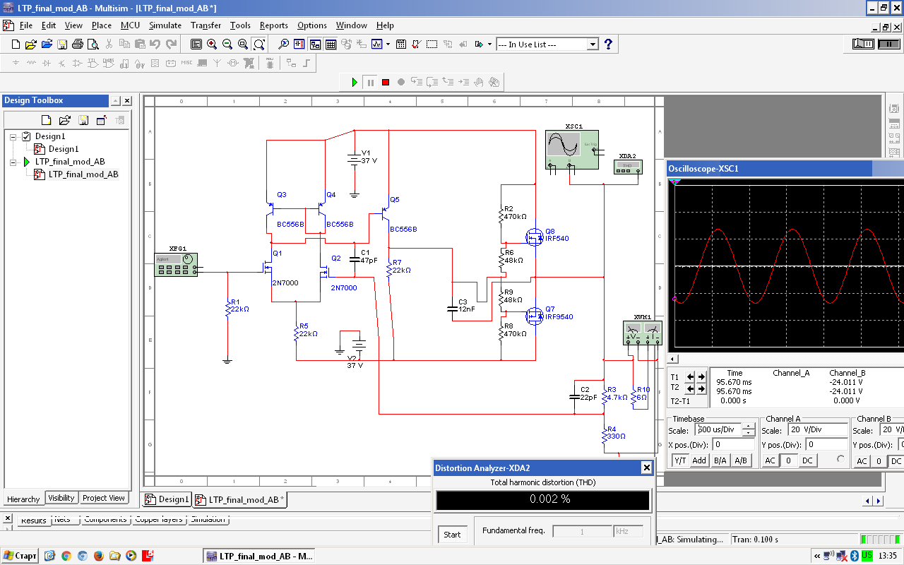

HI all, I cant figure out why this is not working 😱

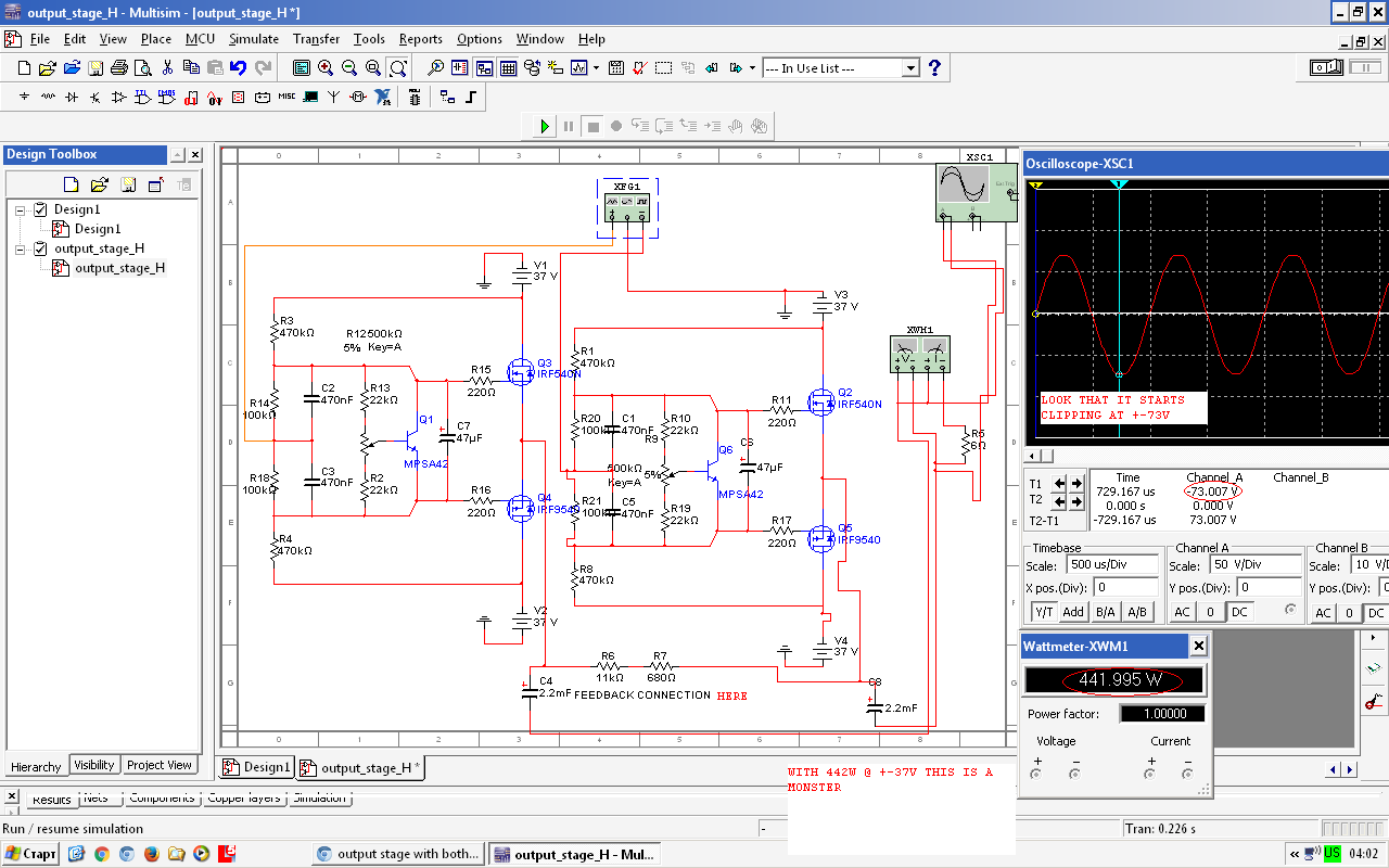

I want to use not a pair, but two equal fets and two temperature compensations.
Definitely commend you for that. If you're gonna use MOSFET finals, either N-Channel or P-Channel: not both in the same circuit. Avoid "complementary" pairs -- and "complementary" MOSFETs are a helluvalot less complimentary than NPN/PNP pairs) means one of two choices: OPT or Circlotron. That OPT-less, complimentary, SEPP topology was originated for BJT finals, and that's what it should be used for. MOSFETs perform poorly when adapted to that topology, but no OPT is cheaper than the cheapest OPT. The Marketing Dept can work to convince you that the "MOSFET sound" (translation: distortion) is the nextest mostest, bestest, kewelestest thing to come down the pike.

LTP without current mirror (phase splitter), ccs is possible but i dont see reason to use it.
somewhere i readt it is for stopping AC voltage 😀 Its the pair which stop AC and what is this stupidy 😕
Personally I think they are for the Ic's (thermal stability fb).
I see in a lot of circuits use them as a VAS bottom load.
I dont know anything about that. Advantage or not ? Why ?
LTP (Ph. split)(with 2xBS170 or 2n7000 -> Two vas-es (with BJTs) -> two biased MOSFET OPS-es -> NFB from A phase to B

I talked about complementary pair, not quasi..
Look @ the example, I simulated two OPS-es and this monster start clipping @ +-73V delivering up to 442W 😱 😱
Im gonna open thread because this is MONSTER
Look @ the example, I simulated two OPS-es and this monster start clipping @ +-73V delivering up to 442W 😱 😱😱 😱

There is in two cases:
-with the cap referenced to ground (internals are to the reference point like this)
-without R7 and R2, Q5's collector connected to Q8's gate
Everytime there is a way and everytime its the simplest 😉
