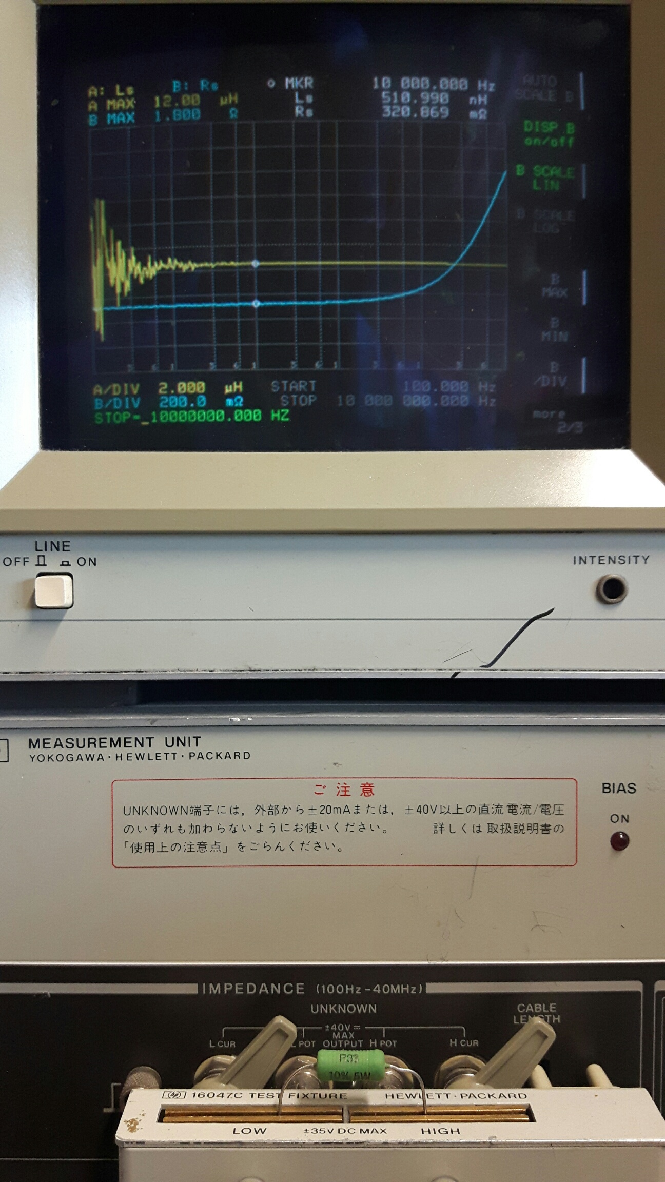

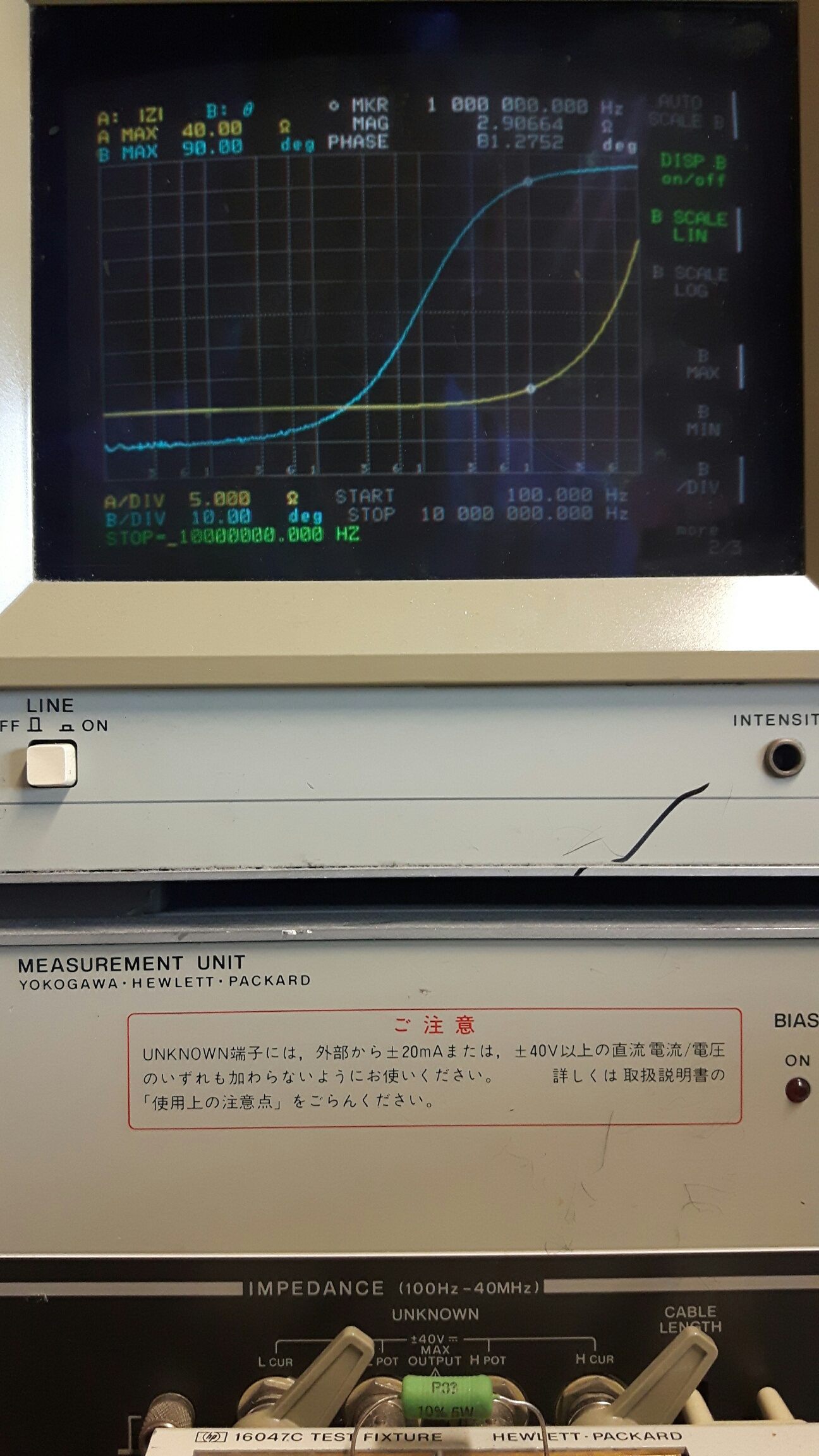

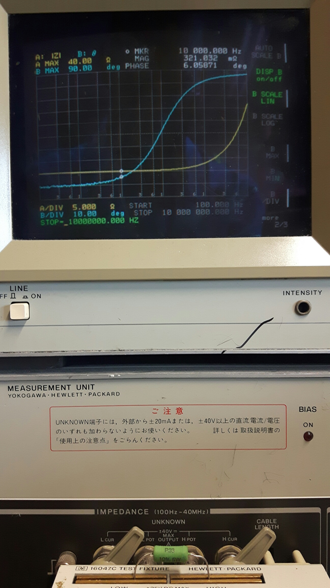

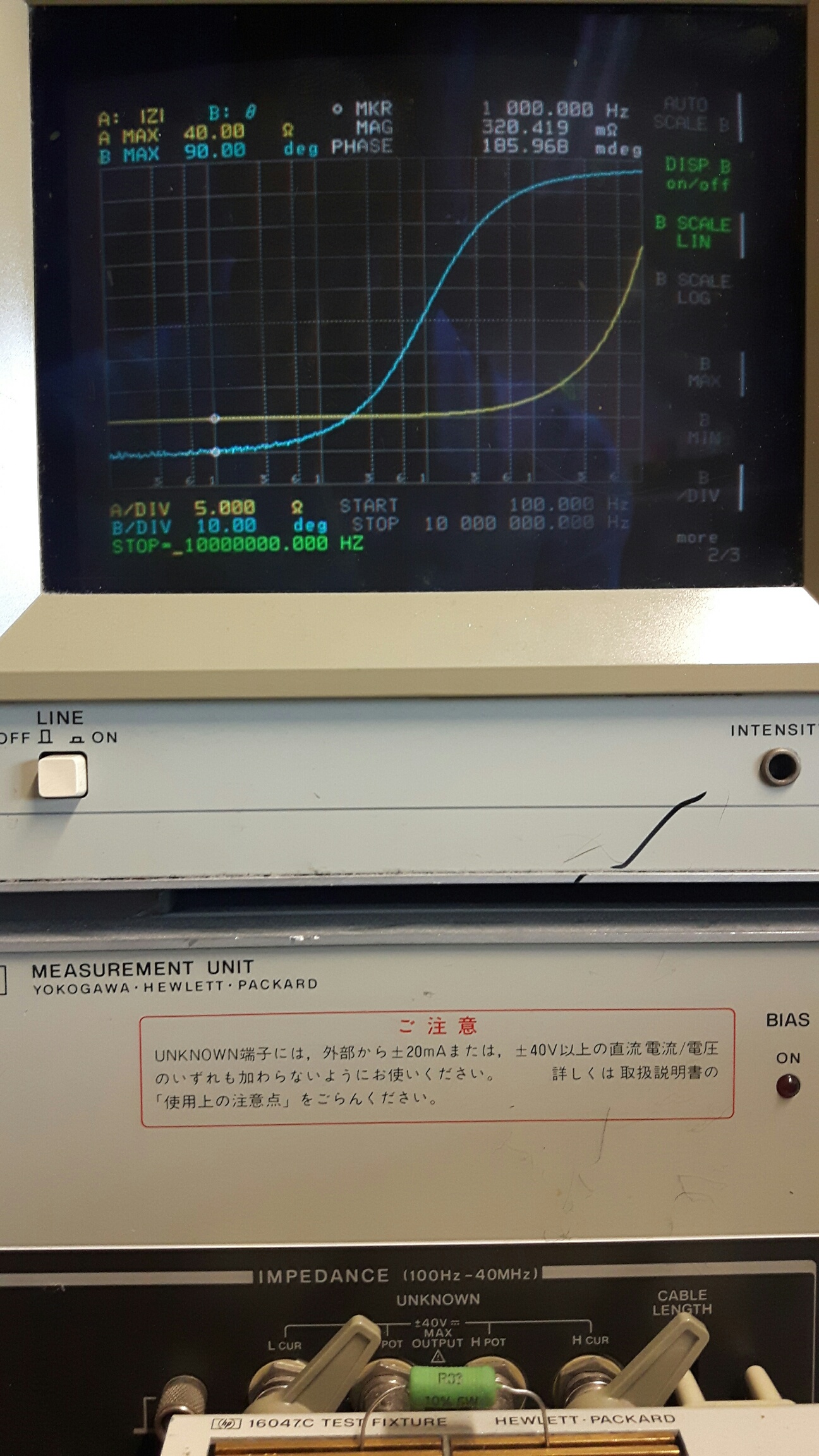

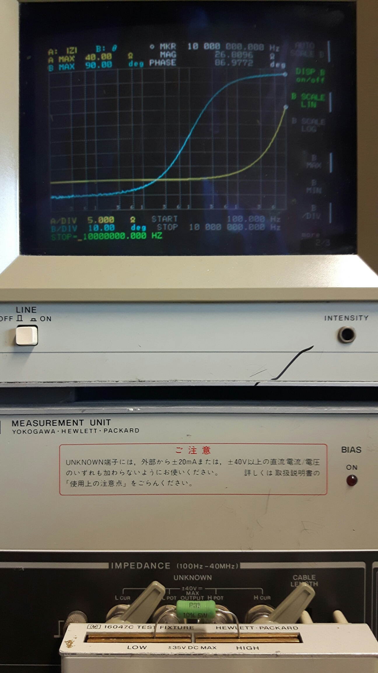

These green WW are tough little things but not really resistive above a few 10s of kHz. Allready at 10kHz the phase is 6 degrees. At 100kHz the phase is close to 45degrees. The 'resistor' is trying damn hard to act like an inductor now.
Not sure I'd use this series of WWs anywhere in the audio path, at least when more resistive options exist.

Very interesting indeed. Do you have measurement of other power resistor like the Panasonic ERG? Or Vishay MRA? Thanks.
Hi SemperFi,
What model of HP network analyzer are you using? I have a 4195A with the impedance measuring kit, but no stages and no APC-7 connectors to build one or more.
-Chris
-Chris

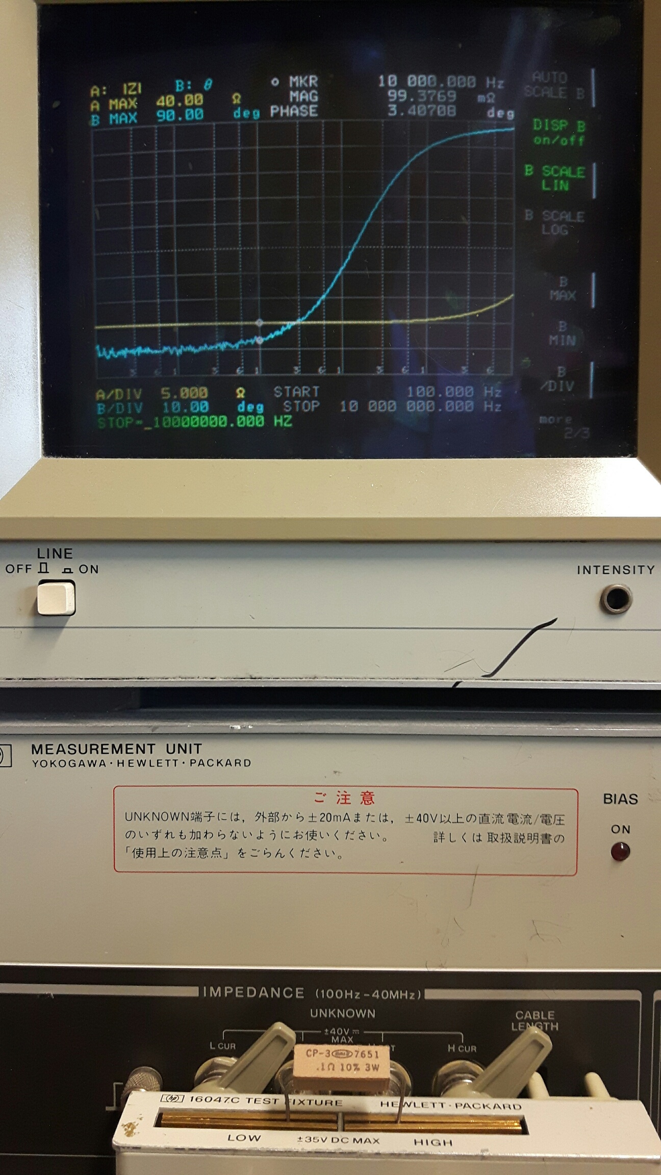

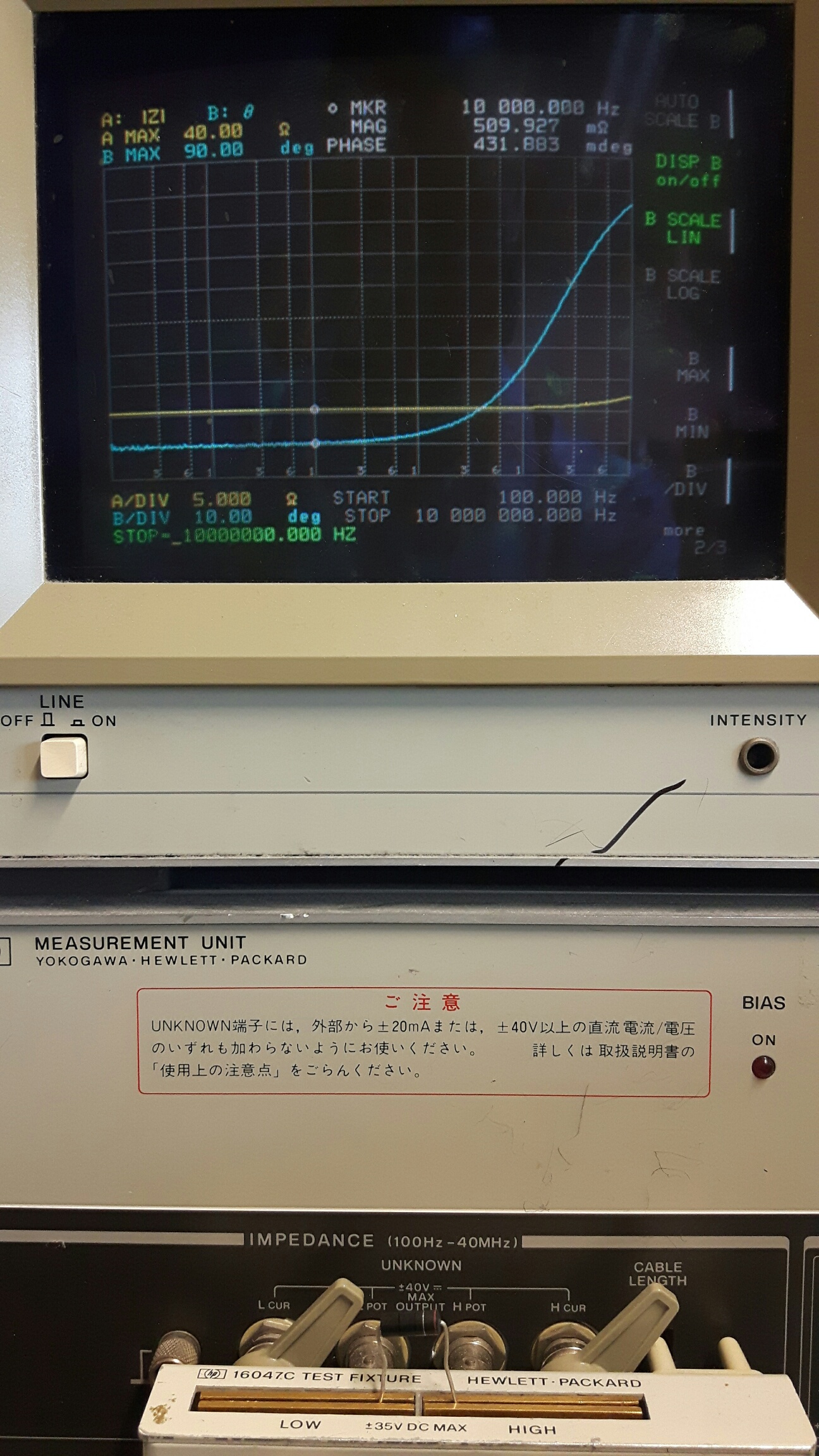

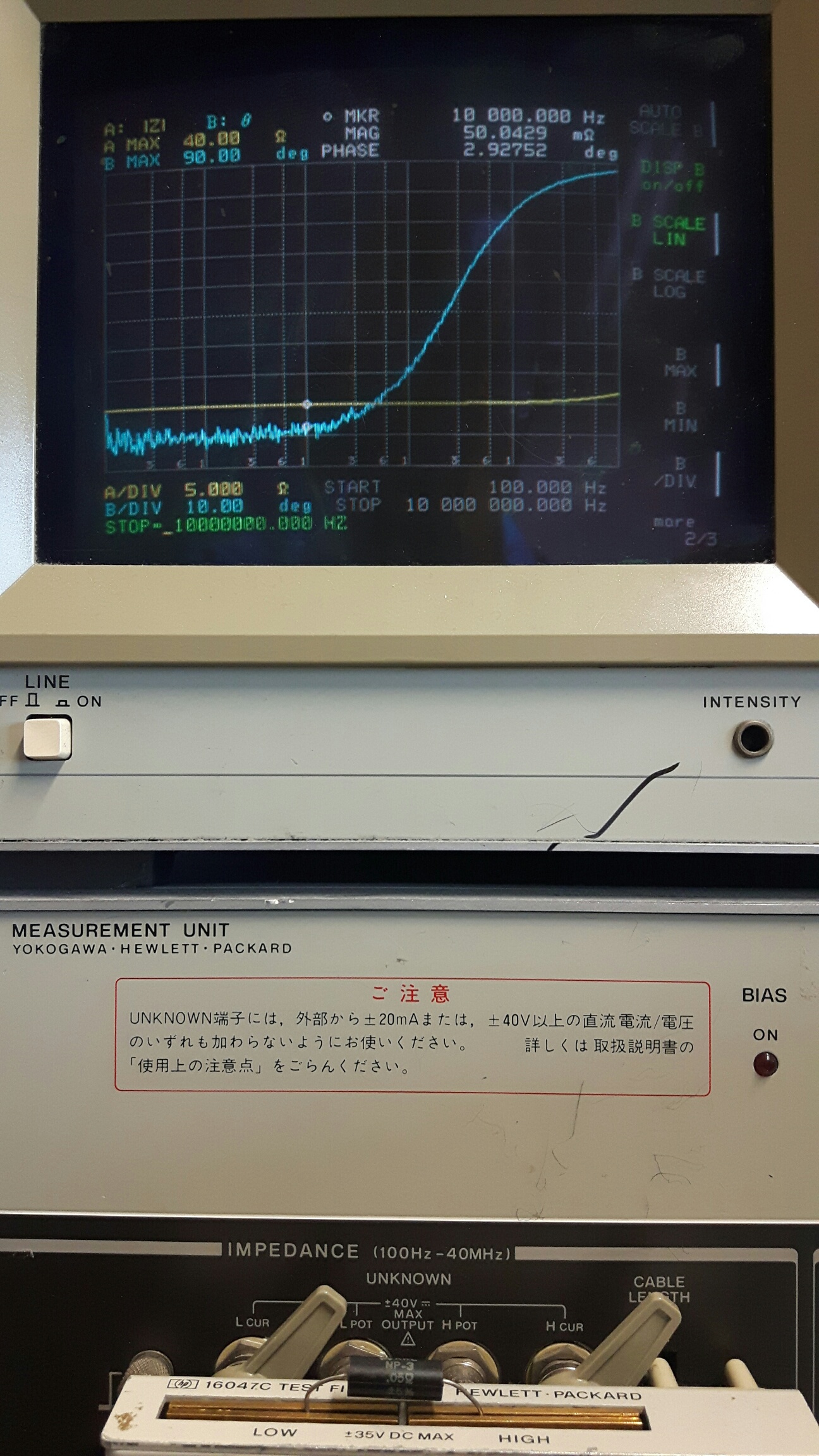

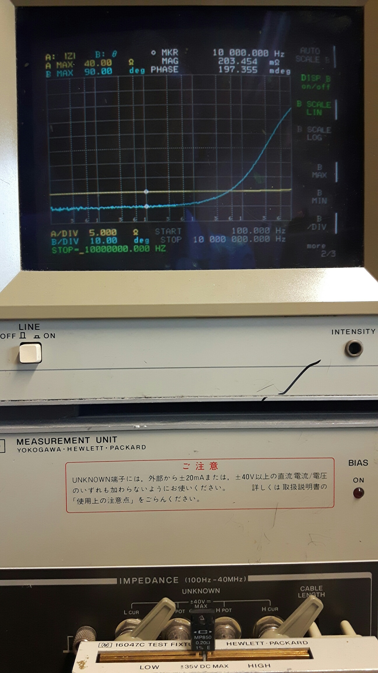

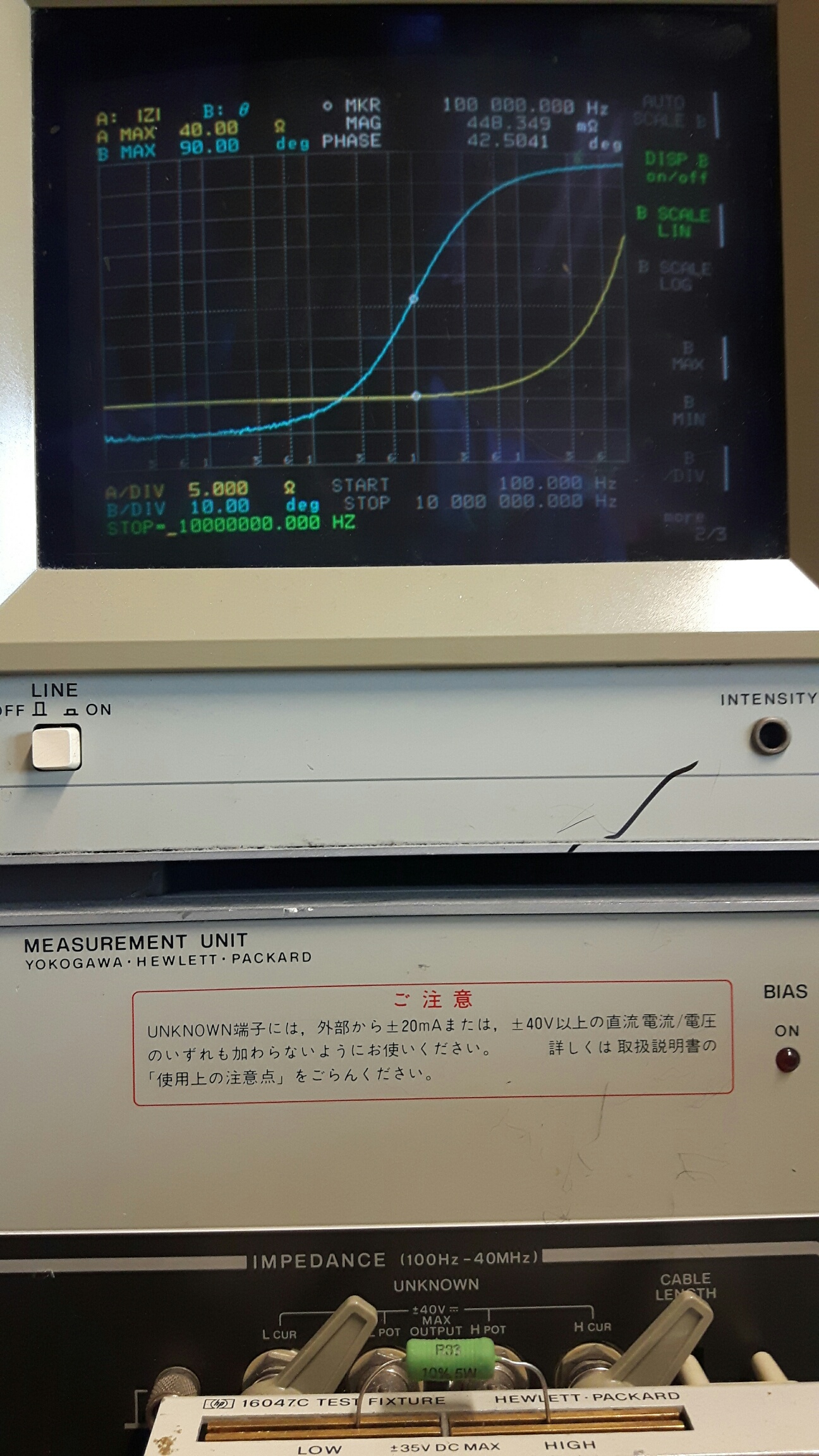

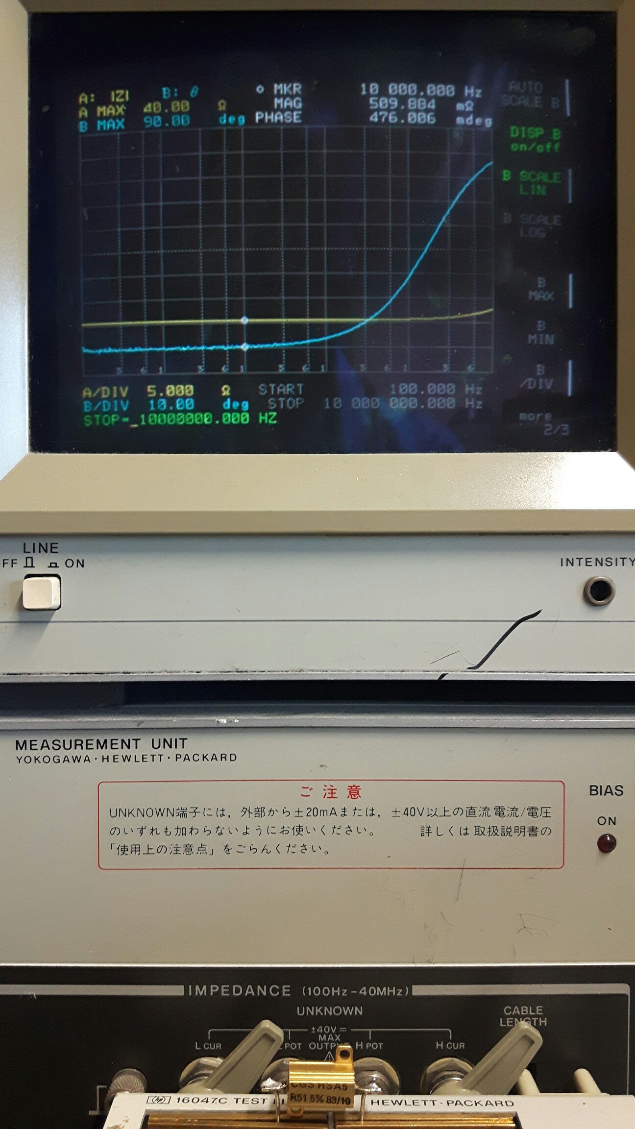

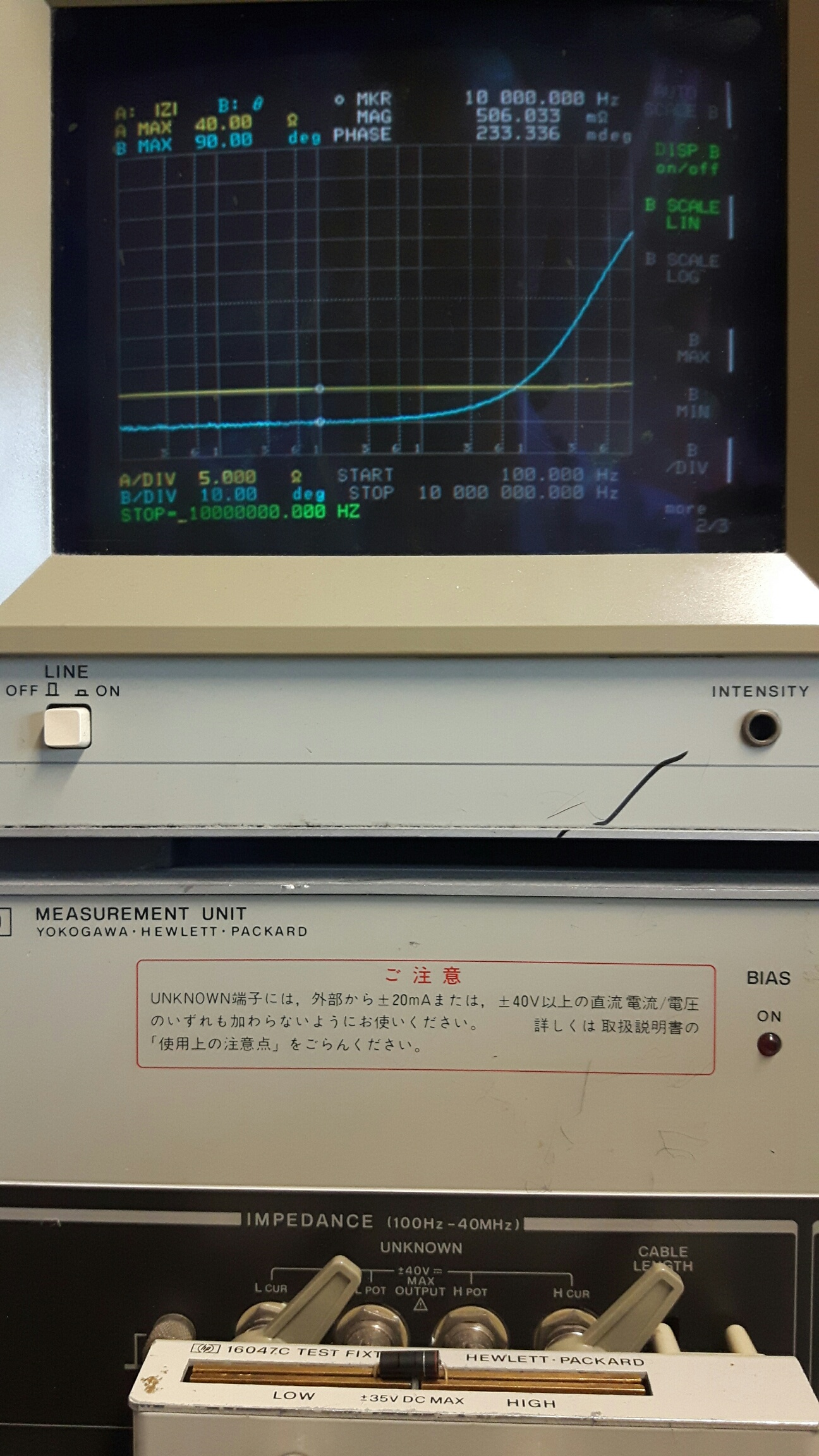

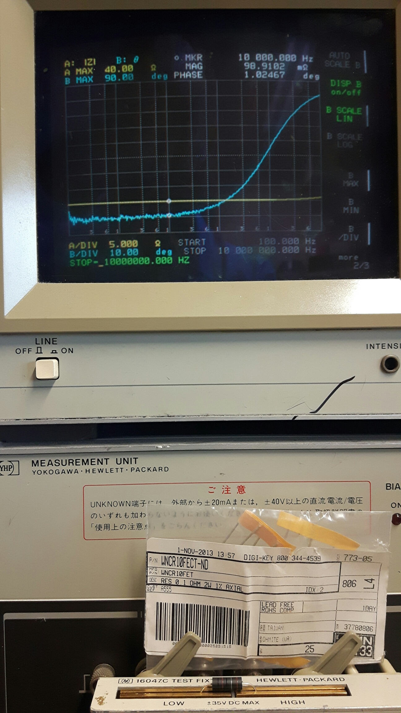

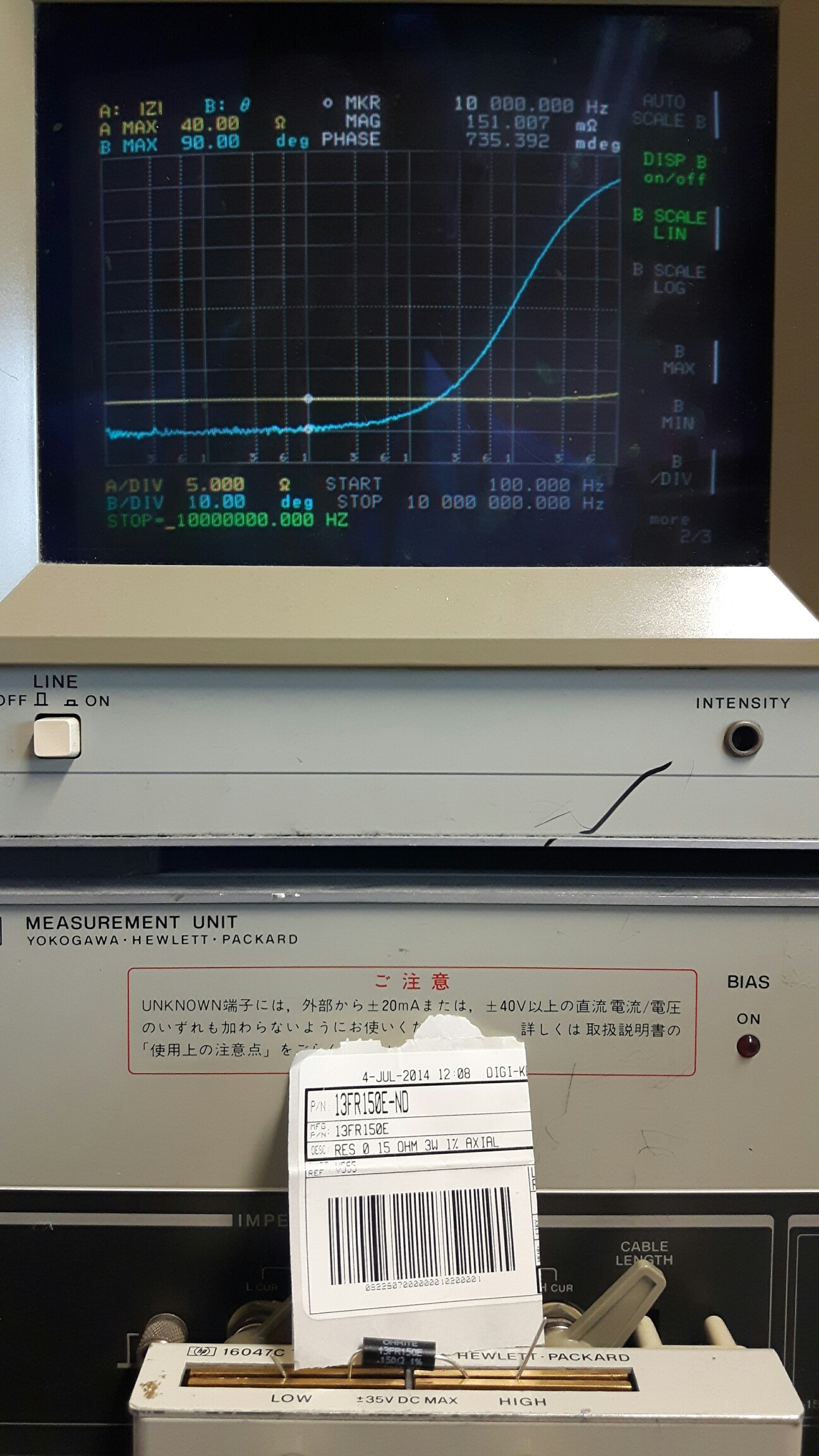

Did a quick scan of some more, the ones I found in my drawer. Dont have time to detail them, just look at the pic's name for info.
Generally the lower the resistance the more inductive it becomes (if same construction). Most 100ohm resistors are pretty much 100ohm up till way high, less than 100ohm they tend to become more inductive, above 100ohms they become more capacitive. The parasitics are relative to the resistance, a 1inch long resistor is about X much inductive and as the resistance gets lower the inductive part starts to show more and more, capacitive its the same, starting to dominate as resistance becomes higher.
So some of the 100mohm and 50mohm resistors measured here are pretty good.
