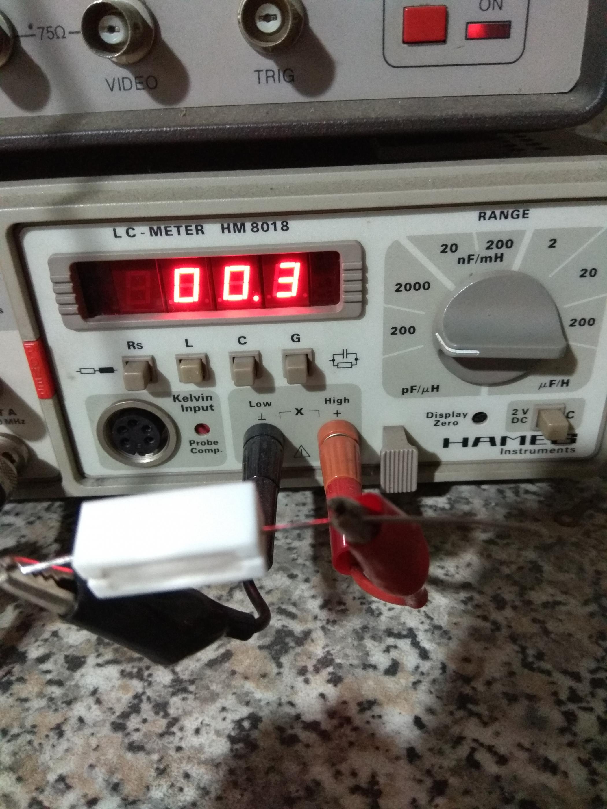

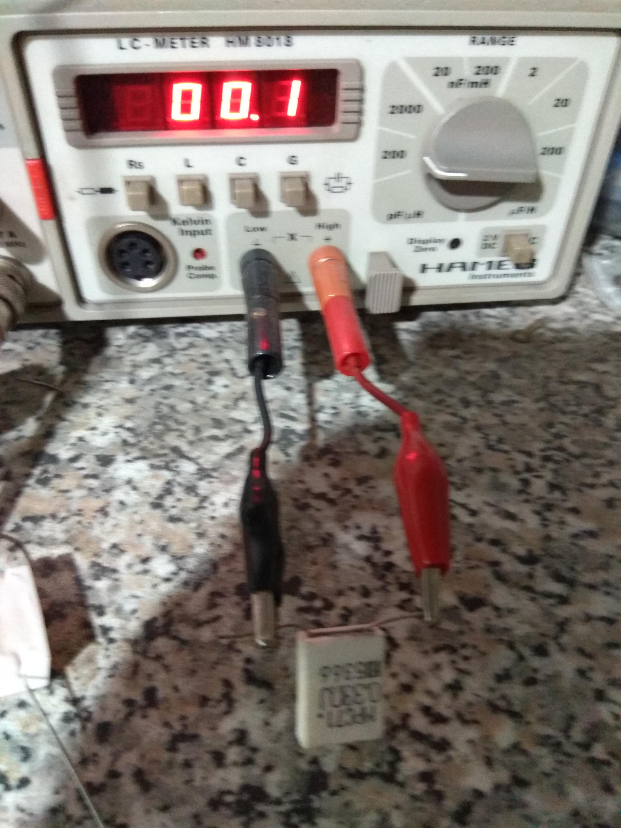

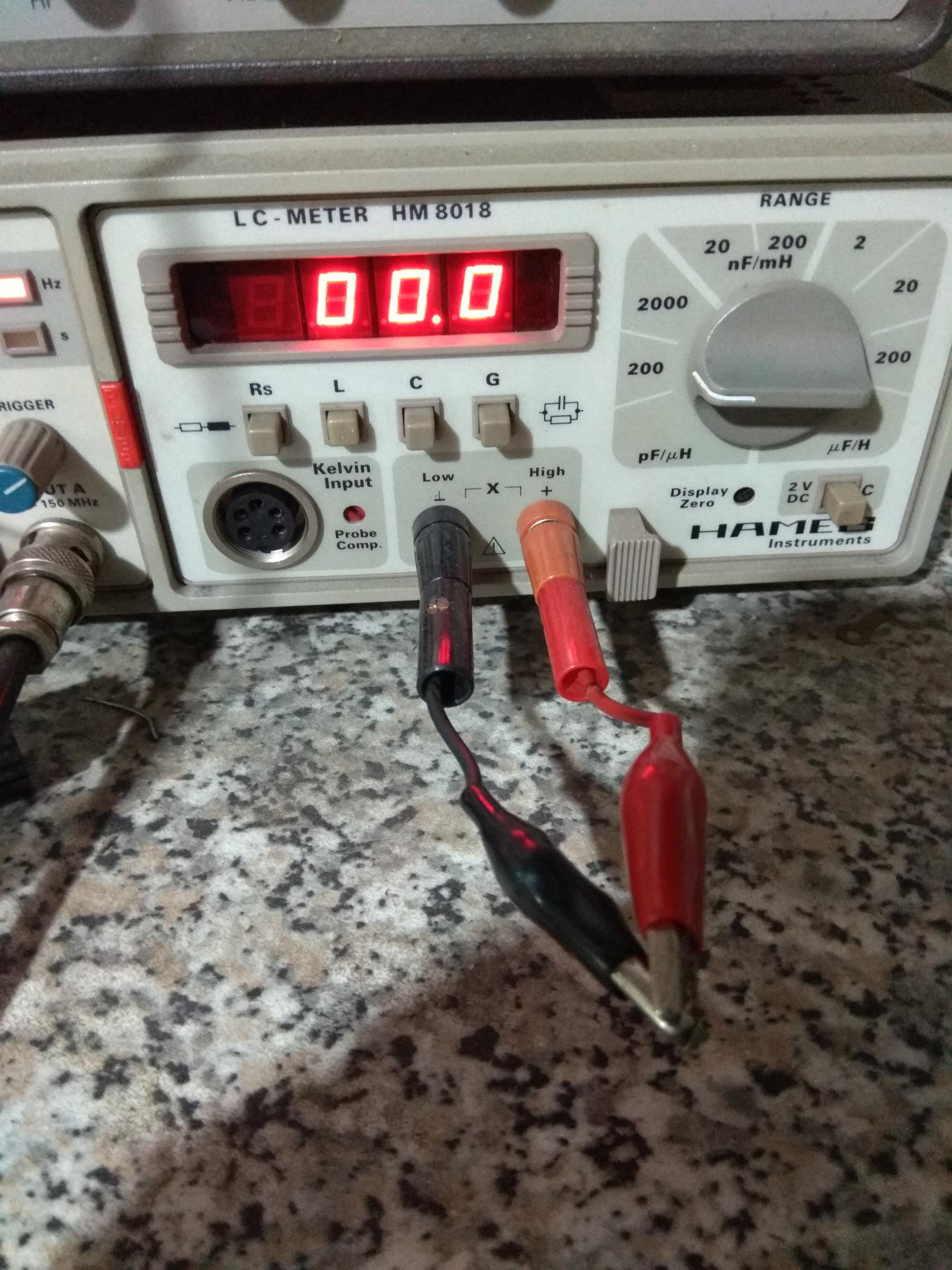

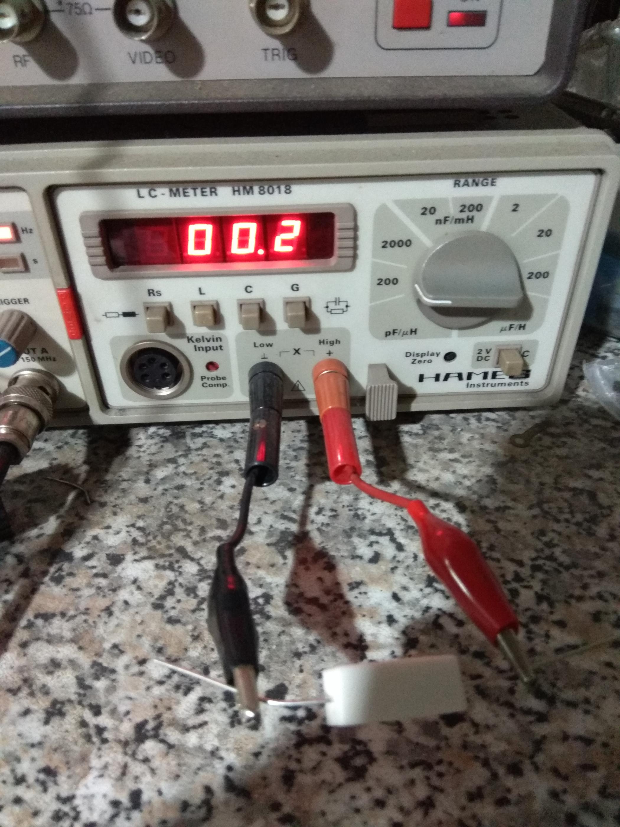

Has ANYONE measured a typical emitter resistor L (say a 5W type) ?
Here you are.
Oh no!Thimios, did you zero out the lead inductance?
New measurement.
1)zero out the lead inductance.
2)inductance of a common wire resistor.
3)inductance of an audio grade resistor.

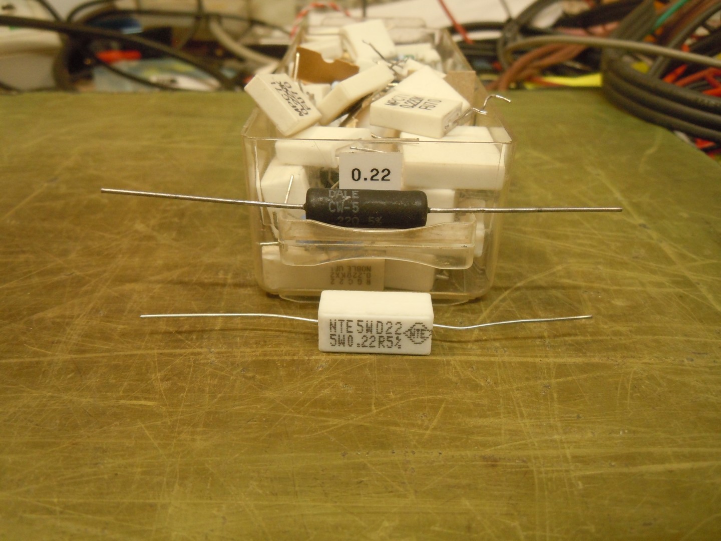

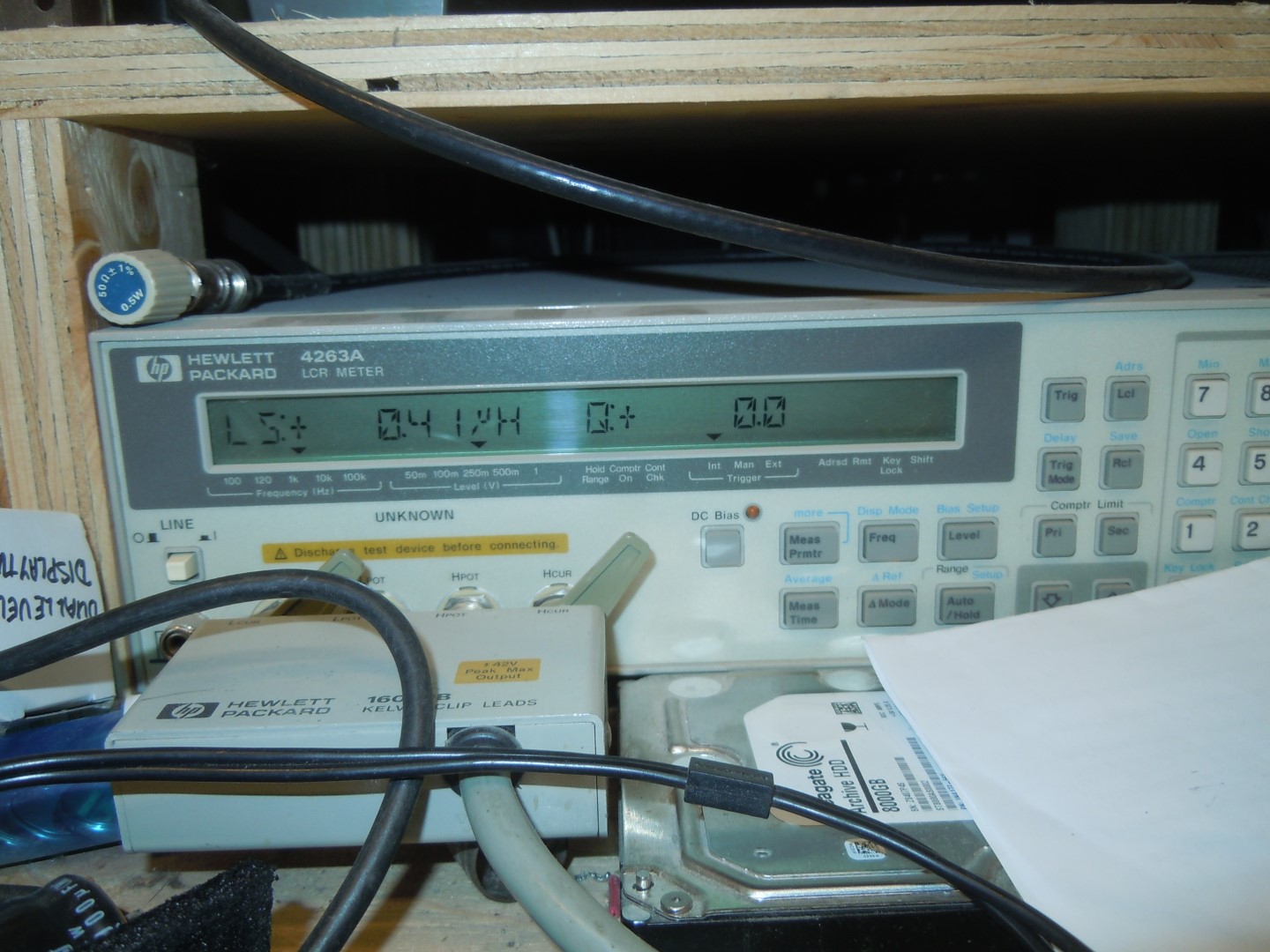

Dale CW5 0R22 @ 1KHz - 0.15uH, NTE 5W bathtub 0R22 @ 1 KHz - 0.41 uH using an HP 4263A. BTW, the 5W plate resistor under the same conditions measures 0.01 uH.

Your Dale CW5 0R22 @ 1KHz - 0.15uH, NTE 5W bathtub 0R22 @ 1 KHz - 0.41 uH measurements are in the same range as Thymio´s measurements of (presumably) 0.33 ohms - 0.2 uH so I agree with you on that.
At the same time I find that inductance value very small and significant only well beyond the Audio range.
I had already used thymios´ measurements and found (assuming 0.33 ohms) that inductive reactance reached that value at some 260 kHz, what makes me consider it minuscule within the Audio band.
I know, they are inside the loop but are neither the whole load nor the whole NFB so I find any design which is readily compromised by that, a very poor one and so not a good example that special low inductance emitter resistors are THAT critical, at least not everywhere.
Notice the short resistor leg stubs shown (clips seem to grab them about 1 cm from resistor body) *already* show around 0.1uH (since zeroing meter substracts that value) , compared to that I must find the "cheap" one surprisingly low inductance indeed, even not taking special measures against that.
