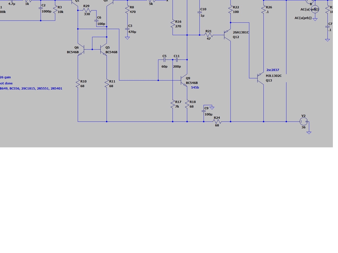

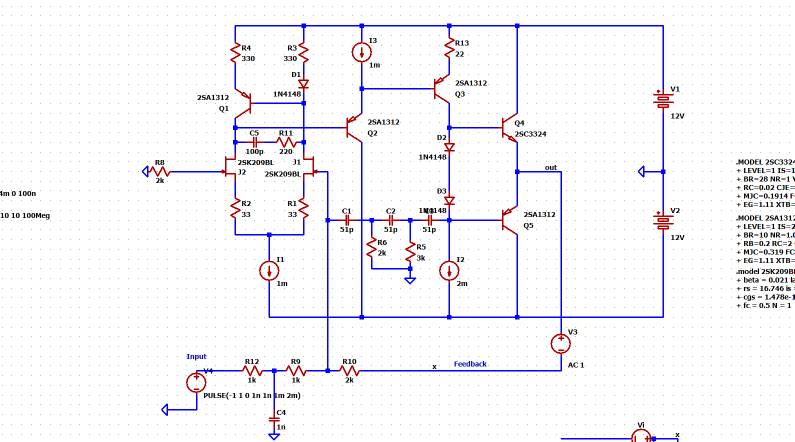

Could somebody hint on a good way of doing this in this amp? I'm afraid wild guessing could create new problems with impedance between stages or similar?

Yes, this point named as "dominant pole freq" and usually formed at the output of VAS stage by placing small ~100-150 pF capacitor around base and collector of the transistor.
This type of correction are not good today.

I took a look in Self's writings, and the 2-pole compensation he showed seemed like a fairly easy thing to try too, except I need to order some new caps for that.
Yes, but feel free to try it as 3-pole like attached.

Keep in mind simple rule. OPS have limited bandwidth, always the less - the better and easier. Any feedback depth at, say, 20 kHz need to fall to -10 dB point at some freq.
Let's pick 60 dB feedback depth and calculate.
1-pole = -20 dB/decade. So -10 dB point will be somewhere at ~60 MHz.
2-pole = -40 dB/decade, -10 point somewhere at 3-5 MHz
3-pole = -60 dB/decade, -10 point somewhere at ones of MHz.
Yes, it is not so straight, but the principle.

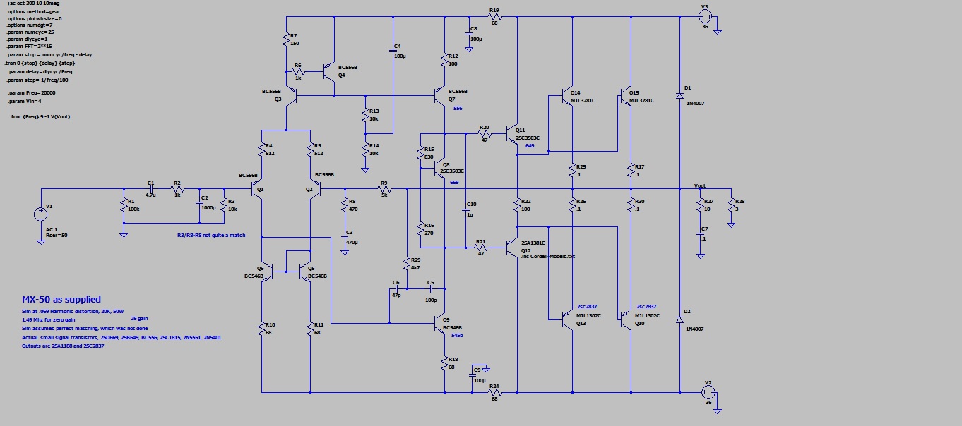

The L12-2 amp I'm playing around with actually had double CFP outputs from the beginning, and I changed it to double EF. I used the MX50SE simulation I found on the forum since it is essentially the same amp, but it had only one output pair.
However, I agree with you that my simulation is far from reality, it does not have the correct transistor models. However, I think simulation helps me to understand what I could try to tweak, and what effect it will have.

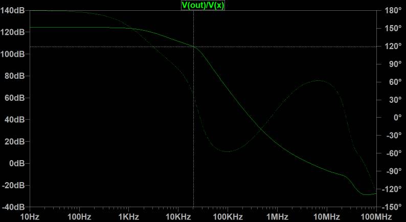

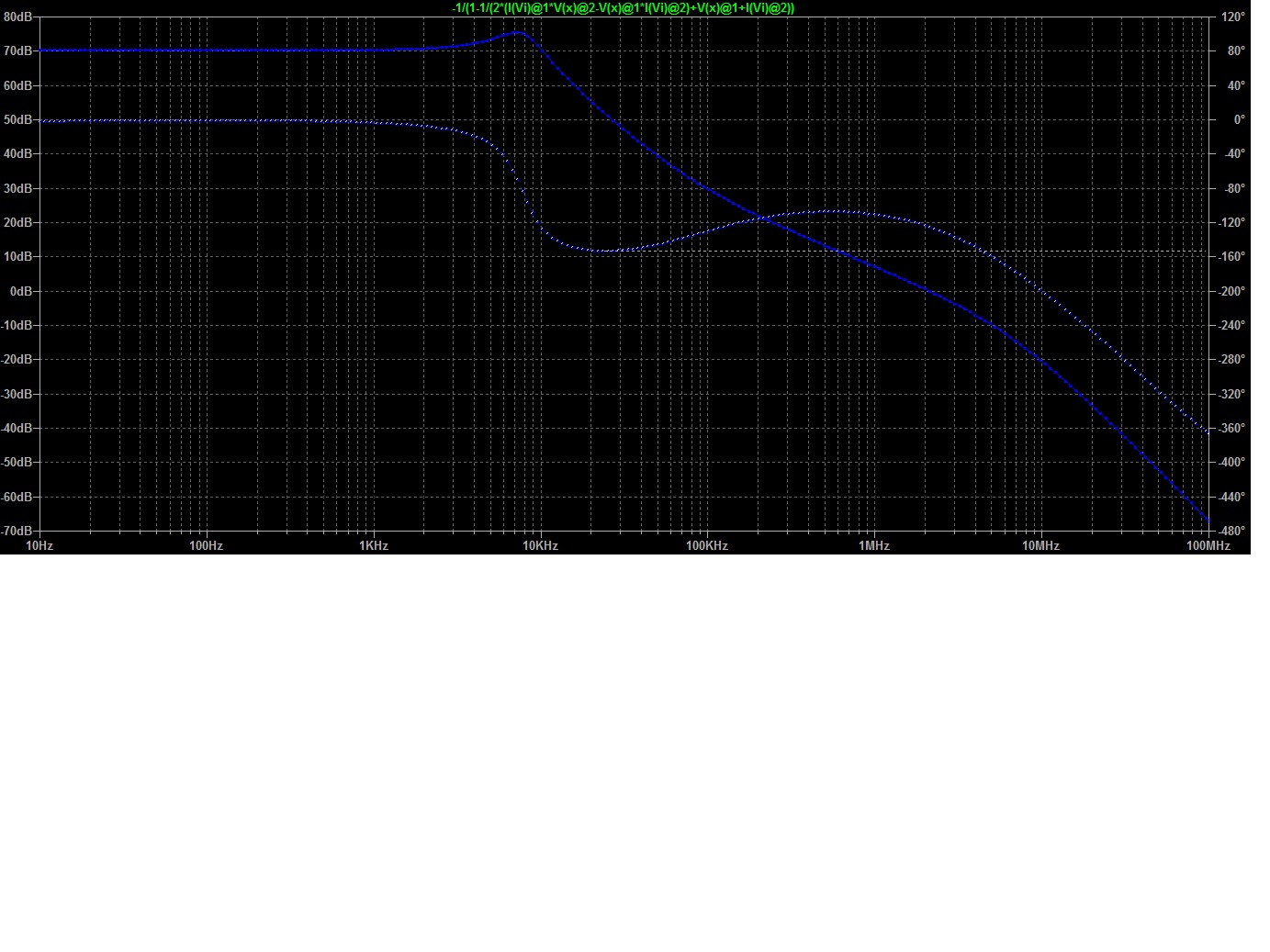

If I understand the 3-pole graph correctly, it seems there is 180deg phase shift and abt 40dB gain around 30kHz? Is this not a problem?
@BesPav
No.
Until gain fall to +10 dB phase doesn't mean at all.
The only region of interest in terms of stability is a +10 : -10 dB.
Here phase must be somewhere inbetween 120 to 170 degrees.
You can read more by searching for "phase margin" and "gain margin".
Right. This is best understood using the Blake and Collins abacus.
And the phase margin we are talking about is the the loop gain.
This is not that easy to measure because it is not as simple as opening the loop. At the point the loop is opened one must maintain in and out impedances at the operating point.
This is easy to simulate using a Tian probe, a better and easier alternative to the Mittlebrook method.

Thank you for clarifying! I have read some basics on phase and gain margin, but only the phase at 0 gain and gain at 180 phase. I thought the phase margin was valid all the way from low frequency up to 0 gain, and then gain should be below -12dB (?) when phase finally reached 180deg. I guess it was only covering single pole compensation.

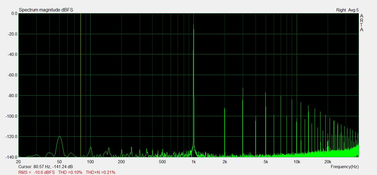

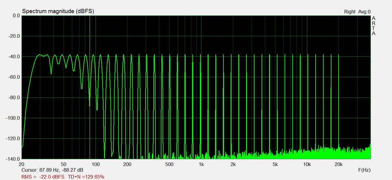

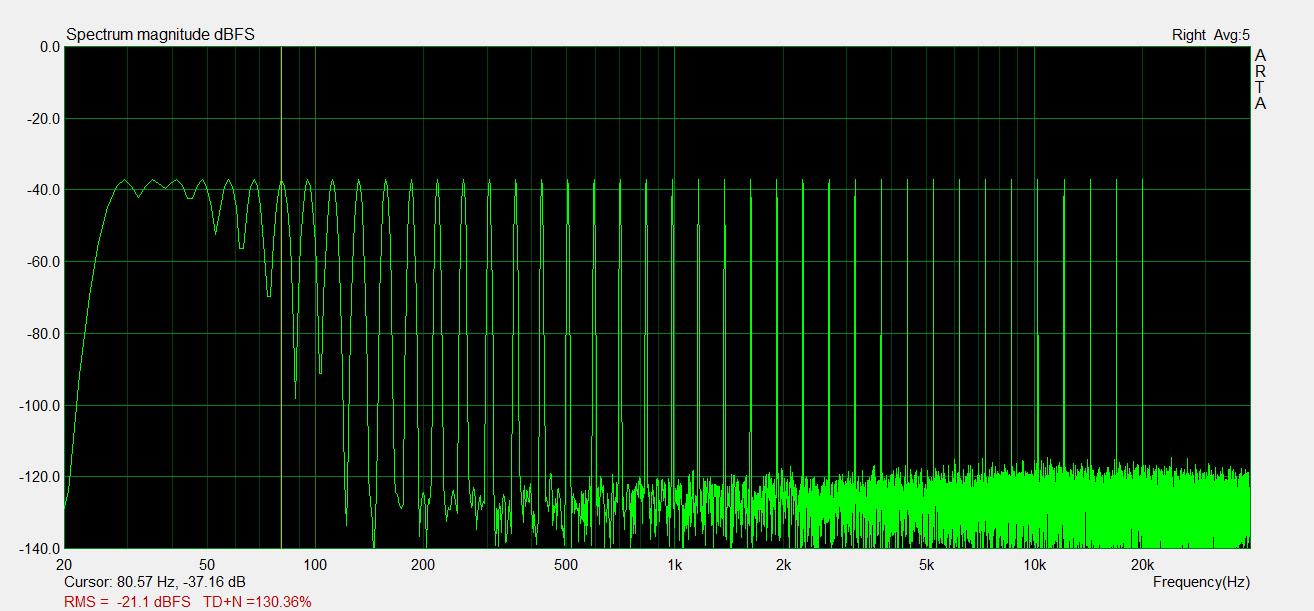

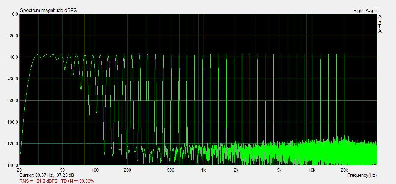

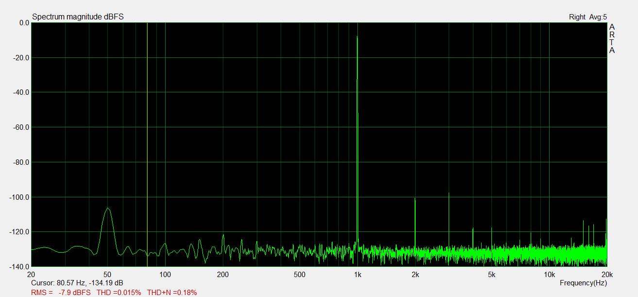

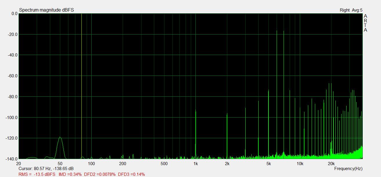

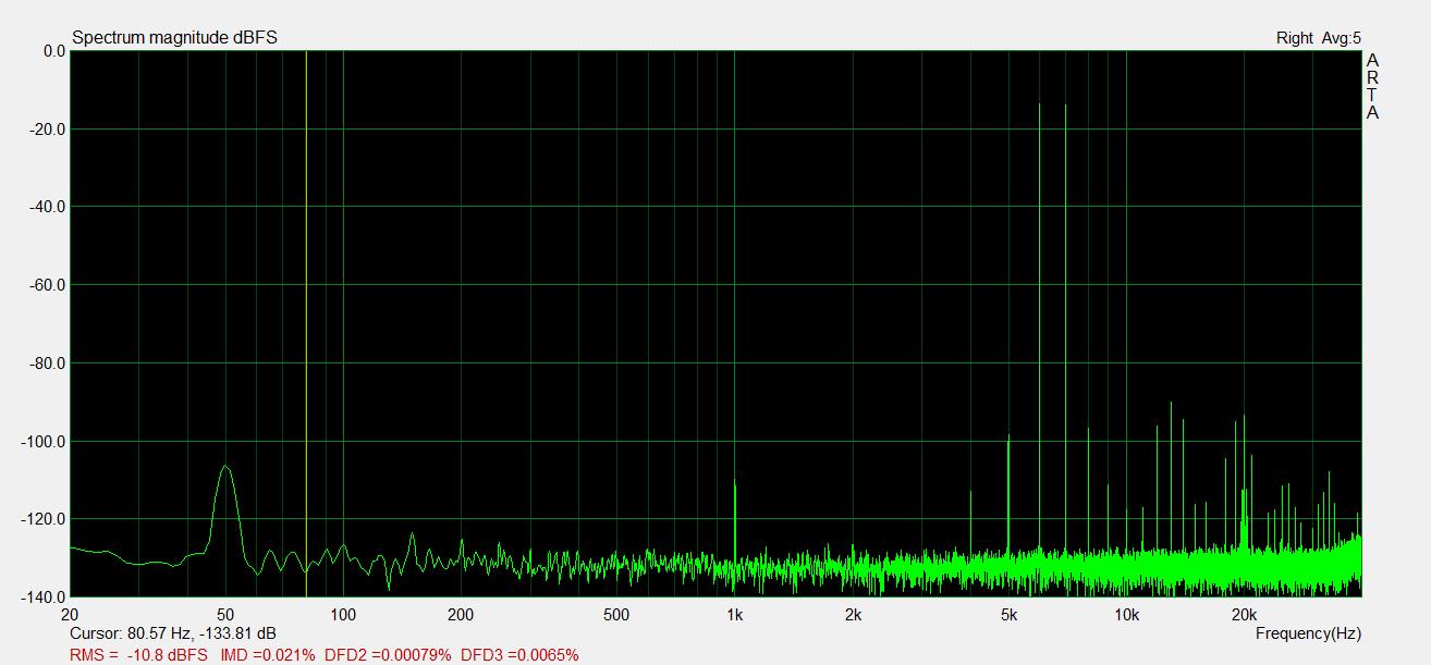

I did some playing around today with different miller cap values, and I could not really see any difference running multitone and FFT in ARTA. Actually in some cases there seemed to be more 'grass' in the +20kHz area with a smaller compensation cap, even if the amp seemed stable. Boosting Iq generally makes much more difference IMHO.
I also did some really quick and dirty test with TMC, and did not see much difference either, except some small improvements with what I would call 'under-bias' where high orders of distortion was still visible above -110dB. The high orders were slightly lower with the TMC. However, this was a really unscientific test.
I did a quick test test increasing the current in the VAS by parallelling the 150ohm in the CCS with a 300ohm, and it did nothing to the positive peak, but it did improve the rise time from 24V/us to 38V/us.
Doing some simulations, I have reduced the OLG to 57dB by using 500ohm emitter resistors in the IPS, decreased feedback resistor to 5k, increased current in the VAS to 6,3mA (nicer rise time) and TMC compensation. In this way I get OLG almost constant to 20kHz, and it simulates as stable.
Are there some more things I should think about/check before going ahead with this?

I went ahead and did the mods above, and it seems promising. There are some minor oscillations and wrinkles on the flanks with low Iq though. There is no peak any more, I'm starting to suspect only one channel has this, and the one I modified and tested today might not have had it from the beginning. Will see when I test the other channel after it's modified.

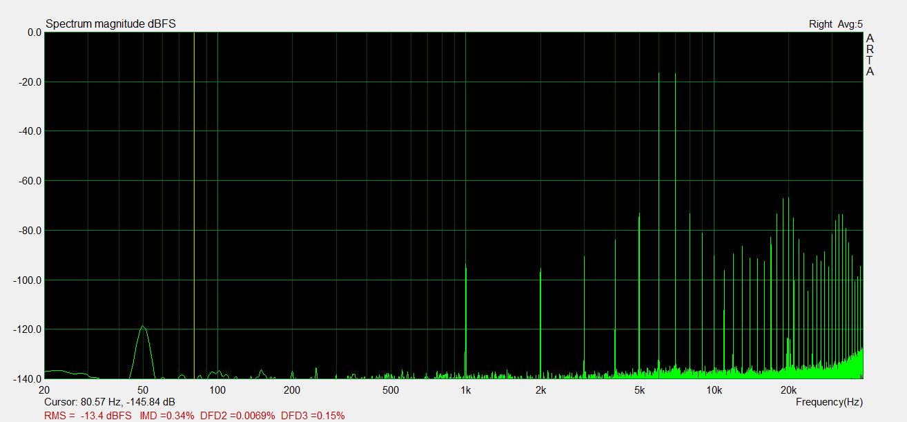

When it comes to distortion it seems to bee similar to before. A little bit more 'grass' visible in the top octave with multitone, but if could actually bee that the (THD+N) floor is lower in the lower part of the spectrum.
Finally I have something to try and listen to.

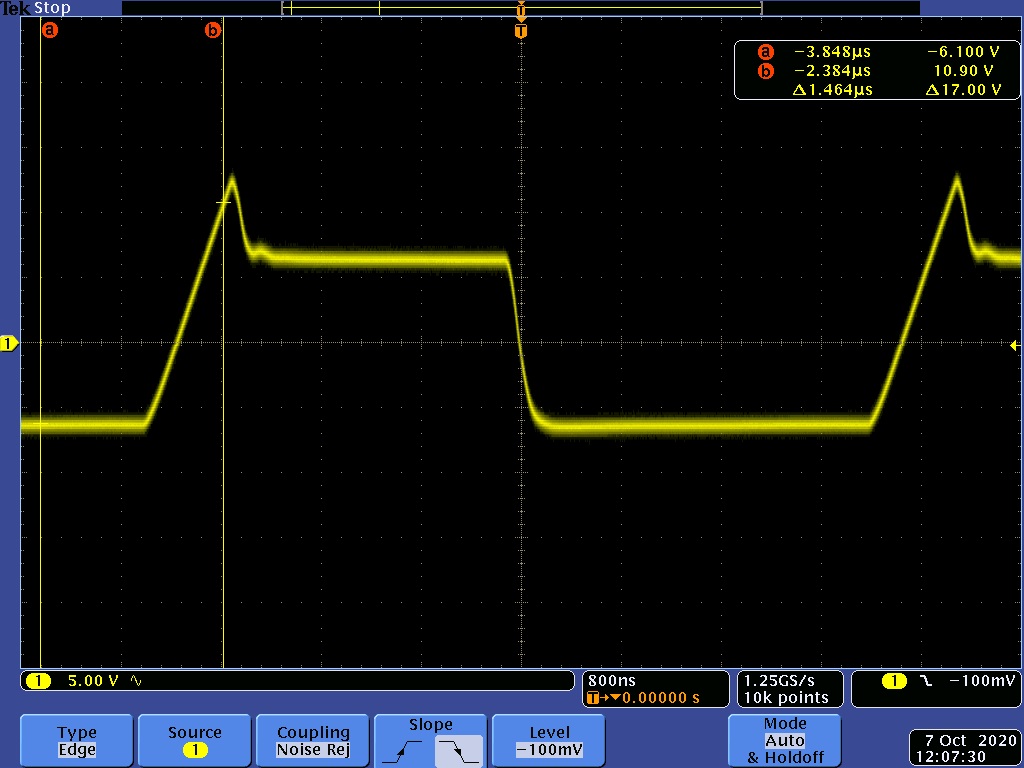

Both channels behave the same, and the square wave response looks nice too.

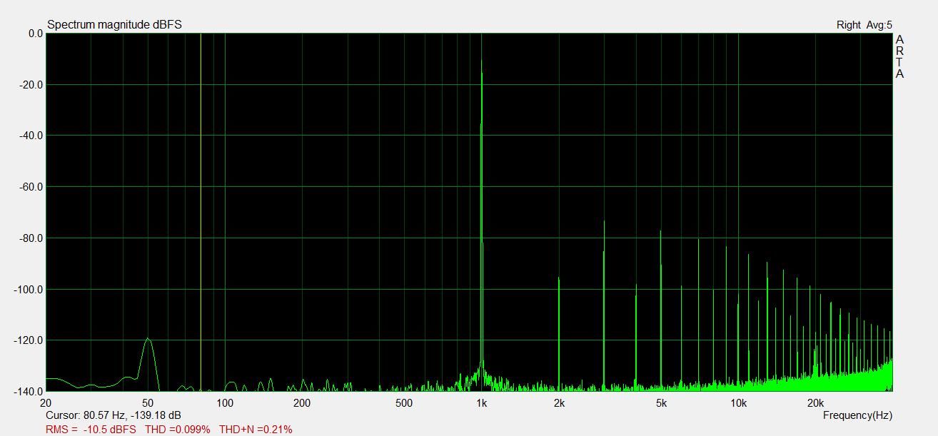

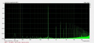

Iq needs to be around 0,35A (per channel) for best FFT, then it's only 2nd and 3rd harmonics visible around -90dB, some higher harmonics become visible at high output levels around -100db.
Also looking at the square wave flanks before, I came to the same Iq setting.
I set it at about 0,4A because the bias is overcompensated with temp. I guess higher values on the emitter resistors would stabilize this, but I want to run high Iq to have some class A power for normal listening too.
EDIT: emitter resistors are 0.1 Ohm in the model, but they should be 0.15.

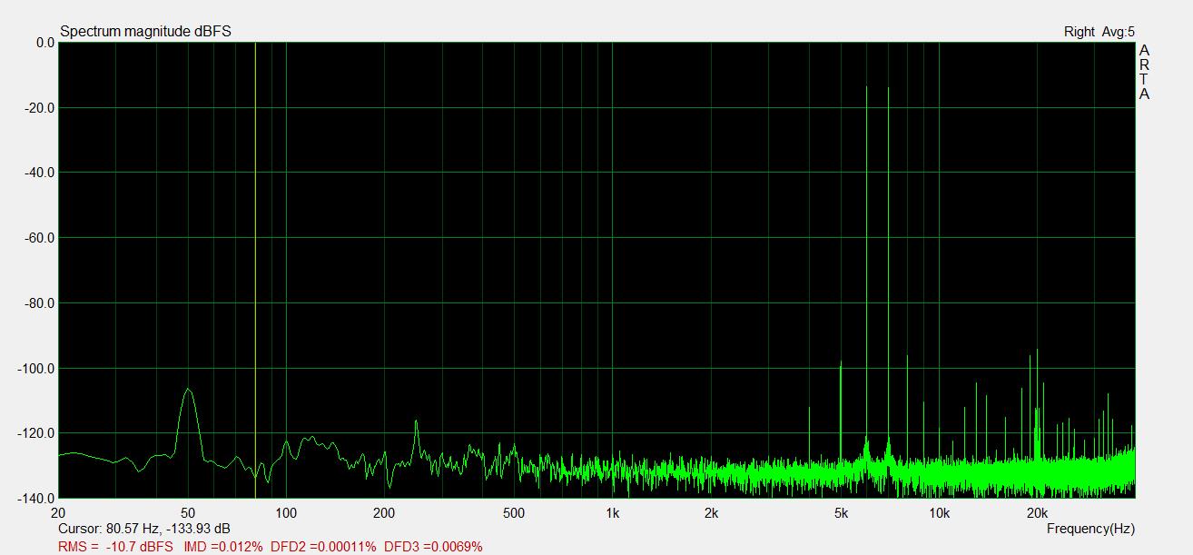

After some initial listening I'm already convinced, I definitely like it better now. Now I want to put these boards in a chassis and actually use them for something🙂
The Iq unstability is a bit disturbing though, but I guess I can live with it. The initial Iq at startup goes to abt 1A when it's cold, and then settles around 0,4 after warming up. On the bright side it quickly brings the amp up to working temperature 🙂

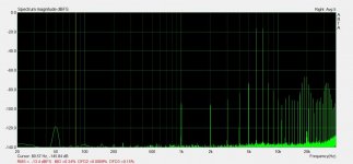

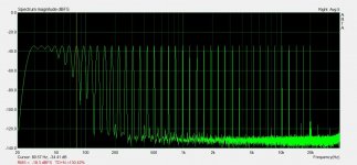

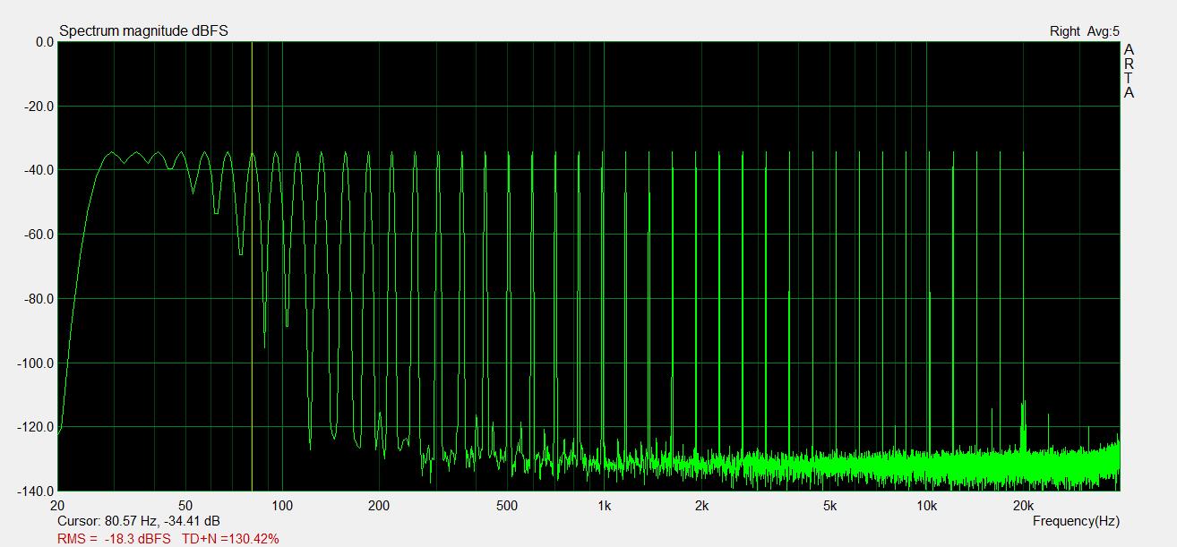

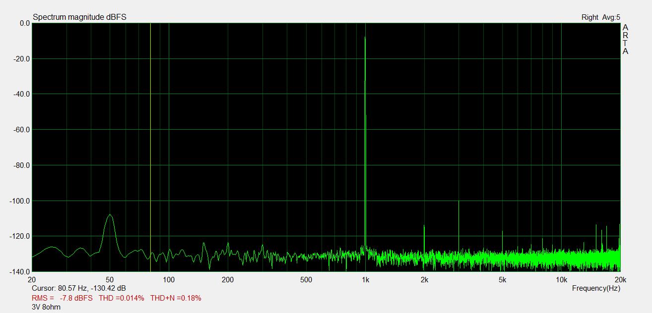

I have done some listening and measurements. Sounds good at low levels, but as measurements show, it gets a little bit rough on higher levels. I tried a cap over R22 too, but could not measure any difference. I think this is the end of this project, but the concept of high bias class AB intrigues me, so after some looking around, I ordered the hifisonix kx PCB's (and one blameless) from Jim's audio. The sx would have sufficed for my needs, but I read something about problems sourcing components for it. The ks is a bit similar to this (double EF pairs, high bias, TMC compesation..), but properly executed 🙂
