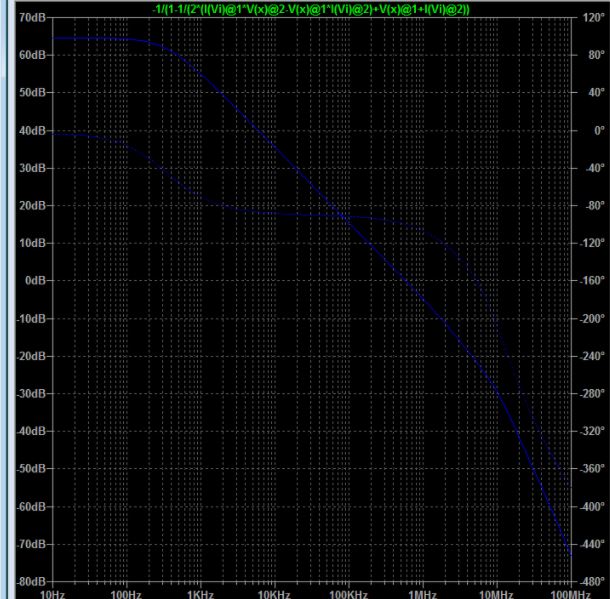

If you decrease the closed circuit loop gain this pushes the feedback gain to out to a higher frequency where this declines to 0dB - depending on proportions getting further away from that designed into the compensation scheme. You don't have to go there.
If your DAC has too much gain attenuate it with a resistor divider network.
your actual OLBW is simulated at post 6 is
required OLBW is

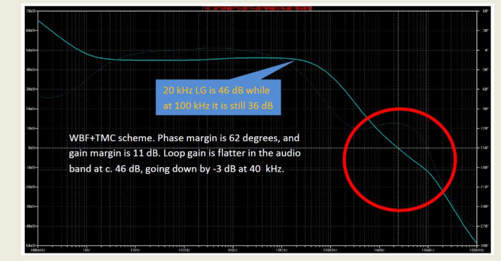

See design example of high quality amp
Ovation e-Amp: A 180 Watt Class AB VFA Featuring Ultra Low Distortion

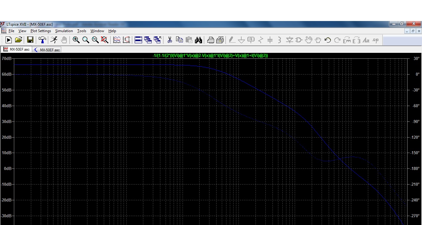

I modified the schematic to better mimic the L12-2 with double outputs better, and some resistor values for current sources etc.
I changed the existing compensation cap values to 0, and then tried a cap over the feedback resistor (which I also changed for lower gain). Suitable cap value seems to be around 5p. This gives better OLBW , and as far as I can understand it stays within the recommended margins? -So in theory it seems to do the trick.
How about in practice?
I have seen some advice against this, so what do you say about it, if RC and LC is used on the output?
The transistor models in the simulation are not correct, so I need to find replacements to simulate this correctly, or just try it on the boards..
Sorry about the bad screenshots..

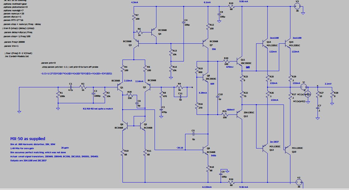

The root of your problem could lie in the LTP driving the Vas into saturation. The values of R7 (100R) and R12 (150R) suggest the standing current in the LTP CCS is higher than in the Vas CCS. The values look to have been transposed but if not they would have to have been plucked out of the air.
Would this be a problem only at high output/clipping?
I adjusted those values a bit according to a schematic I found for the L12-2
Have you considered making R18 zero? You will have to reduce R10 & R11 a lot, say <20 ohms. Keep the Miller cap 100pF.

You can see from this that your values for R7 and R12 at 100R and 150R respectively are transposed. Somewhere later in the thread a contributor increased R12 to 220R.
The effect of increasing R12 is to reduce the Vas transistor current and the gm of the stage which is roughly 40m Siemens per m.a. A race car does not run better if someone puts 91 Octane in the tank by mistake.
Another thing to keep in mind is that the CFP stages have better thermal stability than EF2 stages as these have two forward biased emitter junctions which will conduct more with temperature increase and care is needed with the Vbe multiplier.

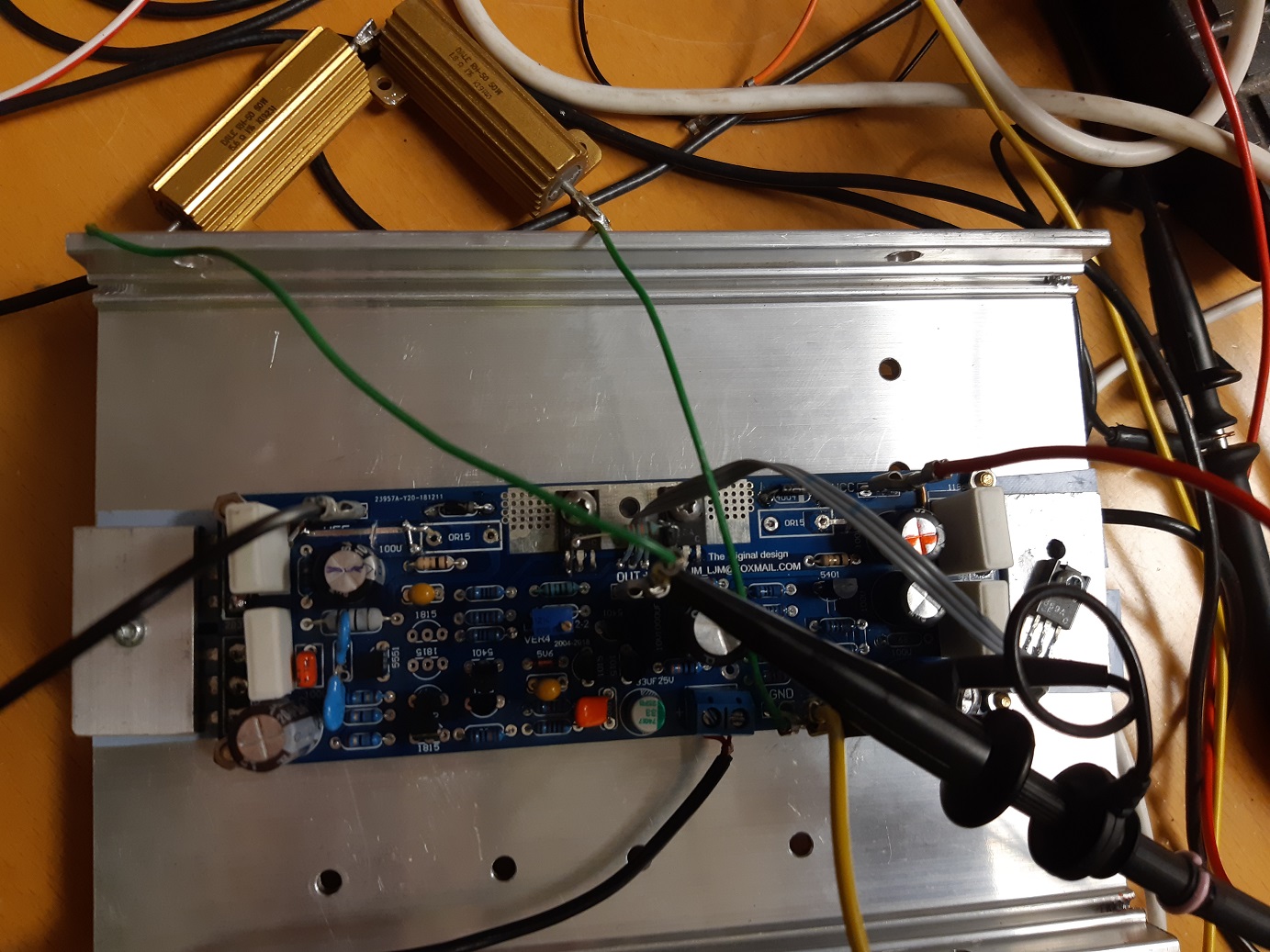

I have a adjustable dual 24V current limited bench supply (max 1,5A) and a good scope at work, so I try to use them for powering up and doing experiments (when I have some dead time at work).
After initial tests I can take it home and do distortion measurements and listening using a 30V linear supply.
I actually did a 'quick and dirty' now: replaced the feedback resistor with 5k, and tried some small caps I had from before. 6,8p across the feedback resistor and no miller cap is a no go. Also 6,8p as miller cap is a no go. Using two of the standard 100p in series (50p) as miller cap seems stable. I need to wait for the caps I ordered to find the 'limit'.
