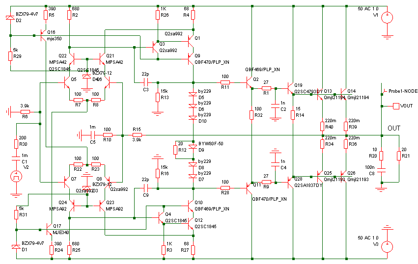

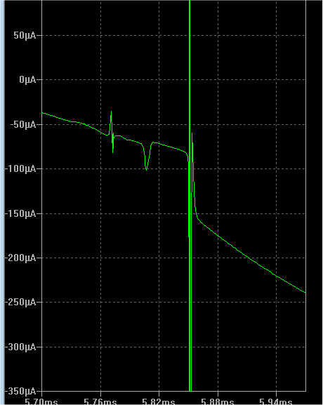

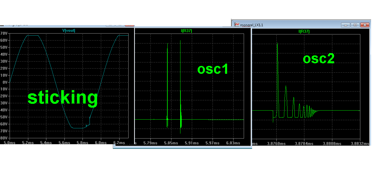

(below 1) is what happens both in simulation and on the real one. Clip the amp , predrivers saturate - "stick" , producing oscillations. (below 2) is how the OEM's deal with this "behavior". (below 2 - #1) is the APT , it is actually the only perfect solution .... diode clamps stop saturation and eliminate "sticking". APT's OPS devices are also low Ft , further mitigating any bad "behavior". #2 is the HK triple , no clamping .. this amp will "stick" (saturate). HK uses a inductive filter at the bases of the outputs. A driver B-C zobel network will do the same thing, as I will show later. #3 , JVC uses separate driver/predriver decoupling (in Cordell's book) and a B-C shunt stopper on the predriver.

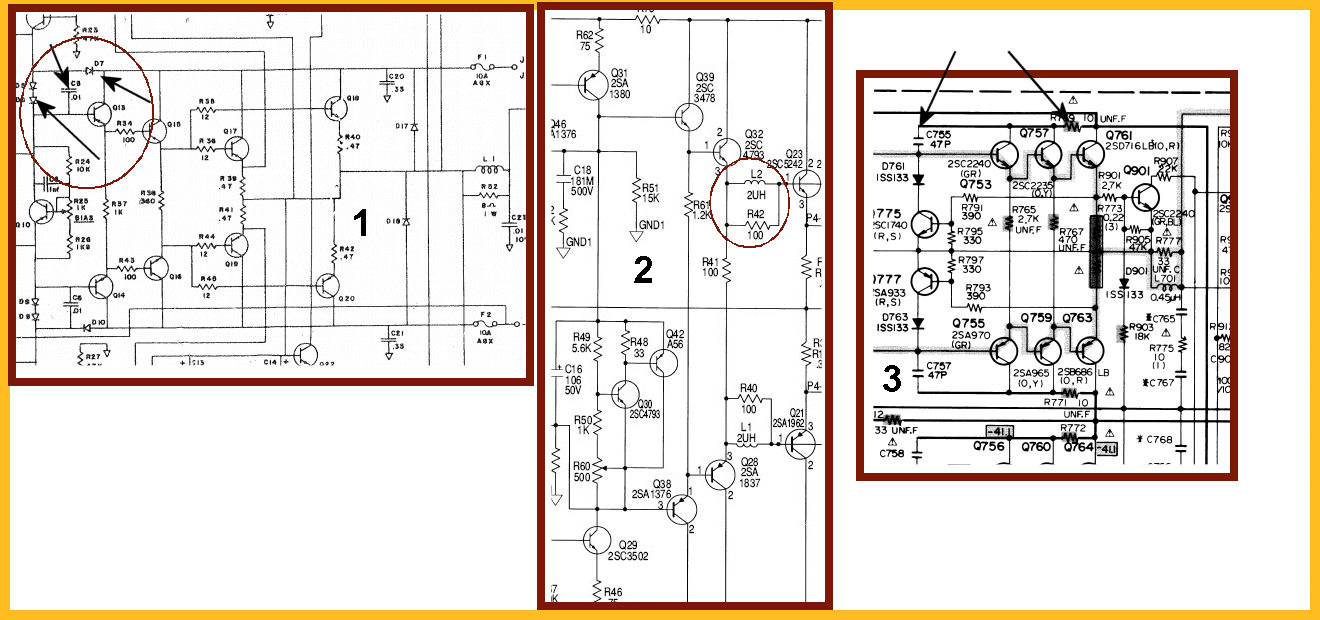

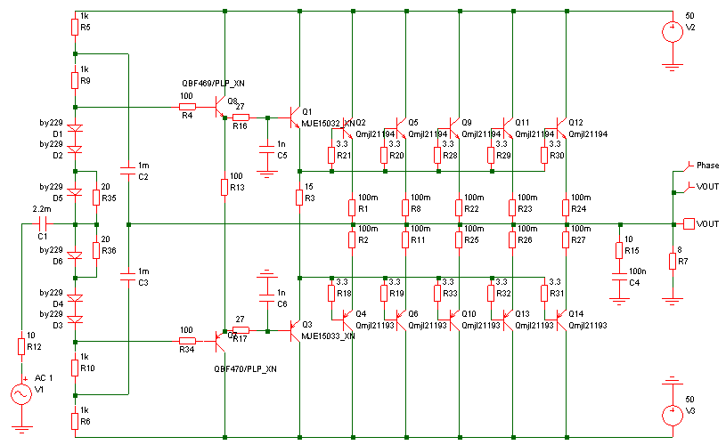

(below 3) is the best combination of "tricks". I show Cordell's "DBT" , but this can be applied to any triple. (below 4) shows worst case severely clipped former oscillation very damped by the combo of decoupling and zobel. An EF2 will also exhibit these errata's if high beta (2sc4793-2sa1837 + mjl4302-4281).
The MOSFET's are nice , I have 2 pair of the original Hitachi TO-3's (K134-J49). Actually used a MJE340/350 pair as drivers and 470R gatestoppers - worked first time... 🙂. For a permanent solution , I would choose 2sc4793-2sa1837 and 3 pair K1058/J162.

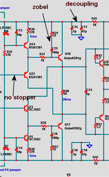

Update. When I mentioned that speakers sounded different, it was because I had hooked them up to my Marantz PM7000 for a quick listen. Well last night I swapped the speaker connections over on the Marantz. Turns out the speakers (after the bass unit replacement) are 100% ok. It's the Marantz that is playing up. Looks like this new house I am in is jinxed for amps!
I'm curious as to what led to your amps blowing up and what's affecting your Marantz. Is it something in the Mains Line or perhaps high RF?
Ostripper,
I have exactly the stability tricks you point out in my amp. Without the base networks and the decoupling, the triple is not stable. I've looked at quite a few options here and how the driver and output behaves at HF. Bob proposes a Zobel network across the base and collector of the driver. I used an L section in the base of the driver. I also found that at HF (hundreds of KHz), a large speed up cap across the pre drver emitter resistor helps reduce cross conduction in the driver stage. So, there are actually two distinct problems to deal with here (they may be linked, but that would need more work to prove it). I have tried the ferrite in the bases, but my selection was linked to what was available in the sample bin. On sims, it seems to offer some real benefits, killing HF instability and dealing with cross conduction.
Re the mosfets. Yes they are also prone to instability but my point was they are simpler to use in an output stage. Probability a straight gate stopper and good rail decoupling will be enough.

Wahab,
You need to read the accompanying notes for the detail. The boards are a little different to the schematic. I probably need to update it and post it up.
The 15k resistors are shown on the circuit. They were removed long ago from the board (three years ago in fact). The output inductors were rewound for 2uH, again long ago. Some people recommend removing the inductors or going with a very low vale like 1uH. Because I am using slow output devices, I was concerned with possible instability into cap active loads. The inductor Value I selected is therefore 2uH.
This design does not use a mirror loaded LTP so the tail current has been deliberately set to 5mA per side. With the degeneration and comp caps shown, the amp is very fast (ie slew rate) and is absolutely TIM free. These were the design goals.
Re the standing currents in the VAS and pre drver stage. If you do a sim into worst case load conditions, you will see that running these stages hot helps the performance. I also had a brief exchange with Bob Cordell on this forum, and he apparently also likes to run his pre and drver stages hot, though not quite as much as me.

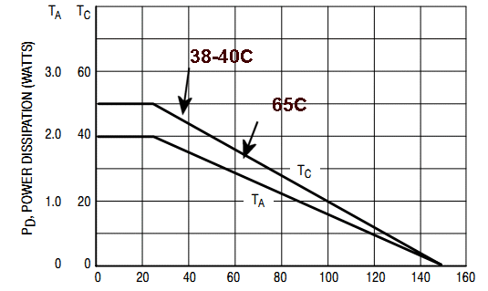

I don't think running cool necessarily translates to longer life. There are many applications where components routinely at high temperatures for extended periods. Modern semi's are fully characterized for this kind of environment. The VAS and pre-drivers are on heatsinks BTW.

I just took a look, my comp caps are shown as 22pf on the circuit and are 47pf on the board.
Re the temperature. All the components pass Bob's finger test, so nothin is above about 65C.

Re rail sticking. This amp does not have this problem and exits clipping cleanly and without any parasitics or sticking. The biggest cause of at king in most amp is in the mirror and/or if slow devices are used in the VAS stage. The Ovation uses resistive LTP loading, so no sticking there, and the VAS amp is cascaded with BF4xx devices which are very fast and come out of saturation very quickly. My first design about 10 years ago used MJE350/340 and a single ended mirror loaded front end and this had a lot of issues similar to the ones you show Ostripper. Only way out was to go to fast VAS devices and to use anti saturation diodes.
Not to be contrary , but it does. Google "semiconductor MTBF vs. temperature" and you will find this not only to be true , but some manufacturer's actually specify the temp./power derating vs. the MTBF in graph form.
SOA also is greatly reduced with high temperature . 🙁
As a secondary consideration , greater heat produced by the semi's will also shorten the life of the passive components that share the same enclosure.. Electrolytic's are also derated (hrs. @ degrees C) according to operating temperature. A MJE15032's Pd increases by 50% from 65C to 35C (below).

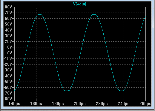

"Sticking" , I have only seen in simulation and heard it mentioned in the forum. On a CRO , I never have seen the errata observed in my previous plots. I may even be chasing "ghosts" here. I downloaded Cordell's models (below) for the ON/fairchild devices and now my simulations are much closer to the real amp. I may be actually overdesigning to compensate for bad models ? 😕
PS - below 2 , same triple ... but with cordells 1381/3503 models , clean clip

Ostripper, I don't doubt your info, but as I noted all my devices pass the BC finger test. Of course i agree on the SOA point. I worked in auto semis for about 5 years and an ECU regularly goes to 80 or 90 with individual comps even higher that this. If you look for example at automotive specified mosfets you will see they are characterized for extreme temperatures, and some parameters guaranteed to 175 C. The issue with high temp is mainly around the temp cycling that stresses the die to header interface solder and bond wire connections and one of the reasons semis for this segment go through very strenuous quake tests. A lot of that technology and know how, especially in companies that are involved in both auto and consumer, is used to impove overall product reliability. That said, don't ever exceed the data sheet ratings because an upshot of all of this has been that semis specs are very close to their limits - the tight process controls and device and materials knowledge mean suppliers have a good bead on the device performance envelope and spec accordingly.
