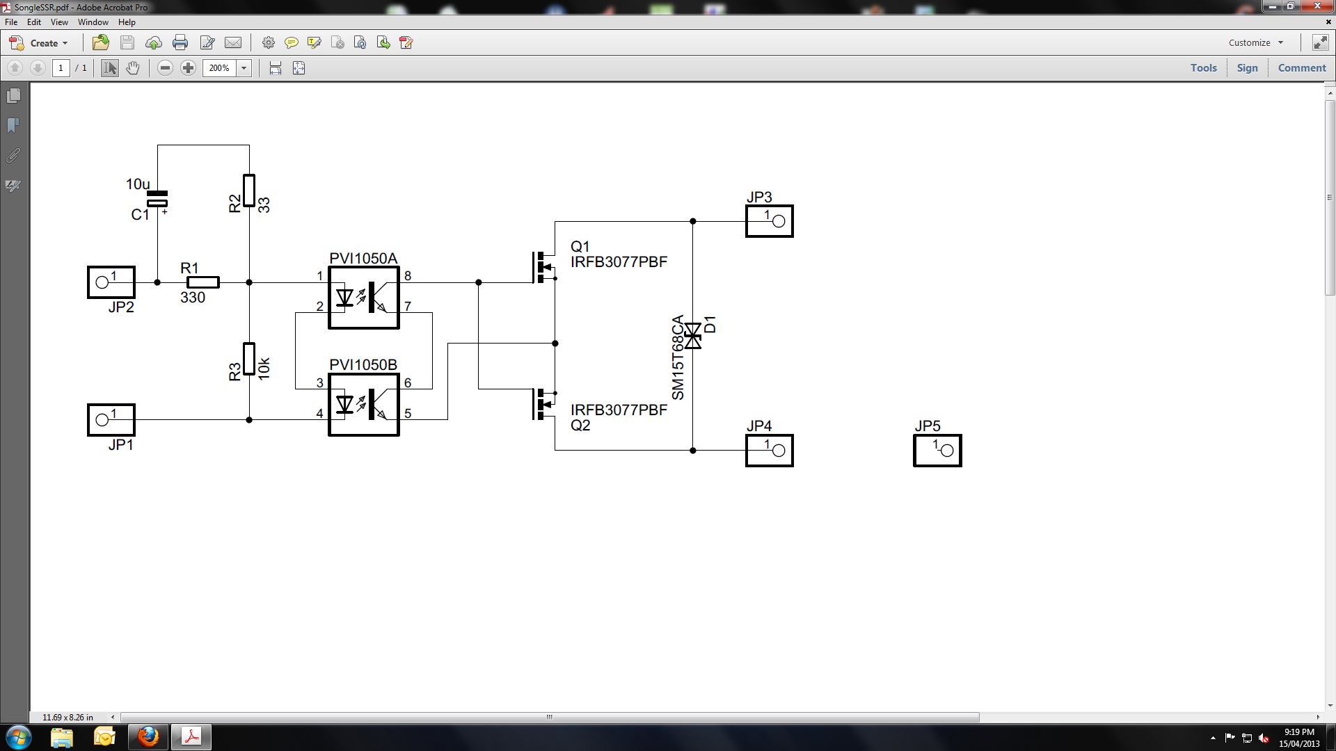

Here is the circuit and PCB layout for a solid state relay. This is just the relay part. There are a few notes on how to apply the relay.
Solid State Relay with PCB Layout
Hi Bonsai,
A very professionally produced document there 🙂
I notice you use two couplers in parallel whereas I use two in series to get a higher drive voltage for the FET's. I wondered (and I realise its FET dependent) whether worst case voltage output from a single coupler at around 7 volts was "enough" to absolutely fully turn a FET on when its passing its max drain/source current. In other words to get the Rds as low as possible.
Good point Mooly. I never tried the optos in series, only in parallel where I am looking for fast switching speeds.
The design shown here is basically what I am using in my e-Amp with great results. You need to use mosfets with logic level thresholds for the best results. Over driving them in general will give you lower Rdson, but for the devices shown using TLP191s total end to end Rdson is still under 15 miliOhm.
Hi Bonsai,
I agree the FET relays are great and I'd never go back to mechanical now, and using logic level FET's makes sense, the 7 volt drive should fully turn them on.
Excellent 🙂
(Have you tried... just for sonics and fun, using dis-similar FET's. One a low Rds and one a high Rds device to add purely second harmonic distortion ? It works well in simulation but I don't know how well in practice 😀)
Excellent 🙂

I've looked at the link you posted.
I'd still recommend you use a photovoltaic coupler - it solves the problems RE raises.
The on resistance of modern Trench mosfets means it's very easy to create SSLR that have end to end ON resistances of under 20 mOhms, and if you go for something like a PSMN4R3-100PS you can get it to under 10 m Ohm.
It's important that you use logic level mosfets for the switches.
Here are two write-ups you may also want to consider
Solid State Relay for Audio Amplifier
Solid State Loudspeaker Relays for Audio Amplifiers
I am using hot SSLR switching on my e-Amp and speaker ground return switching on my nx-Amp. Note that if you use ground return switching, you will have no protection if you short the speaker hot line to the chassis - but this is quite a rare occurrence anyway IMV.

And it can all be avoided by splitting the relay and putting it before the output stage.
jasonp4113 posted this within seconds of my post above; it illustrates pretty much what I'd like to do, except that I'm trying to use an N channel on the high side because I have heaps of cheapies in stock. Maybe I should just buy complementary pairs.
That's the desirable part.except that I'm trying to use an N channel on the high side because I have heaps of cheapies in stock. ........
Single N channel FETs in each supply rail with a cheap detection and triggering mechanism.

I use the Fet relay for some time now , I had great success opening the relay much faster with a serial capacitor in the LED circuit , not my idea , I read it somewhere , cant remember where but it works great !

SSLR distortion is about 1 ppm at 20 kHz. If you do a search on the forum you will see an AP plot that confirms this. LTspice sims show about the same level. Up to about 300 W it's almost entirely 2 nd harmonic. You won't be able to read it on an AP if you use low Rdson devices because the AP is good ably for about -114 dB.
A photovoltaic coupler is about $1.50 from mouser IIRC. I use two in parallel for fast switching.
Re on a fully turned on Trench MOSFET in the Vds range of 100 - 150 Volts is well under 10 mOhms. If you want low distortion, you need low Rdson.
Suitable mosfets are about $3-4 each from Mouser.
Your SSLR should not cost you more than about $ 8-10.
