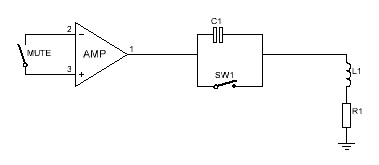

What kind of schematic do you need, it is a contact at the output of an amplifier in serie with the load and a capacitor in // with the contact.
What matters is clamping the load to Vcc with diodes to avoid glow and sizing the capacitor depending on the max current to be switched; If it is 60 amps use a 60 microfarads capacitor and you will still avoid arcing.

If the mute logic is operated, the output of the amp is zero volt, the capacitor discharges through the load resistance ( low) and then after a small delay, the switch is closed. Of course in case of failure, the logic forbids the closing of the relay
If the switch is open it means that the amp is muted so no leakage
DC detect operates and the switch is opened without arc for the reason explained (capacitor)
Current limiting in action, muting of the output, opening of the relay with a capacitor chosen for the limiting current

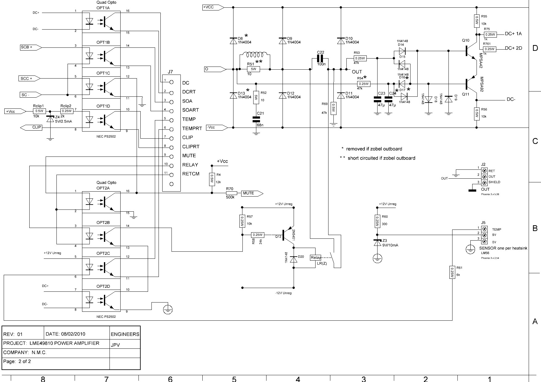

Here is my implementation for a ten amps system

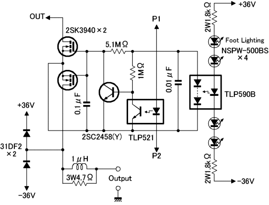

there are some examples of mosfet relay in japan...
attatched figure is from
‚QSK1529/2SJ200MonauralPowerAmplifier
another example
http://easyaudiokit.hobby-web.net/bekkan/MOSFETrelay/MOSFETRELAY.html
another example
