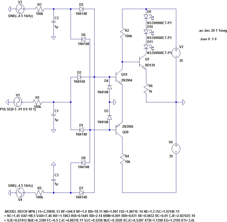

I've attached the 3-channel dc-offset detector circuit and I've used a simple transistor switch to power the photovoltaic couplers, shown in the schematic as LEDs.
The plot shows what happens to the current flow through the LEDs over time (green) and the d.c. signal from the centre channel (blue) which suddenly flips to the rail. Looks like a 30ms long take-down of the output to the speakers after a failure.

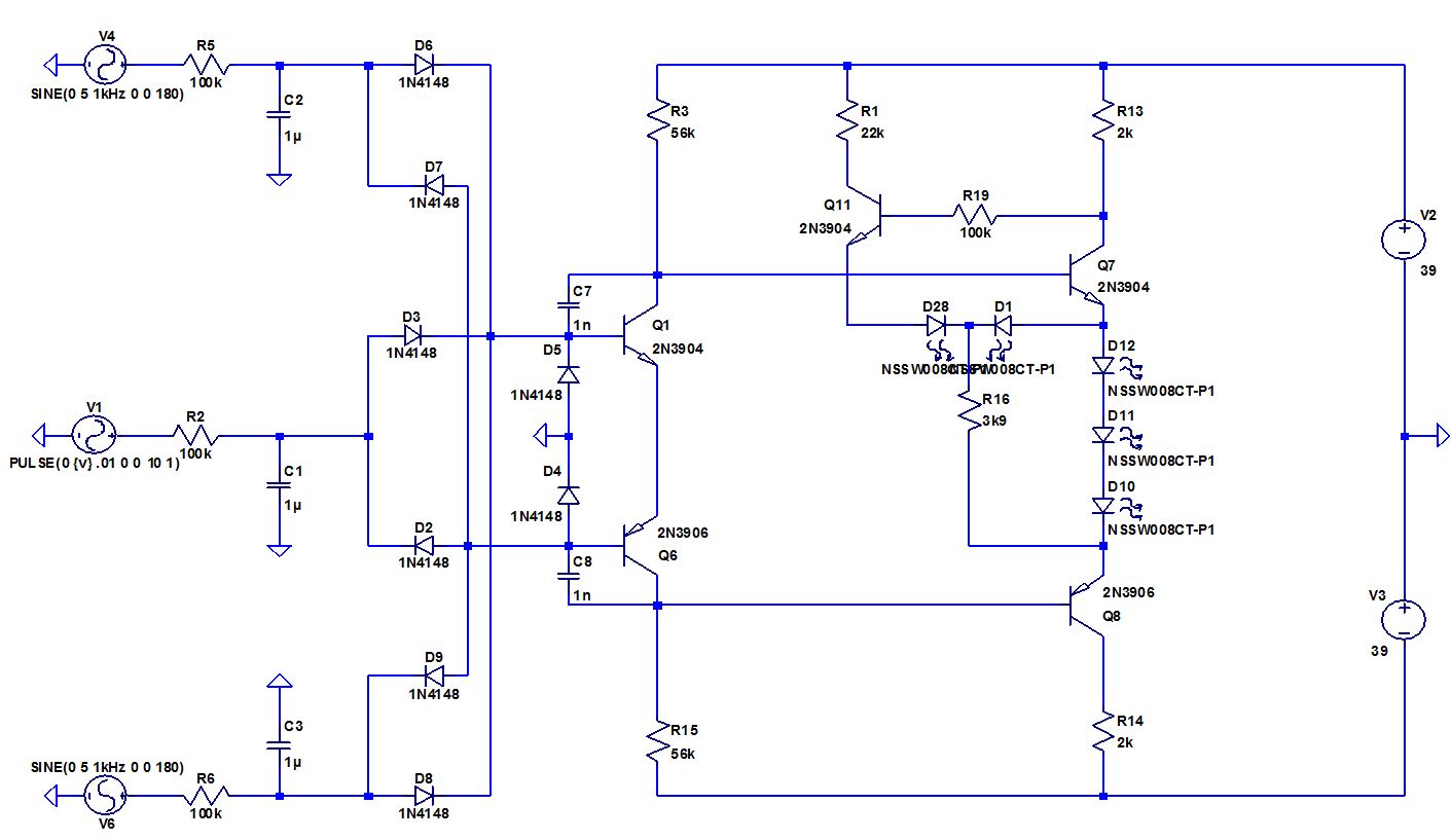

Well, after further simulations I see weaknesses and I have updated my design with some key improvements.
I noticed that when the same dc detect circuit is used to monitor several channels, you can have one channel with dc offset and another channel still singing away with audio. This means that the switching action of the circuit can be impacted by a.f. signals on top of the d.c. - it's not an issue when a channel fails catastrophically but if there is a soft-fail where a small but 'illegal' level of dc-offset occurs the switching can show some 'bounce'. Adding a pair of 'Cdom' caps to the dc-detect devices can address this.
I have also make the solid state relay driving device a symmetrical pair of devices instead of a single. This improves the switching action.
And lastly I wanted to provide for a dual red-green LED indicator, just like on my Bryston amplifier. I added an extra device for this purpose. Now I can run one of those dual LEDs on my front panel. It will glow red when the solid state relay is open, green when it is closed.

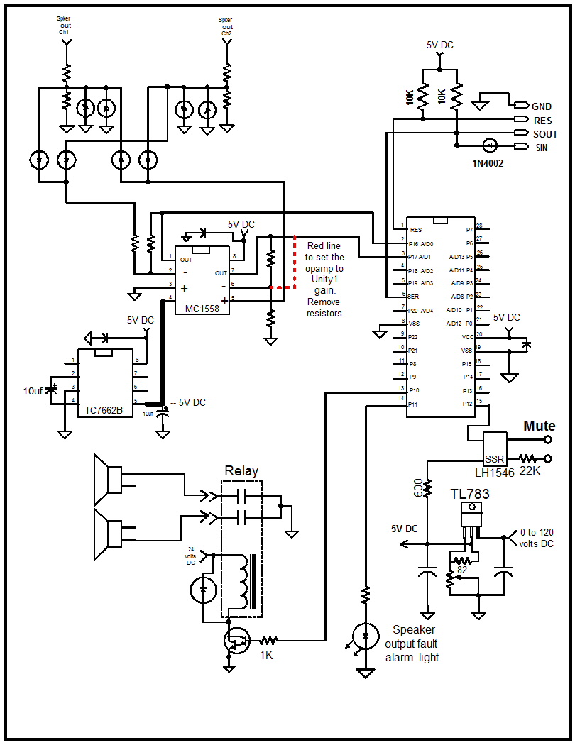

I am also working in a relay system to protect the speaker using a micro. I will use the basic micro Nano series. They are programming in basic and the prices it is a low cost. They are start at 2.98 for a 4 pins output to 28 dollars. I will use the Nano 28 since I have some left over from a project but if I didn't have the extra I will use the. They are easy to programming, It will do job easily and the best thing is that you can tailor it to your needs.
Attached is a the schematic of my design.

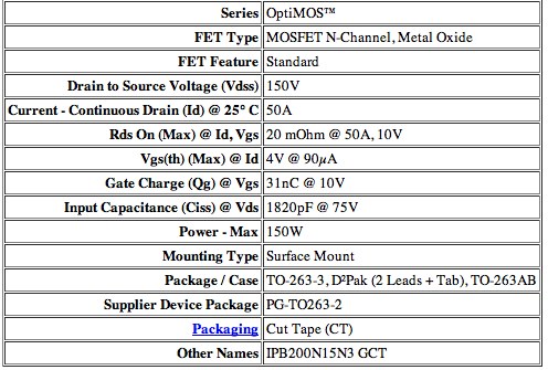

I finally built my FET based 'relay' and it is now up and working. As it was installed in an existing amplifier I captured the details in a different thread: http://www.diyaudio.com/forums/soli...imple-symmetric-amplifier-13.html#post2939602
I used the IPB200N15N3 G parts from Infinion, got them from Digikey.
