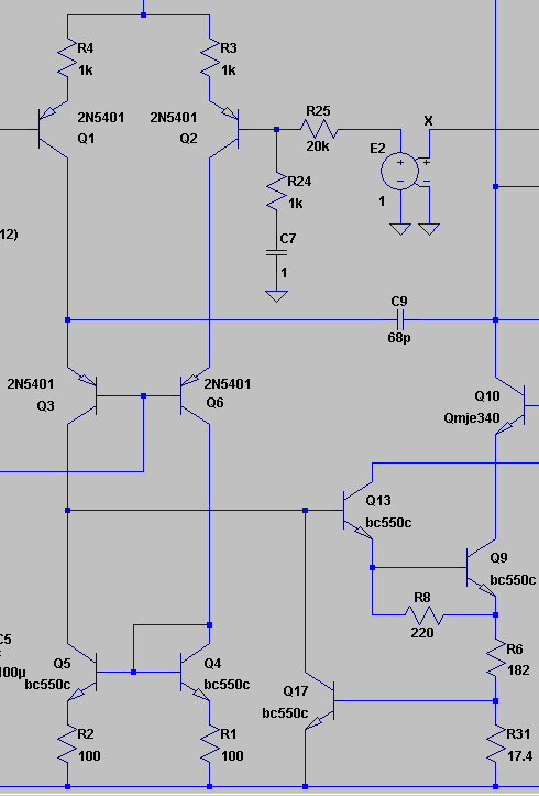

Actually I like the idea of regulating the low-current stages.
Also, the circuit below gives a substantial PSRR improvement. You may have to zoom in a bit to see the schematic without some lines looking like they are missing. See pages 248 and 249 of Self's book for more info. I think he got this idea from "A General Relationship Between Amplifier Parameters, And Its Application to PSRR Improvement" by Sackinger, Goette and Guggenbuhl, IEEE Transations on Circuits and Systems Vol 38, #10, Oct 1991 (thanks jcx for originally pointing out this paper to me). If you shoot me an email I can send it to you.
amplifierguru said:Mikeks,
Just have a look at the effect the miller C has on the vast majority of chip op amps - the PSRR taks a dive and in comes the supply hash. They use it to save chip space - it's one place a small C provides heaps of stability. What's your excuse?
Op amps...have this characteristic...BUT they do not use RC filters...There is no reason why this need be the case in an amp. with RC filtering...
andy_c said:
........See pages 248 and 249 of Self's book for more info. I think he got this idea from "A General Relationship Between Amplifier Parameters, And Its Application to PSRR Improvement" by Sackinger, Goette and Guggenbuhl, IEEE Transations on Circuits and Systems Vol 38, #10, Oct 1991 (thanks jcx for originally pointing out this paper to me). If you shoot me an email I can send it to you.
I reckon minor loop stability is somewhat compromised by this approach...
Yes...send me paper please...
