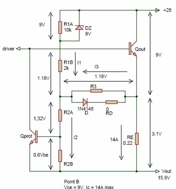

This is how it looks for point B on the urve, I'm sure you recognise it Mike. The odd thing that was not in your article IIRC is the part between zero and 9V Vce. That one took some time to figure out.
But I'm not going to tell more about it, because it is going to be part of an article (hopefully, eventually).
Also, it isn't tested yet. I have constructed the "I/V" display system designed by Peter Baxandall many years ago, and that is working now. I will use that to display the contour of the full I/V protection in all 4 quadrants.
Jan Didden

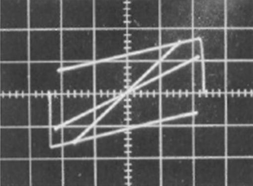

This is a picture made by Baxandall of the QUAD 405 I/V contour including 4- and 8-ohms resistive load lines. Mine are not so nice yet mainly because I can't do long-time exposures on the scope with my simple digital camera; the picture consists of many slow-moving points.
I am awaiting delivery of a used HP variable persistence display, hopefully I can get at least as nice pictures then!
Jan Didden
Edit: hor 20V/div, vert 5A/div
