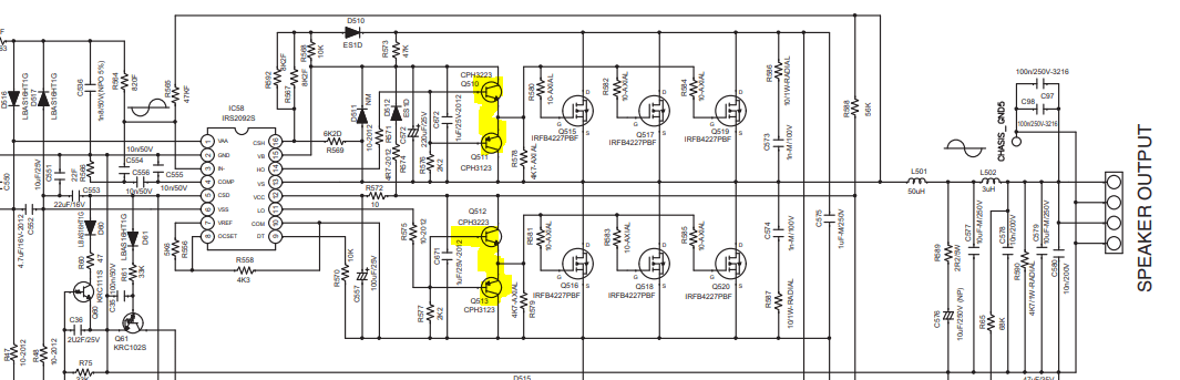

Output Power Transistors as Drivers?

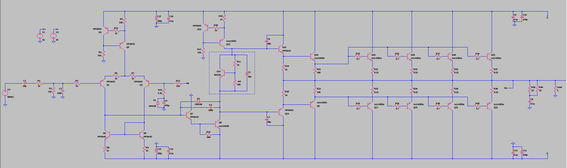

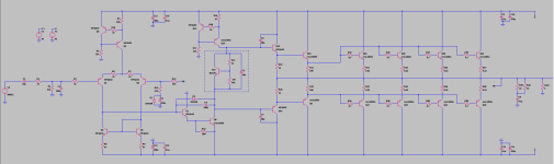

@tomchr @wg_ski For 3db , going from 500W to 250W would be wise, less heat and " stress" on the woofer.
+-45v DC might be enough for 2 ohm ?.
This is what I came up with so far ( some blameless inspired, ( I've built this before with +-35v with 2sc4468 / 2sc1965 with success ).
Some VI Limiter's might be needed here ?. I will surely add a speaker protection ( dc detect ).
output " zobel " inductor might not be needed , thick short wires from the amp to the sub . ( amp will be next to the sub ) .
MPSA92 and MPSA42 ( MPSA43 in LTspice because I don't have MPSA42 for simulation ).
- Any benefit to go darlington for the Vbe multip ?. Faster " temperature compensation " or not ?.

I’ve never had any trouble with quasi comp (even a triple) at these voltage levels (<60V rails). Assuming things are properly decoupled. It’s when you try to get fancy with the circuitry or run at high voltages that things get tricky.
If you want a ”faster” or more sensitive vbe multiplier you use a CFP. For the multiplier. It’s vbe will be lower (because it’s first stage runs at lower current) so for a given setting the tempco magnitude goes up. If you want separate compensation for the various stages of the output stage, you string vbe multipliers or diodes in series. Can sort of combine the effects by using a diode string (or string of diode connected transistors) in the base circuit of the main multiplier. The diodes’ current is quite low so their drop is low.

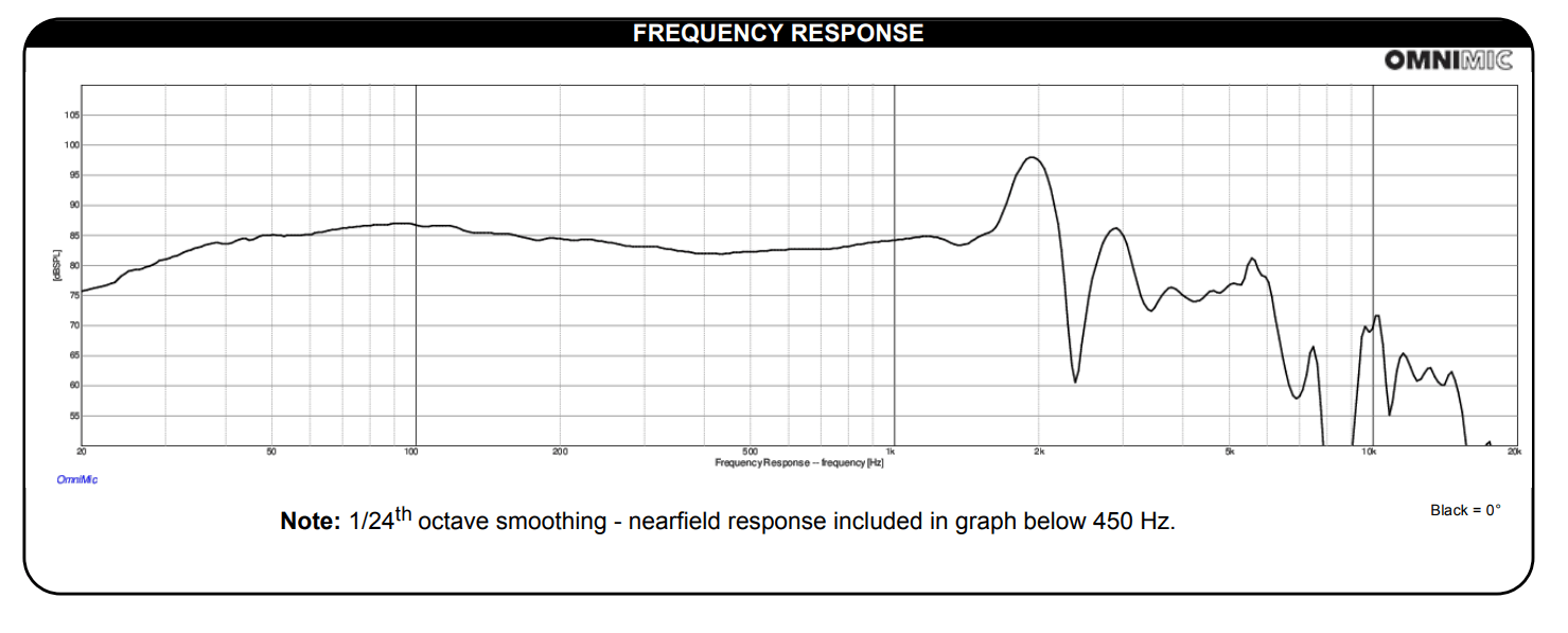

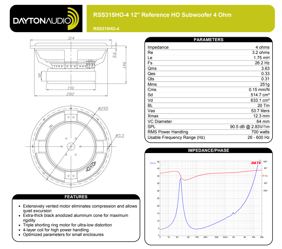

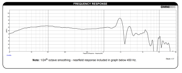

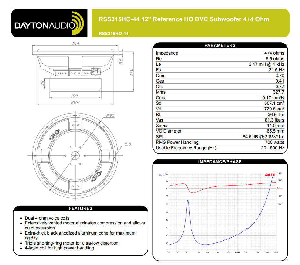

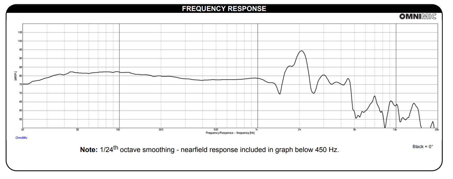

@wg_ski Woofer is Dayton Audio RSS315HO-44 .
two variants , 4 ohm and DVC
84db sensibility not so much.
the 4ohm version has 90.5db sensibility ( is it because they tested the DVC at 8 ohm 2.5v ? . , and mms 251g - 327g on the 4+4 dual voice coil,
Fs from 21.5 on the DVC up to 26hz on the single coil version.
that much sensibility difference because of the added mass on the cone? or was it on 8ohm wired when tested ?. ( makes sense the Fs is lower on the 327g vs the 251g ) "

I think it was the crown DC300 that used TO-3 drivers, and you had to find a 10MHz+ part or it would oscillate, particularly the CFP3 side. Modern OPs are a lot faster than 2N3773's etc so not such a big problem anymore. But know that CFP are sensitive to device speed. The driver and OP need to be very different so that the OP pole dominates.
With 100+ MHz predrivers, one can use MJ15024 driving multiple MJ15024 (Or modern 2N3773). Old school 800 KHZ outputs, 2 MHz drivers, with 10-20 MHz predrivers in CFP3 no. That does oscillate. And in any case it’s sensitive to power supply impedance.
It works BETTER with MJL3281 driver, but doesn’t fit the TO-3 socket. And 10-50 MHz TO-3’s - even NPN switching types, are almost gone. They’re having to build the Naim clones out of C5200’s or the latest Sanken NPNs nowadays. No more BDY58’s or the 2N equivalents. BUV21/22 are all that’s left, and they’re on the slower side of the spectrum - closer to 10 MHz.
