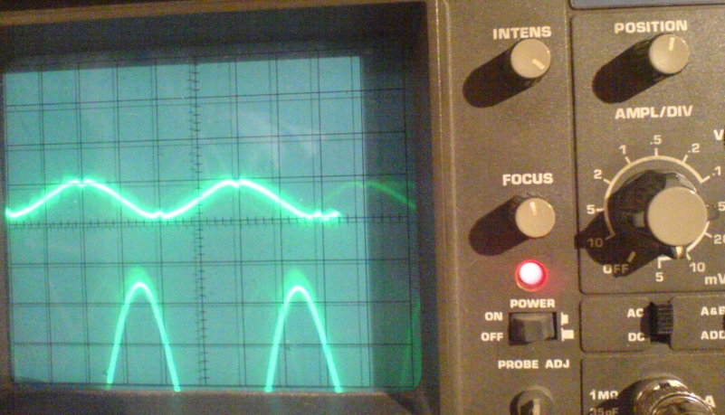

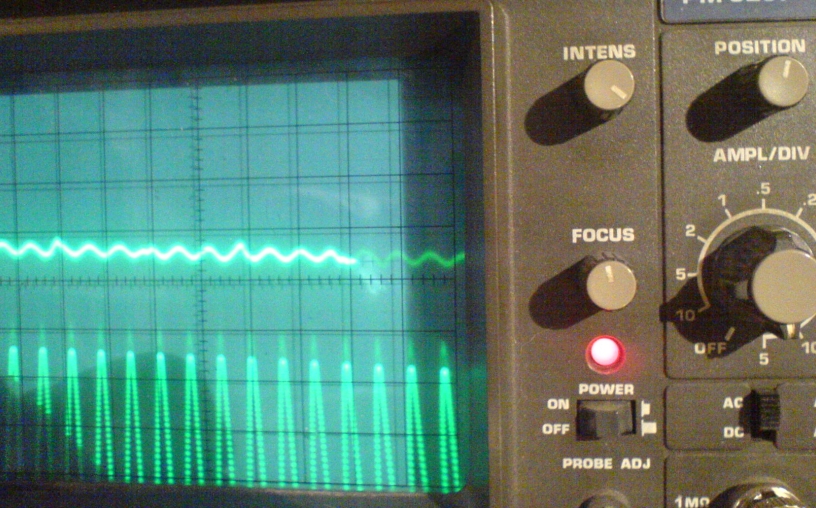

I believe that for the 1545 I already have my test-platform, but you made me think... I will first try a couple of power-supply topologies. I just tried to have a feeling of noise on VCC with my prehistoric scope and was very surprised to see the 50Hz test signal I was using on Vcc with 5mVpp. At about 250Hz it is still 2mVpp and it further lowers with frequency. The decoupling cap is 470uF. There must be someting wrong somehow.. some additional work is needed. For the measurement I soldered a small coax directly to the power supply connection I made on the board. Beside that, I don't see a lot of noise.. (within my measure capability of maybe 1mV :) )
I will take out the shunt regulator to test it separately and I will also make a basic TL431 + CS to compare.
Bern

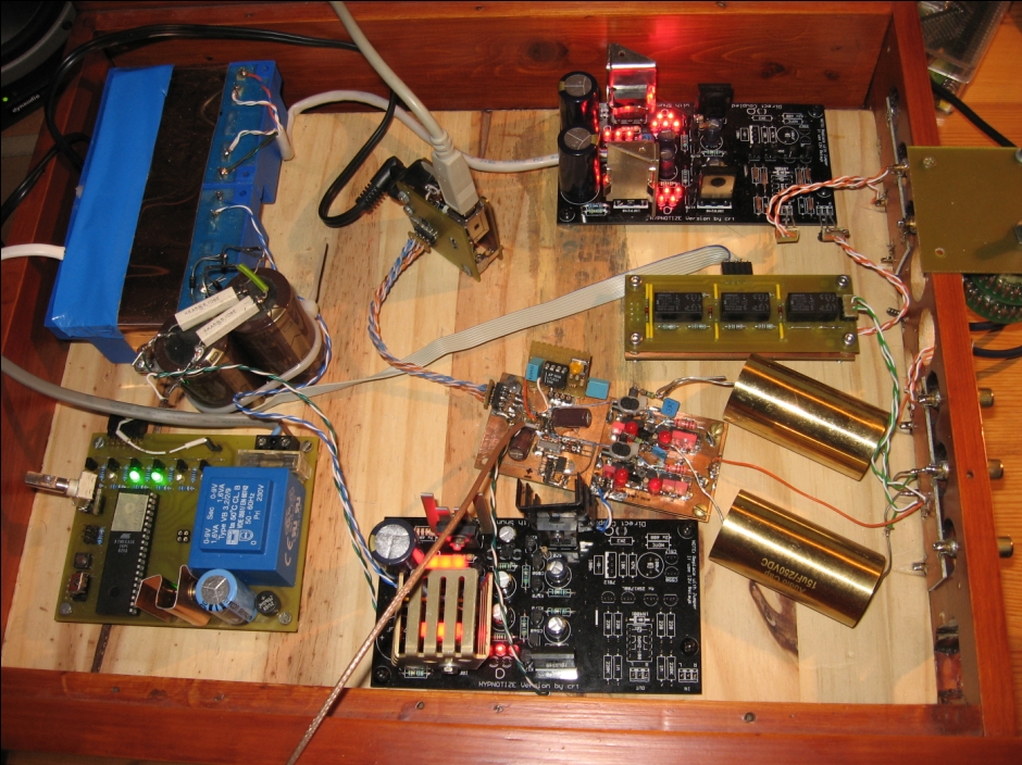

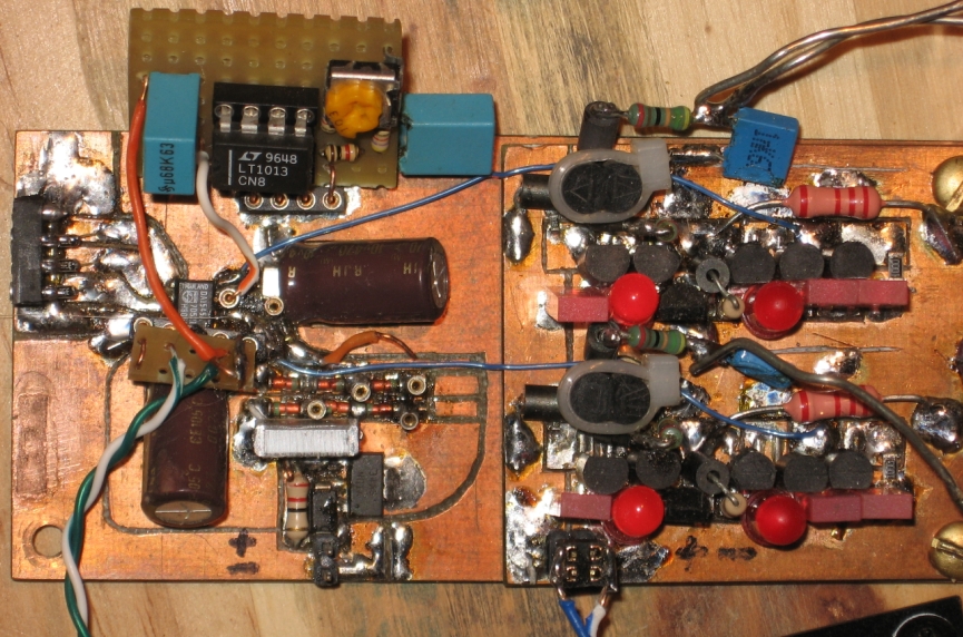

Thorsten,
What would be an acceptable noise/ripple on the VCC and Iref-pin?
I found the schematic on the site from Walt J. of a rather simple differentian probe using a SSM2017.. I guess it should be good enough as a start, what do you think? I believe it has a gain of 100, so I would see 50 -10 uV...
Berny
Well, the Iref pin has NEGATIVE PSRR, so noise needs to as low as you can. I use discrete shunts there that are well below 0.2uV.
The Powersupply shows 30dB supply noise rejection, so with 2V out and aiming at ~ 100dB suppression we are talking at least -76dBV, round up to -80dBV supply noise, that is no more than 100uV.
A 431 has around 100nV|/Hz Ein at 1KHz and around 200nV |?Hz at 10 Hz. I'd estimate this as 18uV.
So 431 shunt with a ccs should deal with noise well enough. For reference you need a lot more filtering from that though.
Ciao T
