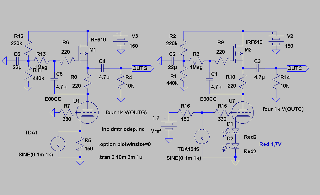

Hey T,
Thanks, that seems logical.
Here are two possible "el cheapo"/no OPT-versions that tries the theories.
R1 resp. R11 is used to set Ua.

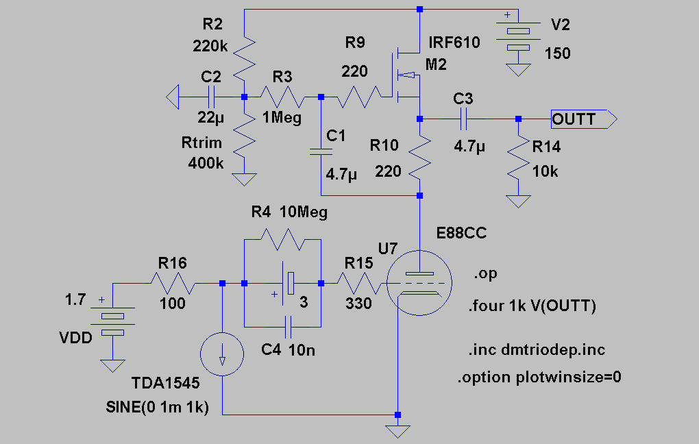

Thanks T,
But that one was so basic that even I knew it🙂.
This one is based on what we discussed when I was planning my preamp about a year ago. The "88" is at ca 90V/15mA. The cell is Lithium.

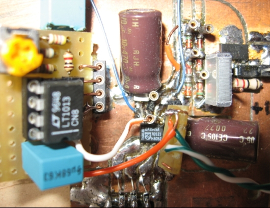

Revintage, you can check my previous post concerning applying a voltage directly. For me it gives the best results. I hoped I could "crank up" the voltage in my setup using the trimmer I implemented to set precisely that voltage, but the range is too small (+/-0.2V) and voltage needs to be doubled. I will adapt it when my new discrete version of RBroer's I/V is finalised.
After that (in a month or so) I will try one of your tubed outputs to compare!
For a low noise voltage, I believe the use of a low noise opamp with an "over-filtered" R-divider reference voltage would be the easiest way. Thorsten gave some useful info around Vref in the past (search on kuei / TDA1545):
http://www.diyaudio.com/forums/digital-source/65288-tda1545a-vref-capacitor.html#post737001
Attached my experiment-platform 🙂

Discrete super low noise shunt regulator setting the voltage.
Any hints on what the advantage would be to go shunt? I believe the reference voltage applied directly to the Iref-pin doesn't even need to be low impedance, as long as it is super clean.
The reference voltage does get applied to some switched circuitry, based on internal design. Also, a shunt can be made to have very low noise and very good ripple/noise rejection.
