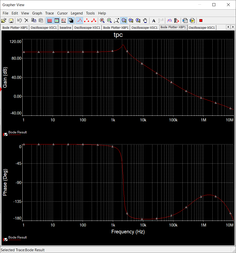

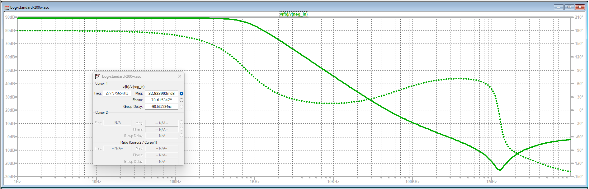

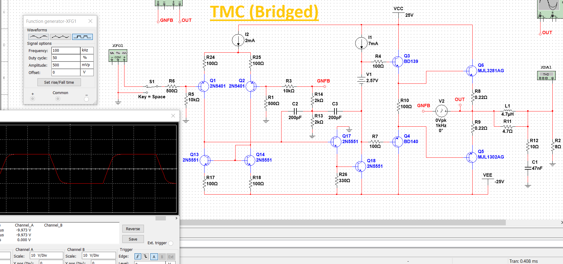

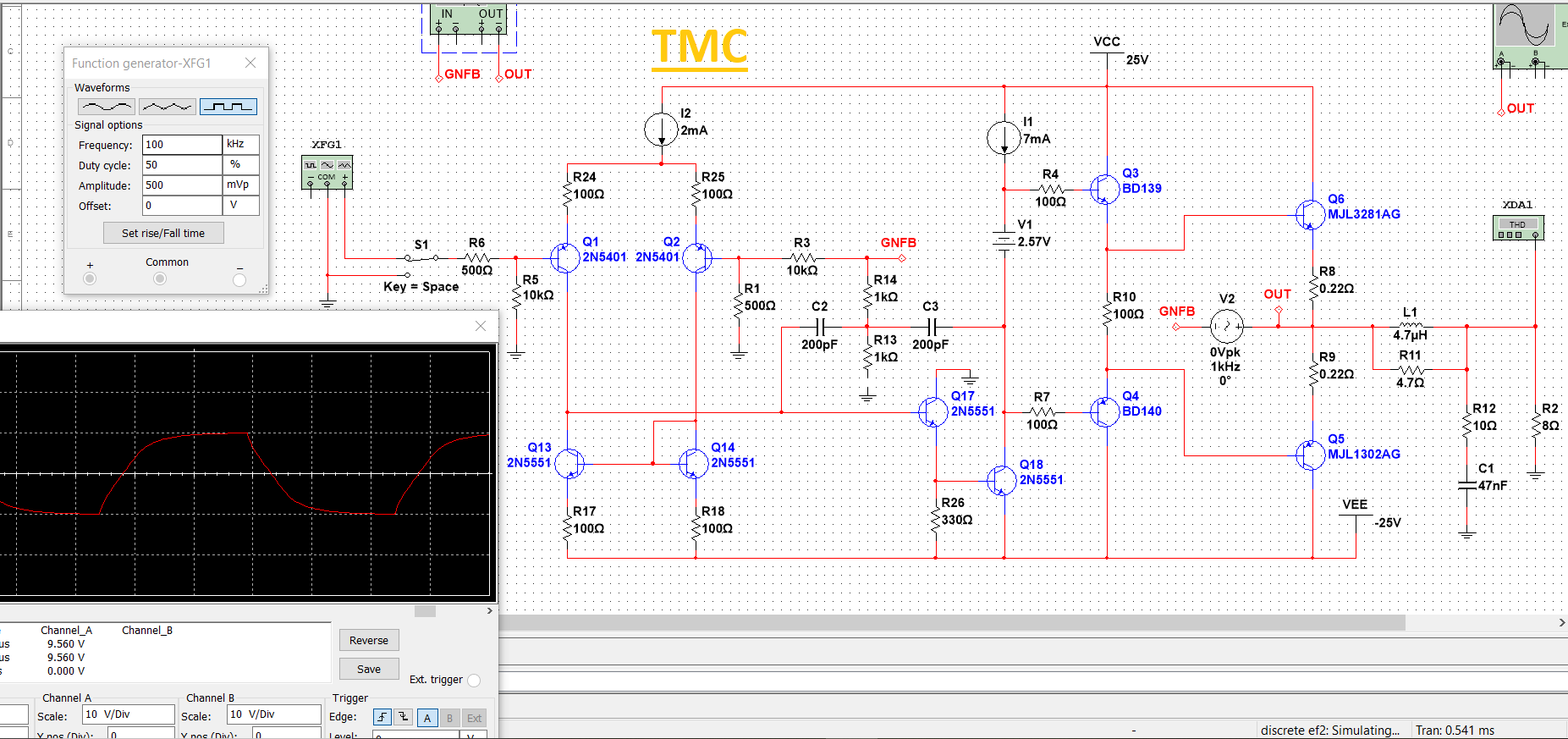

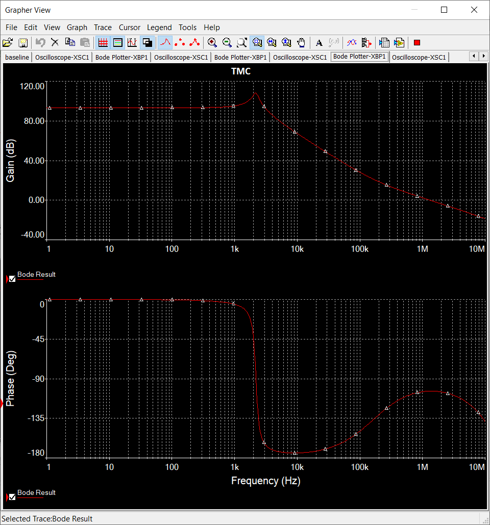

I can answer that question for you!
TMC:
TPC:
The THD also increases a hair with TPC, but it's only about 10PPM difference.
Then there's the OLG.
TMC
TPC:
I doubt that it makes any difference in terms of real performance, but I'm still a TMC fanboy! 🙂
TMC:
TPC:
TMC
TPC:

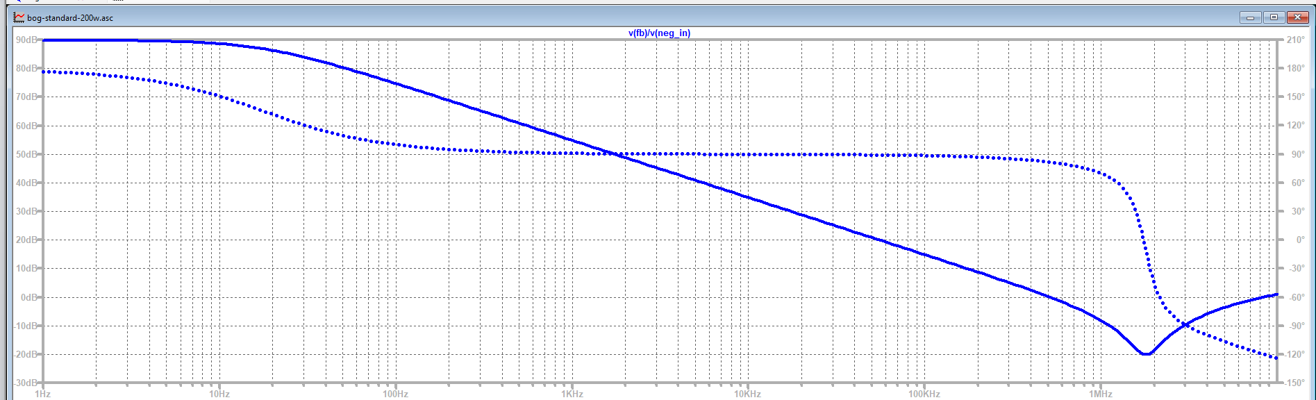

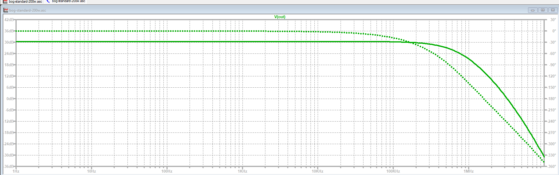

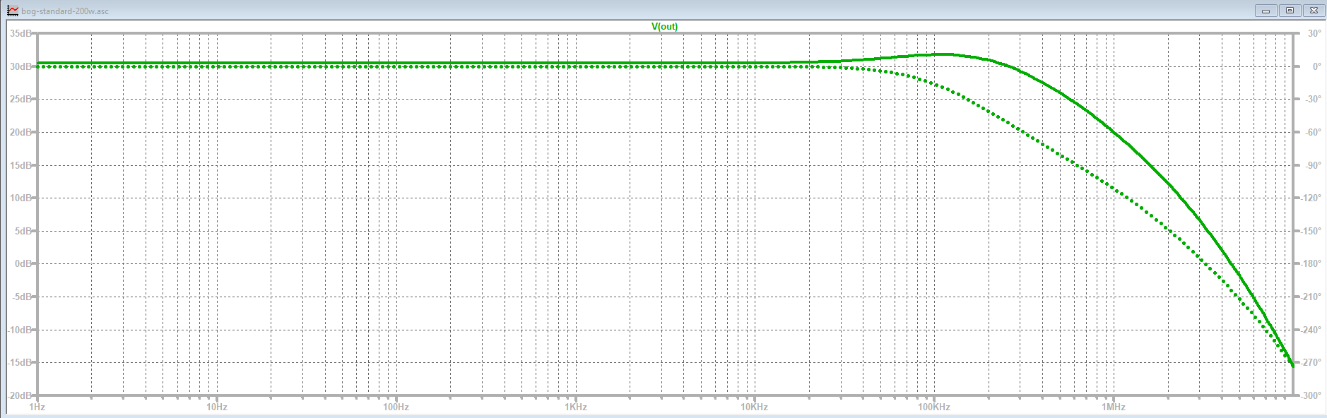

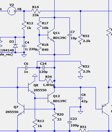

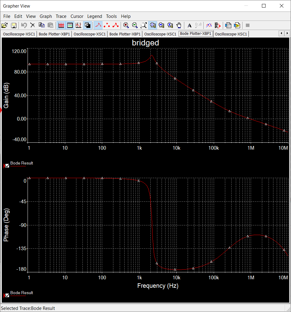

There is no peaking (closed loop) with TMC, as #27 shows, if you keep R52, R53 the same ratio as C6, C24.Does anybody know whether TMC shows the same amount of closed loop gain peaking like TPC?
This not an apples to apples comparison.
What you call TMC has a 1:1 capacitor ratio and it shows in the OLG plot.
TPC shows the steep roll-off as expected, but your TMC has shallow roll-off and looks like plain Miller compensation because of the capacitor ratio.
What I mean with steep roll-off: In your example TPC has 85dB OLG at 1kHz and 45dB OLG at 10kHz, while TMC has only 60dB at 1kHz and 40dB at 10kHz.
The idea behind the multi-pole compensation is to increase the feedback ratio, i.e. OLG minus CLG. The more OLG at given frequency, the higher the feedback ratio, means the better the ability to retain in control of the amplifier. Given the CLG is 25dB, TPC offers 60dB control at 1kHz and 20dB at 10kHz. Your TMC example (which is not proper TMC by the way), has only 35dB at 1kHz and 15dB at 10kHz.
For an apples to apples comparison you would need to make the capacitors equal in both TPC and TMC.
And the additional resistor that forms a voltage divider with the one connected to the output is also something I haven't seen anywhere before. Where does it come from and what is the idea behind?

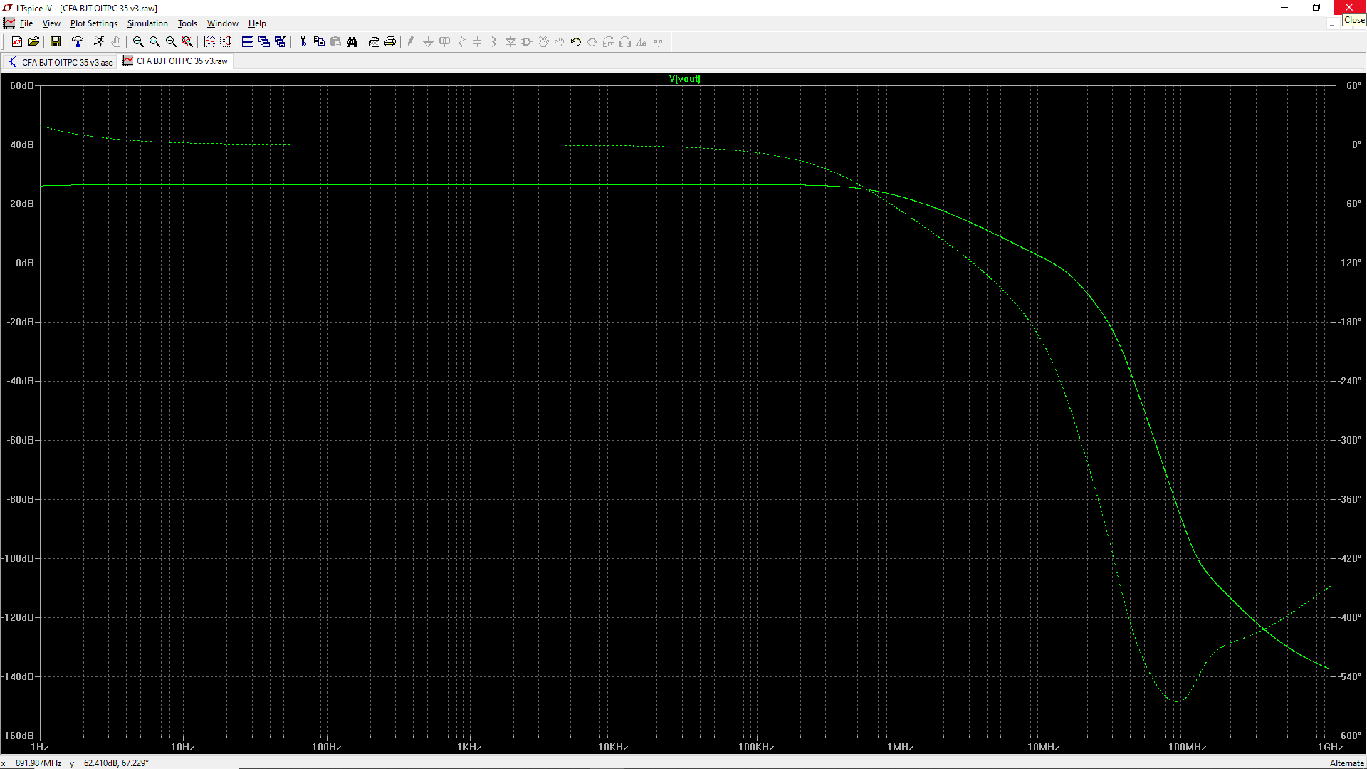

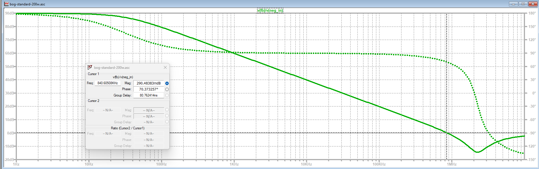

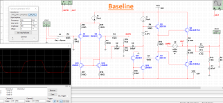

Answering my own question:Does anybody know whether TMC shows the same amount of closed loop gain peaking like TPC?
I use a simulator for this, but you can calculate it as well. Start off by Miller compensating the amp for 70-90 degrees phase margin at the unity loop gain frequency (ULGF). This will usually be between 1MHz and 2 MHz in a bipolar amp using modern sustained beta output devices EF2 or EF3. Once that is done, split the comp cap into two parts. The cap going to the base of the VAS stage keeps the same value. Make the second cap going to the VAS output 2x that of the first cap. Now you have to calculate the resistor part. Use R = f/2*Pi*2c where c is the value of the Miller cap and F is 50...

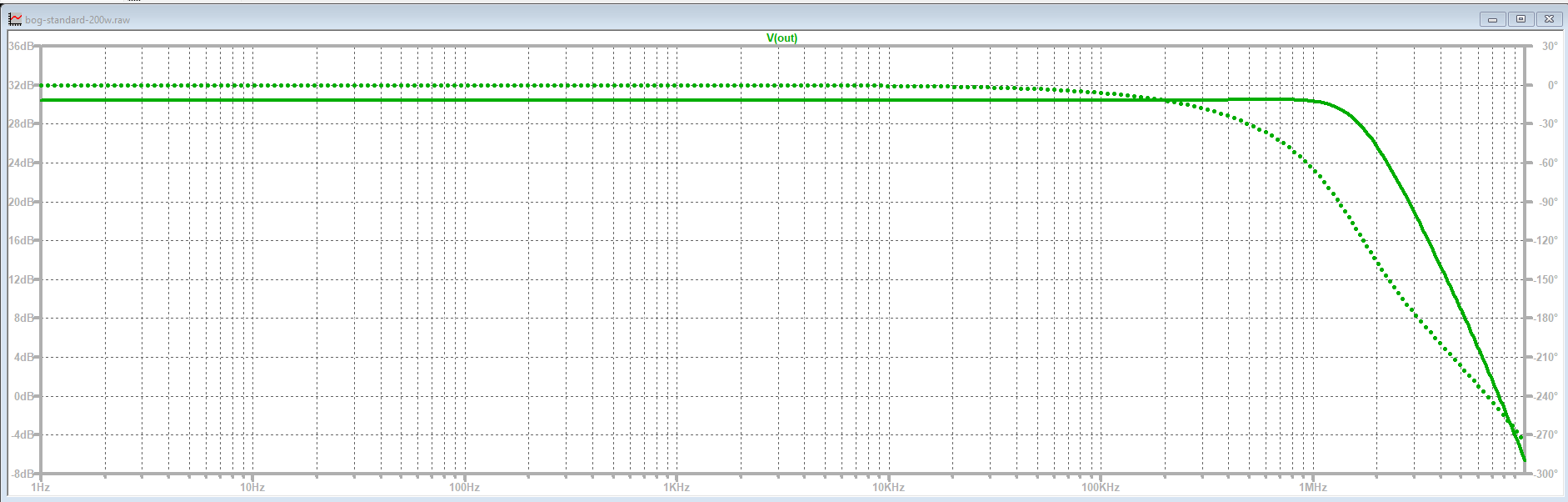

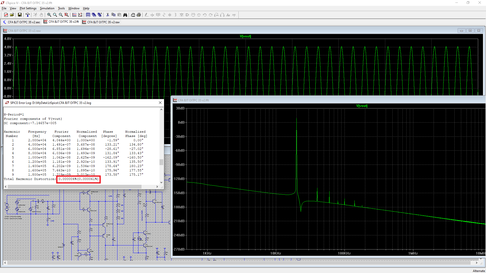

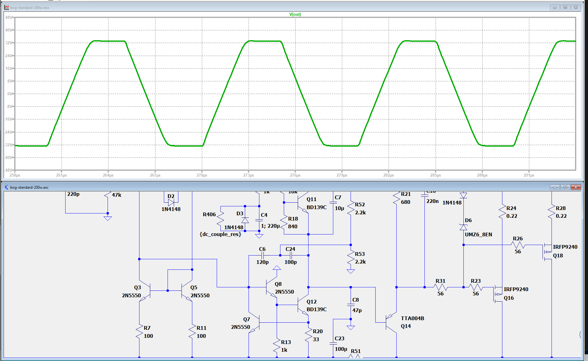

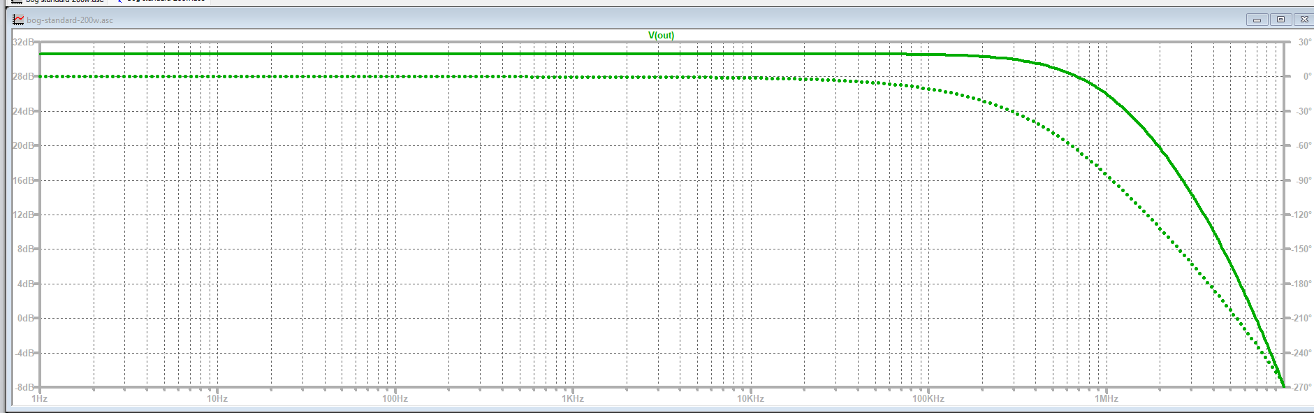

Close loop gain (no peaking).My simulation of CFA amplifier with OITPC compensation. This is without any error corrector at output. Power supply is 35VDC.
