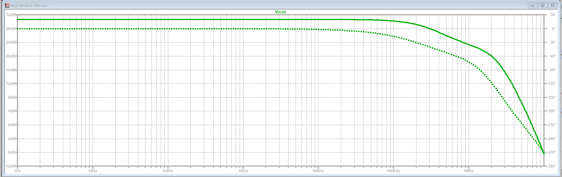

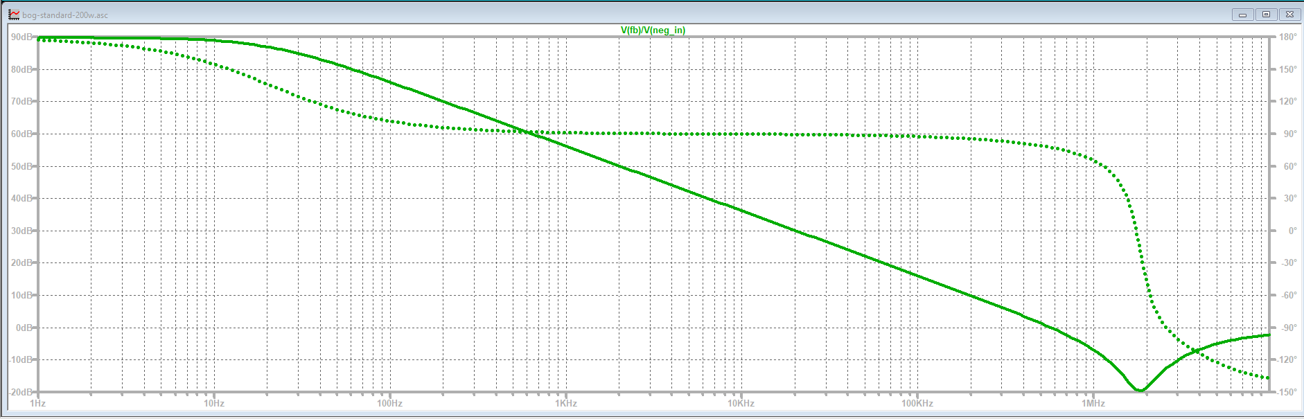

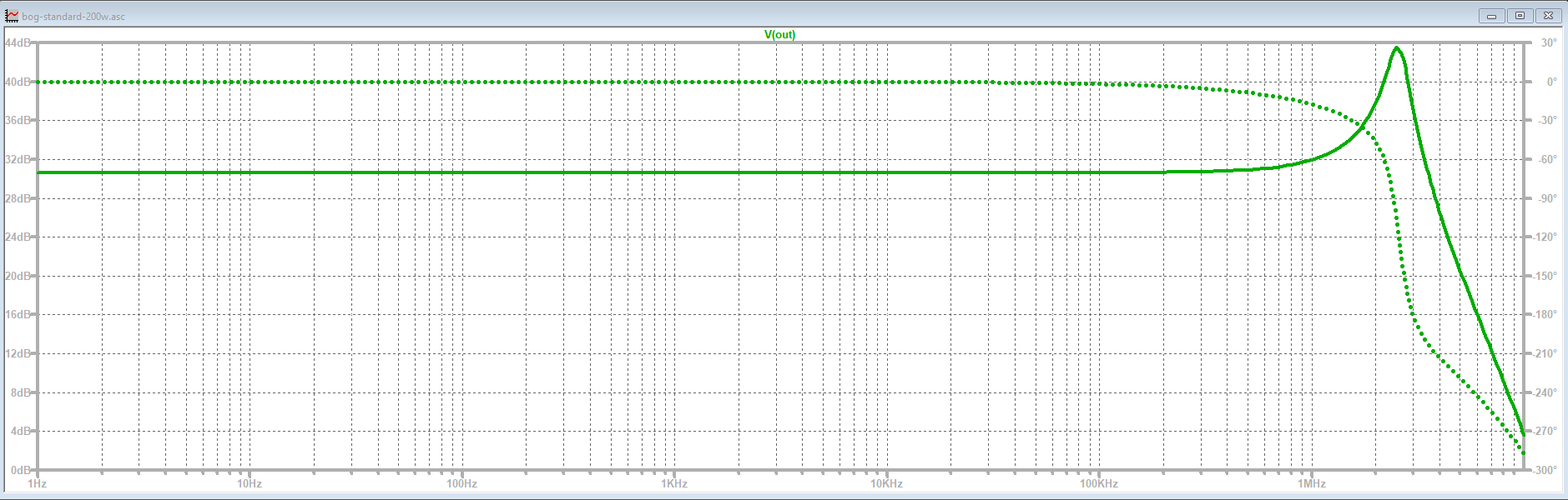

I can answer that question for you!
TMC:
TPC:
The THD also increases a hair with TPC, but it's only about 10PPM difference.
Then there's the OLG.
TMC
TPC:
I doubt that it makes any difference in terms of real performance, but I'm still a TMC fanboy! 🙂
