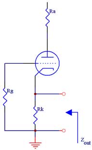

Could somebody help me with this problem, I'm just wondering what the output impedance is for the circuit beneath.
I have tried to find the formula for the output impedance, but I don't know if it's correct.
the formula I found is:
Zout= Rk || (rp+Ra+u*Rk)
or (Rk*(rp+Ra+u*Rk)) / (Rk+rp+Ra+u*Rk)

Zout = Rk // [(Ra+ra)/(u+1)]
To put it in words, looking up into the anode, all resistances are divided by a factor of (u+1), and that little lot is in parallel with your cathode bias resistor.
The equation you quoted would imply that loading a cathode follower with a constant current sink insted of a cathode resistor would significantly increase its output resistance.

Zo AT THE CATHODE.
The easiest way is:
Output impedance (cathode):
Rk' = (Rl+ra)/(mu+1)
Rout = Rk'||Rk
Where:
Rp = the plate resistor
Rl = the load resistance, or the input resistance of the next stage
Ra = the total load resistance, which is Rp in parallel with the input resistance of the next stage, Rl. If there is no Rl, Ra = Rp.
ra = the internal plate resistance of the tube
mu = the mu of the tube
Keep in mind this for a bypassed Rk.
Cheers,;)

Bypassed Rk?
Meaning : cathode resistor bypassed with a capacitor.
Should have clarified that.
For the unbypassed common cathode circuit you can use this:
Rout = [(Ra + ra)/(mu + 1) * Rk] / [(Ra + ra)/(mu + 1) + Rk]
Where:
Rk = the cathode resistor
Cheers,;)

I SEE.
Sorry if I got anyone confused here.:eek:
Rout = Rk'||Rk
Actually this is the output impedance calculated for a common cathode stage,signal is of course taken from the plate,cathode R is bypassed.
Output impedance (plate):
Rout = (ra * Rp)/(ra + Rp)
Hope this sets it straight.
