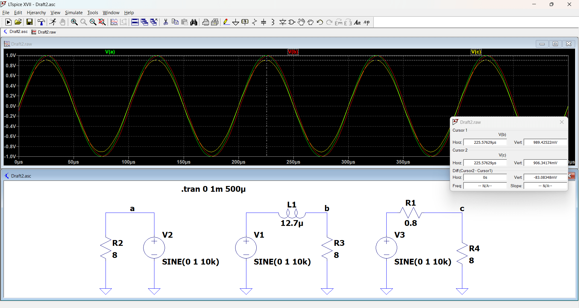

I was wrong when I stated that the maximum error with the "wrong" method was bounded: it can be much larger in fact.
This sim illustrates the problem:
It shows three situations: Zout=0, Zout=0.8ohm reactive and Zout=0.8ohm resistive.
Everything is normalized to 1V.
With the resistive load, the loss is close to 1/11th as expected for 0.8ohm, but for the 12.7µ (|0.8ohm| too, but inductive), the drop is 10 times smaller, meaning the computed impedance would be ~0.08ohm, ten times smaller than reality.
This example is somewhat caricatural, but not that much: most amplifiers have a heavily inductive output impedance, for a number of reasons. Tube amplifiers have an output transformer and its inevitable leakage inductance associated, and solid state amplifiers normally rely on a strong NFB, which also results in a synthetic inductive output.
Good tube amplifiers have both the transformer and the synthetic inductance.
The only amplifiers (almost) immune to that are Pass-like: direct output and zero FB, but they are oddities
One of those truly 😳 moments.
If asked, I would bet my salary that equivalent reactive and pure resistive impedances would provide the same voltage drop. Answer is probably in U/I phase shift.

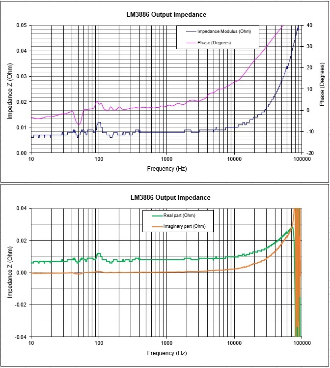

Yes, first amplifier where results align, is direct output with no NFB.
Second one is direct output but large NFB. It has 30 cm wires (2x 15 cm) at output with some 150 nH inductance. Your explanation reveals how that inductance effect can virtually disappear while loading amplifier output.
Using LTSpice and amplifier output impedance as 2 mΩ and wires impedance as 3 mΩ + 150 nH per channel, I got correct behavior similar as measured for resistive loading and current injection from one channel to another. 👍

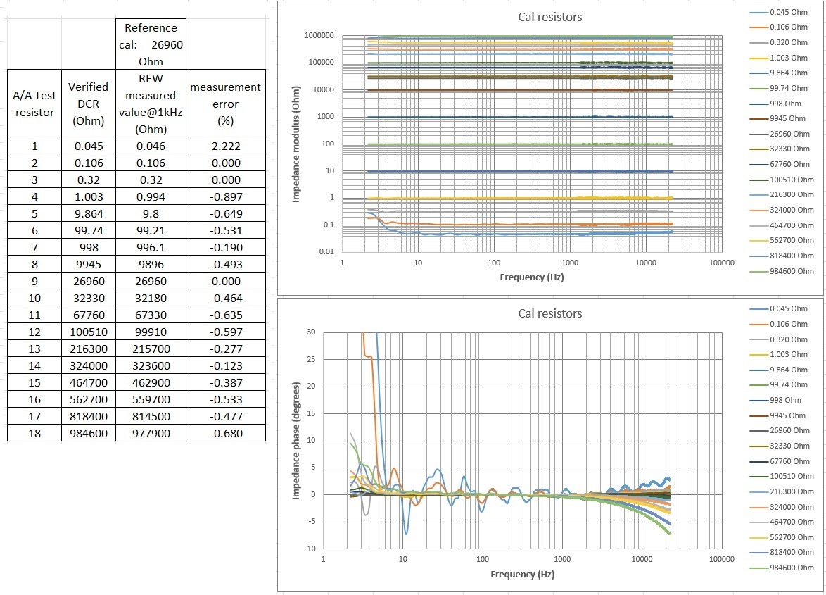

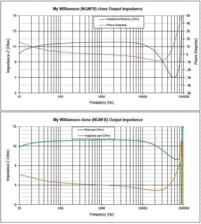

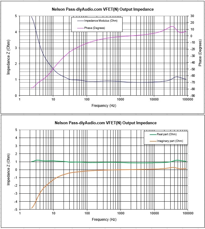

Answer to as why one measurement at 500 Hz resulted with 6 mOhm and another with 8 mOhm is known. As said, measurement errors and tolerances. While measuring below 10 mOhm, method with current injection is more precise, because of much higher measurement resolution. Method with 2 resistors has to deal with only 20 mV relative voltage change (jumping several mV) at 6 Vrms nominal level. Error is easily 30% and that is still irrelevant to the main question:
So far it looks that NFB or no NFB is not a factor. Only that at very low impedances change toward higher frequency is not obscured.
impedance of amplifier with NFB is not the same for sourcing and sinking current or for acting as voltage and current source vs. acting as load or current sink.

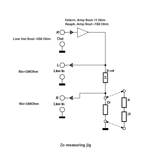

For Zo measurements, I use a soundcard with high input impedance and an external amplifier if the DUT is of low Zo (when the amplifier DUT is a stereo unit, I use one channel to drive the output of the other).
Drive level doesn't change the meas. result, as long as S/N ratio is adequate and soundcard input does not overload.
I test the validity of measurements with a set of test resistors.
Good results for a measurement range at least two decades higher and lower from the Rref
I use REW to take the measurements, then export data to Excel
George
George

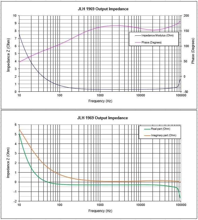

Erratum.
On third attachment (JLH 1969), the real and imaginary components of Zo have been swapped.
George
George

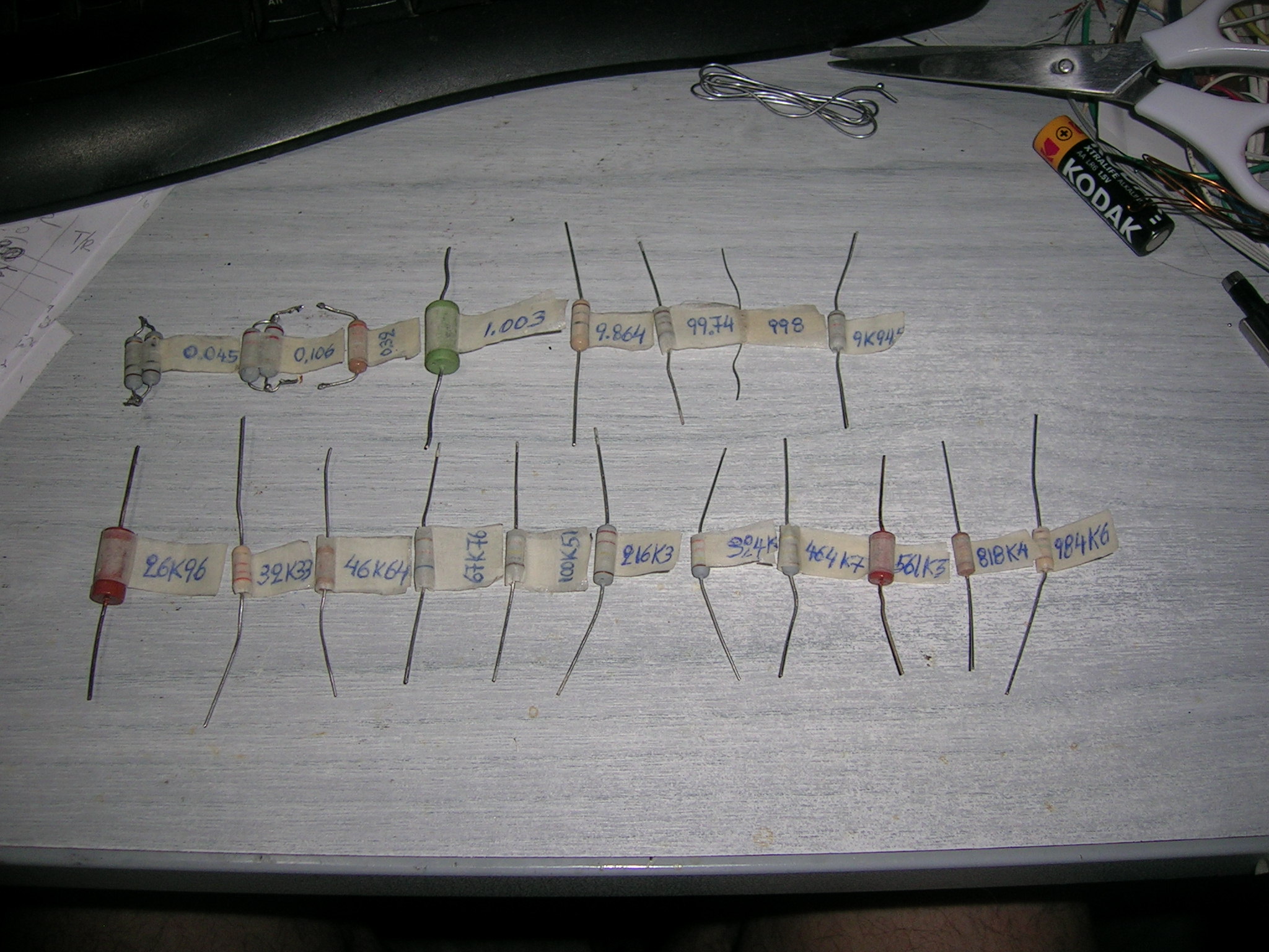

In any event, you "have to" (wife says) do a calibration run with a known very low inductance resistor "OPEN, SHORT, Cal LOAD", download to Excel and engineering math magic have a calibration file and "sanity test" for measurement of an actual active load.
My low inductance resistor is 1210 for passive component testing.
Yes, this cal procedure (Open, Short, Reference cal) is done within REW.
Selection of 'Reference cal' (for REW) and 'R ref' (for measuring jig) is easy when measurement span is not larger than 3 decades, as is the case with Amp Zo.
Things get harder when measurement span increases. Below verification results with 18 test resistors (for measuring a 24 tap multi k turns AVC).
Still good results
George
Still good results
George
