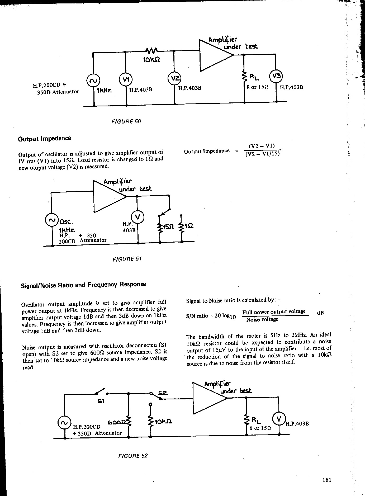

If you test a stereo amplifier, short the input of the channel you want to test, connect a 4.7 or 8.2 ohm resistor between the outputs, apply the test signal to the auxiliary amplifier and adjust the amplitude to read 4.7V or 8.2V across the resistor. Then connect the voltmeter between GND and the output you test: the volts reading will be the output impedance, directly, without calculations: for example, 0.6V means an impedance of 0.6 ohm. Quick, easy and accurate even if the impedance is non-purely resistive or non-linear

Anyway, I did the measurements, I got 1.6V with 9,4 Ohm and 0.6V with 4.7 Ohm.

So, that's easy then. First, calculate the two output currents Vout/Rload. The difference between those two currents is the delta-current.Sorry Jan, I thought I did, but they are all the' LOAD / NO LOAD' kind, nothing with half load.
You also know the delta-voltage, that's the difference between the two output voltages.
Then Zout = delta-Vout/delta-I. Easypeasy.

So: 1,6V over 9,4 Ohm : 0,170 A
0,6V over 4,7 Ohm: 0,127 A
Delta V = 1V
Delta I = 0,043 A
1 / 0,043 = 23,25 Ohm
I have no idea whether that's good or bad... Low is good I think, but how little is low?

You can relate it to the damping factor, which is the ratio of load impedance to output impedance.
Say you have an 8 ohms load and an output Z of 4 ohms, the damping factor is 8 / 4 = 2.
You normally want a high damping factor to avoid that the impedance variations of the load (speaker) impact the system frequency response.
Generally, a damping factor of 10 to 20 is sufficient.
In your case, the damping factor (with 8 ohms load) is 8/23.25 = ~ 0.3 which is quite low.
I would look for the reason of the highish Zout.

As I said , it is useless calculating a damping factor with normal/double Raa ... maybe 0,5ohm step between measurements or even less .
You should keep Raa relatively the same otherwise the measurements have no meaning , thats't not the output resistance , it's another operating point for tubes . If somebody else will measure at half/triple Raa the results would be completly different .

@Miniwatt using the spreadsheet provided by @tombo56 in post 13 and the numbers you provided, your amp has a -23.5 ohm output resistance. I did the math myself with voltage dividers and got the same result. For any positive output impedance less than infinity, the voltage across load should increase for increased load impedance, while load current will decrease. In your case, both current and voltage increase with increasing load impedance.
