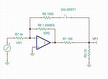

Apparently there is a gaping hole in my understanding of negative feedback! Normally when you apply voltage feedback, the output impedance will fall by the same factor as the gain reduction.

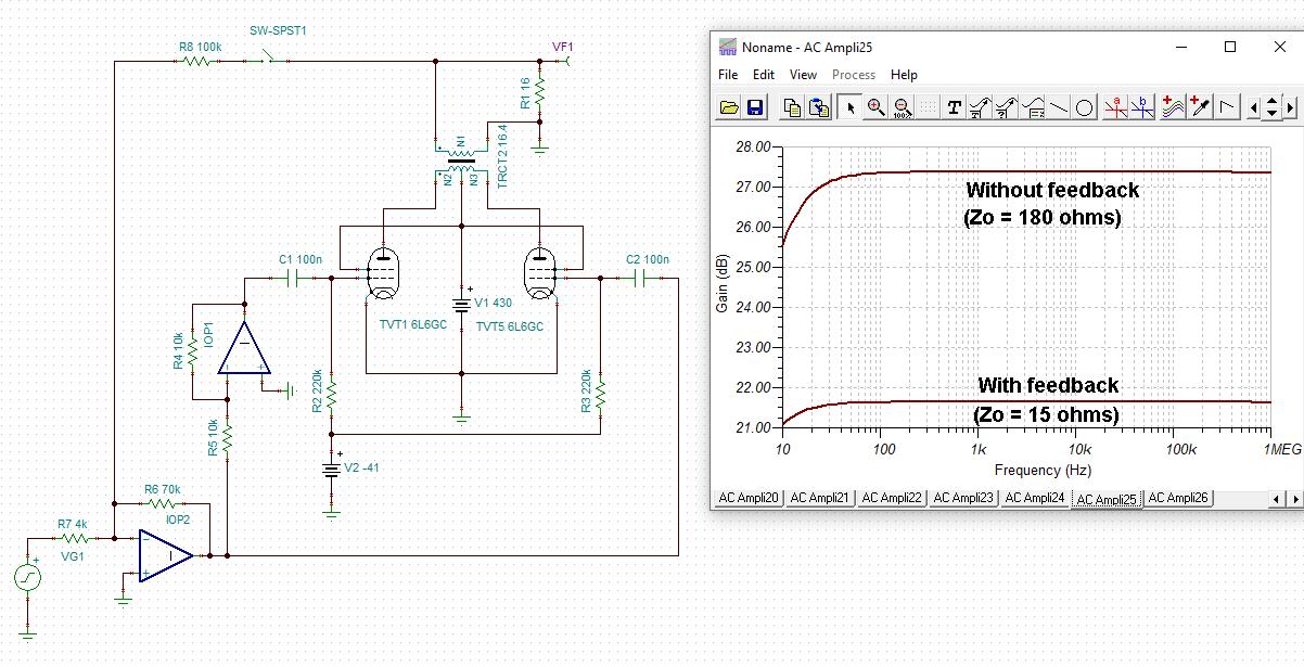

Yesterday I was testing a simple 6L6 PP amp, and measured the output impedance to be 170 ohms. Then I applied about 6dB feedback. THD fell by half as you would expect, but the output impedance fell to 16 ohms!
So I created a very simple circuit model to see if I was going mad, and sure enough I get basically the same result. What is happening here? Why is the output impedance changing by a factor of ten? I feel like I'm missing something very obvious!
Frequency response shown below, indicating 6dB of feedback. 6L6s are biased to 42mA cathode current.
The open-loop impedance only depends on the pentode's ra; and since this has no relationship to the feedback circuit, the prediction is not valid.
Going from open-loop to closed-loop, the reduction is from an unpredictable/uncontrolled value of Zo, so how can we talk about dBs (ratio) ?
However, as soon as the loop is closed, you can start talking about ratios:
If we leave the op-amp in-circuit, and increase the closed-loop gain in steps, we can expect the output impedance to behave as predicted, I suspect.
The FB ratio has never been 6 dB and it isn't voltage fb either.
The (-) input of the opamp is a virtual ground or current summing point. The opamp's output counteracts the input signal thru it's fb resistor such that the sum of both currents stays zero. Now the 100k gfb resistor injects an additional current into that node messing up the local fb around the opamp ...
OK working through the maths it turns out that output impedance drops by more than the gain reduction when the loop gain is small, as it normally is in a tube output stage.
In his book "Physik der Elektrogitarre" Prof. Manfred Zollner shows output impedance results (measured and calculated) for a few guitar amps. Also gives the formulas.
https://gitec-forum-eng.de/wp-content/uploads/2019/02/poteg-10-05-6-negative-feedback.pdf
E.g. Fender Super Reverb circuit Zo = 180 Ohm without NFB and 18 Ohm (at 8Ohm output) with NFB.
Interesting to note: The open loop gain of a tube amp (strongly) varies with the load.
The "actual" or "inner" open loop gain (without load) might be 20 times larger than with designated load.
This roughly corresponds to the ra/Za ratio (its actually a voltage divider effect).
