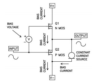

What I am trying to figure out at this stage is the rough calculation upfront such as power dissiopation and bias per device and I am still not understanding well how can XA200.5 have 400W Class A but yet dissipating only 700W!

Somehow I get the impression you do not actually know what a push-pull output stage is/does.
A standard 200W class A power amp with a bipolar complementary PP output stage has a dissipation figure in the order of 450W.
700W is actually exceptionally high.
Part 1 is due to using vertical MOSFETs, the spare 5 volts on the rail story.
Part 2 is due to balanced operation : the extra rail losses double.
In a regular output stage : on top of the max output voltage comes 1 time the 5V.
For the bridged/balanced output : max output voltage, plus 10V (5V from the positive rail, plus 5V on the negative rail)
What do you mean by "Effectively a net max class A output current of ~8.5A "
when you say negative side 4.25A and 0.75A SE bias, isn't it more like 5A negative side plus 0.75A?
A regular push-pull output stage, biased at 5A, can do 10A peak in class A before it crosses over to AB.
400W peak class A in 8 ohm is ~56.6V and 7.1A
For the output node to be at 0V at idle, total current from the positive rail has to be identical to the current flowing to the negative one.
So current times rail voltage is the same for all quadrants (identical rail voltages)
So for 700W idle dissipation, 5A per rail.
0.75A single-ended current is about 4.5W
Ergo, to negative rail : 5 minus 0.75 = 4.25A bias for the P-channels.
Problem with single-ended current through resistors in parallel with active devices : it never stops flowing, and can get only get bigger !
Suppose the amp delivers 400W peak in 8 ohm :
=> +28.3V peak at one output node
=> 63.3V across the SE resistors (28.3V + 35V rail)
=> 80% more current flowing through the SE resistors (63.3/35 times 0.75A = 1.4A)
At the verge of crossing over to class AB ;
1 - P-channel output devices as good as closed
2 - current through the SE resistors from output to negative rail is ~1.4A
3 - output current to loudspeaker is 7.1A (7.1 *7.1 *8 = 400W)
1+2+3 => Current through the N-channels has to be 7.1 + 1.4 = 8.5A
(= Part 3 of the dissipation saga)
Part 1 + Part 2 + Part3 are the reasons why the dissipation level would be 700W to deliver the 200W class A.
Part 3 is the reason why SE power is in the order of 5 watts.
The 0.75A SE bias leads to a peak dissipation of close to 100W in the SE resistors at full amp output level.
Make it 1.5A (20W SE power):
- peak dissipation of ~200W in the SE resistors
- close to 100W more idle dissipation for the entire amp channel, 800 instead of 700W
Better picture =>
(pfff, me over and out)
