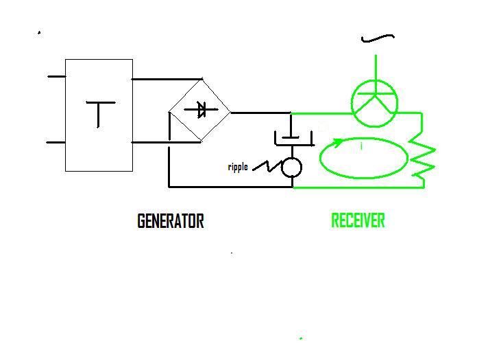

In my diagram, it is clear that the caps, used as generators, are paralleled to the load.
The load seen by these generators being: speaker in series with the output transistors.
This is why DC can pass.
And, opposite to output caps, they are in the feedback loop.
🙂 I disagree, because if they were "in parallel" then the load would also (by definition of being in parallel) also be passing all the ripple current and other varying currents flowing in those PSU caps.
Yes 🙂 which is different to saying the speaker is in parallel with the caps. The return end of the speaker is a reference point. The other end of the speaker (that goes to the amp output) is controlled by the amp under the action of feedback.
The voltage at this point is a copy of the input signal.
By definition therefore the current in the speaker (assuming a resistive load) is also a perfect image of the input signal.
The current in the PSU caps is not.

They are not in the feedback loop.
They are in the meaning the current flowing from them into the load is controlled by the feedback.
In the loop cap + load + transistor, the control by feedback of one among the three devices imposes the current into the others to be the same.
This ,combined to feedback makes ripple rejection

I draw one half only for simplicity.
The generator is a voltage source .
Seen from the receiver:
The receiver is in parallel with the generator.
Into the loop: generator +transistor + load flows one and only current.
The feedback makes this current such as the voltage across the load is a copy of the input signal. This eliminating the ripple.
The cap isn't in the feedback loop per se but the current flowing through it , which is the same as the current flowing through the load (at least seen from the receiver), is under te NFB control.
There is no problem for generating DC into the receiver, Its amount depending of the transistor conduction.
This is how i see it
