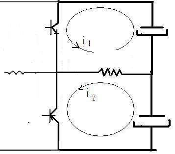

Try and follow why 🙂
Can you see that a DC coupled amp can supply a perfect squarewave all the way down to DC if required ?
You reduce the input frequency 10hz, 9 hz and so on all the way down to DC and the DC coupled amp produces a perfect output across the load.
The load current flows from the amp output to the star. Yes 🙂
If we put a 1000uf cap in series with the amplifier output and connect the load to the other end of the cap the amp now does not reproduce a perfect squarewave across the load as frequency goes down. Do you follow that ? That is because that cap is in series with the load.
If the PSU caps were similarly "in series" with the load a similar effect would be seen. The output would not go down to DC.
If you don't agree say so 🙂
What about the transformer as a path for DC. Well you can run the amp from the caps for a few moments by disconnecting the transformer... so it's not flowing there.
Yes, you demonstrate in an unquestionable way the impossibility.
Which made me look more deeply to the thing...
Now i am ashamed of having been so stubborn.
Simply looking at the way output and psu are connected, it is evident caps are not serial connected to the load. They are used as generators feeding the load through variable resistors (the output transistors).This, in a bridge arrangement
I have to apologise to everyone here for the time consuming.
Thank you very much, Mooly, to have been so patient.

Yes, this is how I see it, both on paper and in my sims - the way in which the signal flows through the output caps.
The generator doesn't care this flow as long as it is a generator.
The bigger the cap/transfo the stiffer is the generator.

I agree, the PSU doesn't care.
But what I was trying to say a few pages back is that the signal does flow through the PSU capacitors, so I would expect that this would have some impact on the sound ?

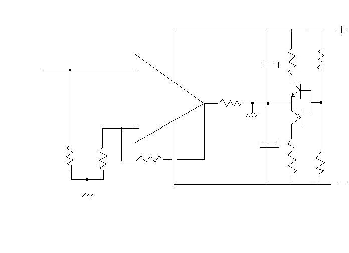

what's so hard about making the function/circuit position distinction and applying some #
psu Cap errors are divided by the amplifier circuit psrr - which can be really big - >120 dB at low frequencies - a good thing since we usually have 120 Hz rectifier ripple of several V - successful audio amps do not have audible ps ripple noise in their outputs - can't you see that "errors" caused by load current flowing in the ps C is in exactly the same place in the circuit and is attenuated by the same big number?
output DC blocking C is outside of the feedback loop and forms a high pass filter/impedance divider with the load = only the ~Zc/Zload attenuation of load current caused error of the output DC blocking C impedance nonlinearity
in high psrr circuits ps C can literally have Millions of times less effect on the audio signal - despite any sloppy heuristics claiming they "are in the signal path"
"load current loop" is not the same as "signal path" - yes there is a "signal" = errror V on the ps Caps due to the load current - but we're not listening to it - its not the "audio signal" which == difference V across the loudspeaker terminals

The AC current flow through the load depends on the impedance of the all items that it flows through, each one of them contributing something. The diagram posted earlier showing the AC current flow (in a kind of bridge mode) illustrates this well.
The output devices contribute by varying the current that flows through them in accordance with the input signal, the psu capacitors hopefully do nothing to affect the AC current, but any distortion they do create must therefore affect the AC current flowing through the load.
I'm starting to see that the feedback of the amplifier acts to minimize this impact of the PSU caps on the overall sound because the feedback measures the voltage across the load (without the PSU caps) and the error amplifier compares this with the input signal. It seems that it is the feedback factor that is important. I don't see a role for PSRR here except that it is directly improved by feedback.

I beg to disagree that the power supply caps are NOT in series with the loudspeaker and don't impart their limitations on the overall sound. The reason for this confusion is the definition of GROUND. You see, ground in an amp or preamp, is really NOT the Earth, but something completely artificial and just called 'ground'. No one can insist that 'ground' is always perfect, in fact, at low and high frequencies, it is usually kind of lousy. Do a little thinking about it and you will see this. Now, for some reason, people here are talking about using output caps in series with a loudspeaker and using a single power supply to power the amp like the Dyna ST120 and the Quad. Many British designers stayed with it, long past its time, but the rest of us saw the ADVANTAGE of taking the output cap and putting it in the power supply, making a +/- supply. Then the 2 caps are in PARALLEL and do double duty, as the low Z series pass for the loudspeaker, and filtering the power supply ripple. This did not come, overnight, and many of us had to think about it for awhile, but we rarely looked back once we switched over to dual supplies. In either case the power supply caps are still significant as the return current from the loudspeaker flows through them.

No, because in an output cap the signal flows through it, PSU caps it does not and it also has the amp PSRR making the effect even smaller.
Exactly! 🙂 Good post.
What distortion do the PSU caps produce? There is no signal flowing through them. Cap voltage does not really affect the AC current flowing through the load because the amps PSRR applies a massive load of ripple reduction.
