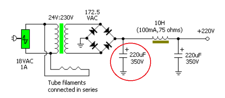

The B+ power supply is on a separate board, but the 6v is on the same board, but it is on one side of the board. The exact schematic is attached:
Yes I have too separate transformers. How do I tell if they are in the same phase. Also, I don't know if it makes any difference but the B+ is a toroidal transformer while the filament transformer is a standard transformer. I did this because the current for the heaters for this amp totals 3 Amps.
In the Headwize schematic the 6as7 filament is connected to ground trough the middle of a variable resistor, nulling the current modulation in the amplifier ground, try doing the same. Otherwise you can leave the filament ground floating and connect it to the amplifier ground with a 0.1uF film capacitor.
If I am understanding your post, you have both the raw heater supply and the the heater regulator grounded. There should only be one connection to ground and my understanding of best practice is that it should be at the output of the regulator.
