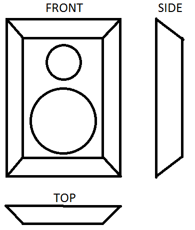

Well, we were thinking about making simpel rectangular boxes and mount them with U-brackets against the wall. This way we can mount them high and aim them down a bit, so the path lengths become longer, reducing the path length differences and reducing the difference between the listening angles when sitting/standing at different spots of the bbq-spot.
Speaker enclosures that have smooth transitions to the wall would require them to be taller and wider and would propably look weird.
You do mean something like this, don't you?
(not to scale)
(not to scale)

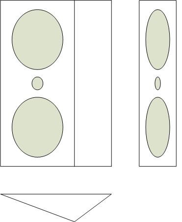

Another idea:
would it be possible to hide the subs? That way, you could use a potentially larger cabinet, expanding choices to 8" woofers (better efficiency etc available). You'd need a 4" FR driver to get to 100Hz comfortably, but I figure this idea would give more flexibility...
That might be a possibility, but if we'd choose to use (a) seperate subwoofer(s), we'd do this in the future and now build a pair of speakers that can play well (but without the bass-extention) on their own.
If we'd choose this route, the budget goes down: For about 200 Euros, we can buy a pair of ready made out-door speakers, so we wanted to build our own outdoor speakers for the same budget, but with better bass extention, if better bass extension isn't possible, we want to be done for a lower amount of money.
If we'd go the "no sub-bass" route, I was thinking about the TangBand W6-623C as a woofer, still combined with the Vifa fullranger.
It would make more sense to choose a smaller fullranger or even a tweeter, but that doesn't make sense if this is more expensive than the Vifa.
This way, it's possible to cross at the baffle-step frequency, since the 623 can easily play up to a few kHz and the Vifa can play easily down to 200Hz, so there's a very wide range to choose a crossoverpoint within...
Isabelle

A few points :
Mounting them high outside will take away the bass boost effect
you would get with a floorstander with a low mounted bass unit.
TangBand W6-623C
It is a better choice due to the sensitivity.
At it is the 30L Vas, Fs 46Hz implies a lightweight cone.
It really needs around 10L sealed not the 5L you are planning.
Using it and mounting it high would be really giving up on any bass.
TBH its a bass/mid much more than a bass unit.
The TB 6x9 sub has the same Vas, lower Fs, lower Q but with
less sensitivity. It will work into the same volumes as the above.
Larger cone area and nearly double the excursion capability it
not to be sneezed in my book.
Its bass power handling is far superior to the above.
If the point is to make a reasonable attempt at reggae or house
music outside, you should use all the acoustics advantages you
can to maximise the bass levels, they will quickly die away as
you move away from the speakers due to being outside.
Floor/wall corner loading of the bass unit should be considered.
All the design indicators point to shallow near wall floorstander
with a low mounted bass unit, vifa optimally placed near the
top, c/o still around what would be the baffle width frequency.
A stone base should help getting it near the wall. It does not
have to be a floorstander, it could be tall and mounted on
the wall, as long as the bottom bass unit is near the floor.
rgds, sreten.

Okay...
Different approach: floorstanders that aren't wider and deeper than the speakers we were planning to build, but a lot taller (so the fullrangers are somewhere between the sitting-down and standing-up ear-level).
This way, we can create a lot more volume for the woofers ànd for the fullrangers.
By the way: I discovered the amp we are planning to buy isn't 85W RMS per channel at 4 ohms, but at 8 ohms and 100W RMS per channel at 6ohms. It is 4ohms stable, but then it'll probably give "only" the same 100W RMS as it does at 6ohms, so maybe the 1139 might become possible?
Isabelle
Isabelle
The issue with the 1139 is how much you have to slug the midrange,
and in doing that to get the drive to the 1139 the midrange will clip.
Most of the power is in the bass, for your amplifier you want a 8 ohm unit.
Level control on the Vifa should be a series resistor rather than an L-pad.
A triangular section in the top is the easiest way to enclose it. Series
should still work well with with a 2:1 driver impedance ratio though
the details are subtlely different.
If the speakers are going to be very close to walls then the wider and
less deep you make them the less the midrange cancellation issues,
and the lower the c/o frequency that works well will be, for other
reasons depth = width is not a good idea anyway.
As its not a 4 ohm amplifier the twin 8 ohm driver concept is not so good.
The TB 6x9 8ohm seems to fit the bill and it needs around 10L stuffed.
It will need the silicone spray treatment I assume.
I'd say your looking at 3L or so for the vifa and a total internal of say 13L.
rgds, sreten.
