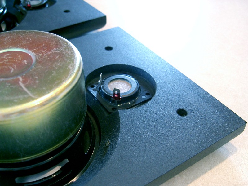

Well two of these per cabinet, in parallel :
830656 - Peerless SDS-134-THP 5.5 inch woofer coated paper - Europe Audio
Being coated they should be effectively sealed, from the front at least.
Model fairly well for a well stuffed sealed cabinet around 8.5L, they will
give you a Q around 0.85 to 0.9. Bass will roll off fairly early but you
cannot argue with the laws of physics. They are good value drivers.
Sensistivity is not quite enough for full baffle step but they still will be
a lot better than a single driver of the same sensistivity as the Vifa.
Experimenting with say 0.5R to 1R in series with the Vifa may be
worthwhile if you are particular about a nice overall balance.
The larger 6.5* drivers are also good value but you'd need bigger
cabinets for two of these, around twice the internal volume.
A series 1st order crossover should work a lot better that 1st parellel.
Are remarkably good as supertweeters for FR drivers.
Tip : build your cabinets with a triangular section from the top back
corner to just below the Vifa, forming a triangular cavity for it.
