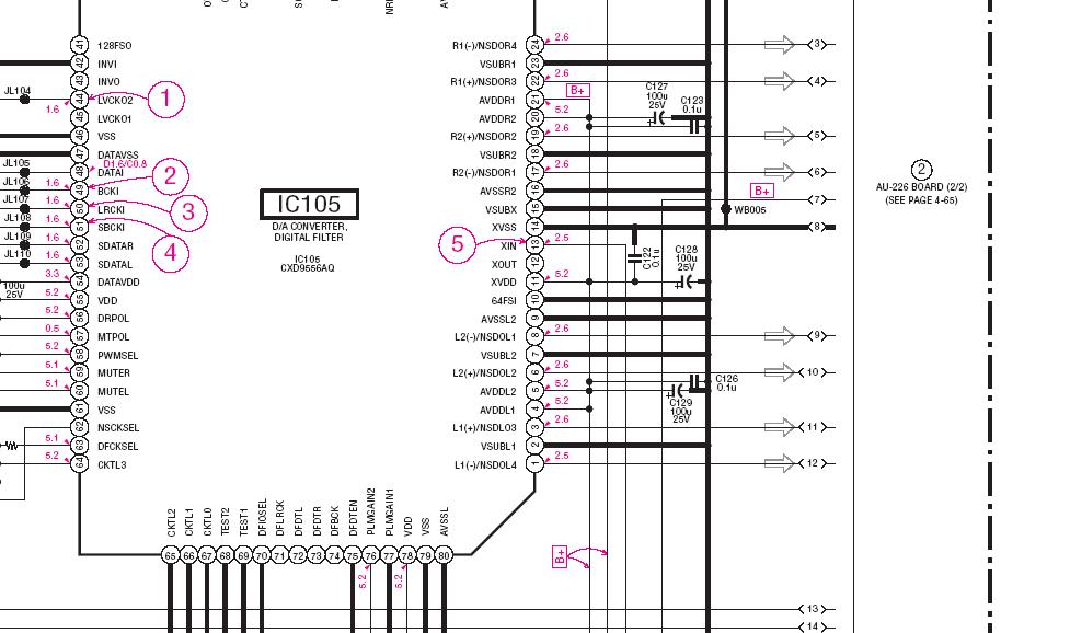

I have read Christer's outpicking thread of the VC24+ and Mr. Perez's circuit modifications with great interest. But is there a discrepancy between the two? The outpicking diagram (which illustrates the junction between the DAC and the Current Pulse IC's) shows two tied in pairs.
The first pair: Pin 28 and Pin 25 off the Pulse chip input are tied after the resistors.
The 2nd pair: Pin 27 and Pin 24 are tied after the resistors.
This corresponds to tieing R2(-) and R1(+) together, and R2(+) and R1(-) as another pair.
This illustration (http://www.diyaudio.com/forums/attachment.php?s=&postid=255161) differs from the assignment of inputs in Richard's schematics where it is indicated that R1(-) and R1(+) are tied through resistors, and R2(-) and R2(+) are also tied; making the second half of the input.
My question is, which version is correct? Using the Sony service manual, this indicates, for example R1(-) and R1(+) are on pins 24 and 25 of the Current Pulse input.
Any thoughts or comments would be appreciated!
